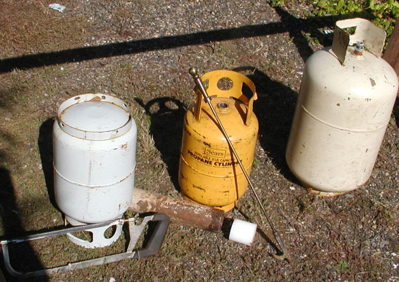

I am starting to get a collection of obsolete propane tanks that can not be legally refilled due to the new regulations on the OPD valves and triangle handles. POL valves are obsolete. The cost of changing the valve and getting a new certification is more than the cost of a new tank. ($30 valve installed + $20 for recertification) A $29.95 tank is cheaper.
I have been wanting a 3 inch valve, but the cost of the materials has been a limiting factor. I do have a piece of 2.5 inch UMHWPE on hand as well as some decent but rusty 2.5 inch pipe, so I am starting on a 2.5 inch valve in a 11 LB propane cylinder as a starting project. The large tank is reserved for the 3 inch QDV. I have a second one that will eventually become a 4 inch.
I have started by gathering supplies and cutting the pipe and tank. As I progress, I'll add to this thread. Enjoy. Comments are welcome. So far all the materials except the tools was obtained FREE.

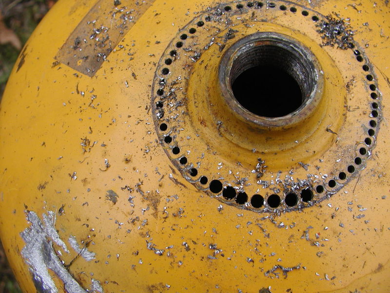

Detail showing the area to be welded.  I cut the holes smaller and beat them in to create a space for the weld.  The bevel reduces the possibility of an explosive weld failure causing a tank rupture.

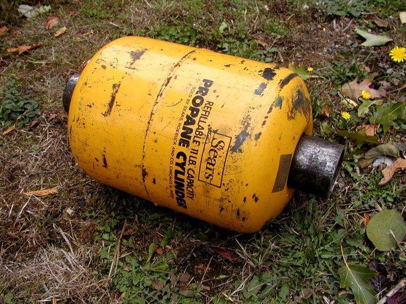

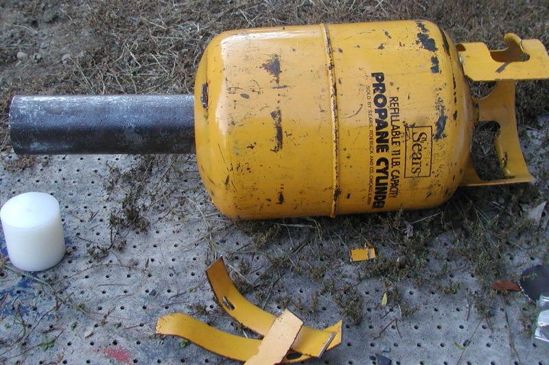

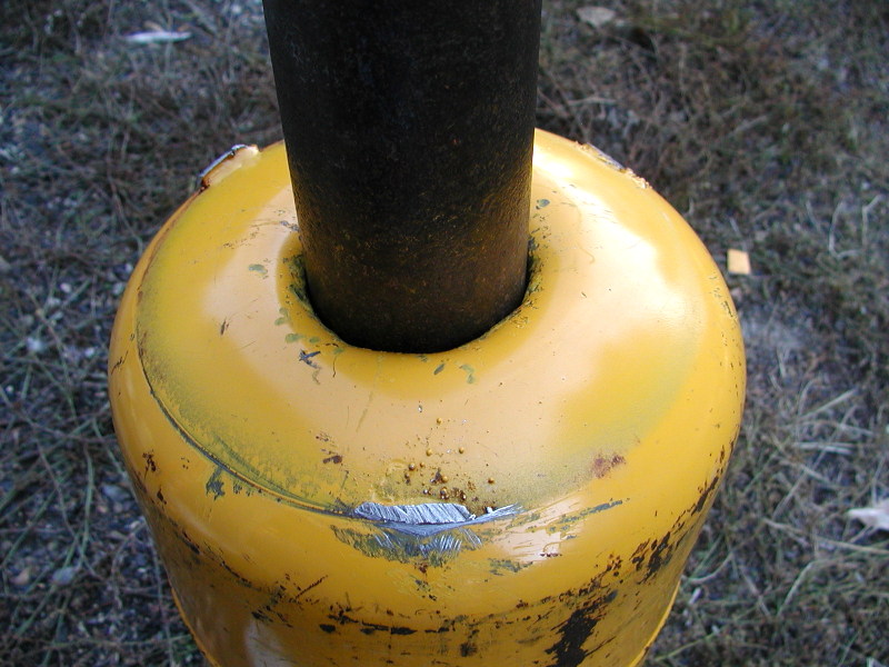

The tank modification has begun.  The bottom ring is cut off and the pipe is test fit into the hole.
The pipe, the fireplace poker and the 2.5 inch pipe will become the core of the valve in this QDV launcher.
Raw materials, tanks, piston, fireplace poker and pipe.  Pipe is cut to length for the yellow tank.

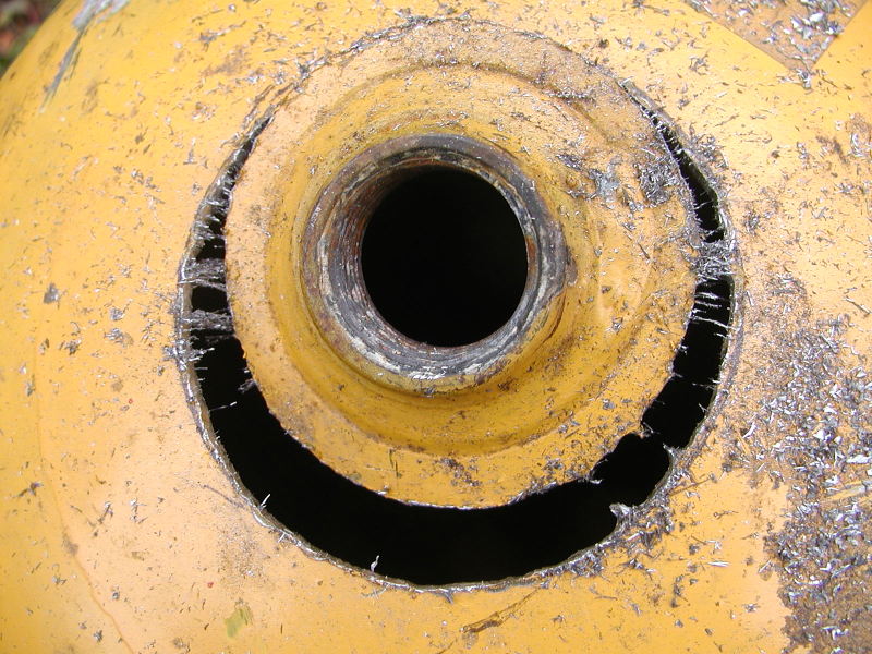

I made some progress today. The items done today were the removal of the handle from the top of the tank and cutting the top so the tank is ready for welding.
If you wish to repeat this process, the steps are;
Cut off the handle with a hacksaw. Grind smooth.
Draw a circle the OD of the pipe
Make a ring of center punches inside the circle
Drill the ring of punches.
Enlarge the holes
Remove material between the holes
Trim and bevel until the pipe fits.
The bevel and enlarging of the hole to size is done with a ball peen hammer.

Fit test is OK.
Fit test is OK.
Open says me
Open says me
Joining the holes
Joining the holes
Enlarge the holes
Enlarge the holes

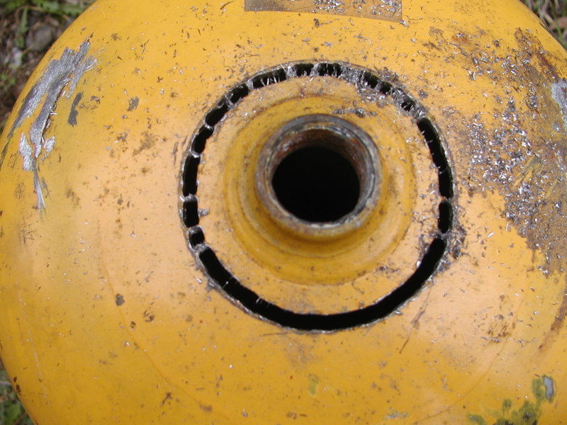

Drill the ring of holes
Centerpunched ring
Centerpunched ring

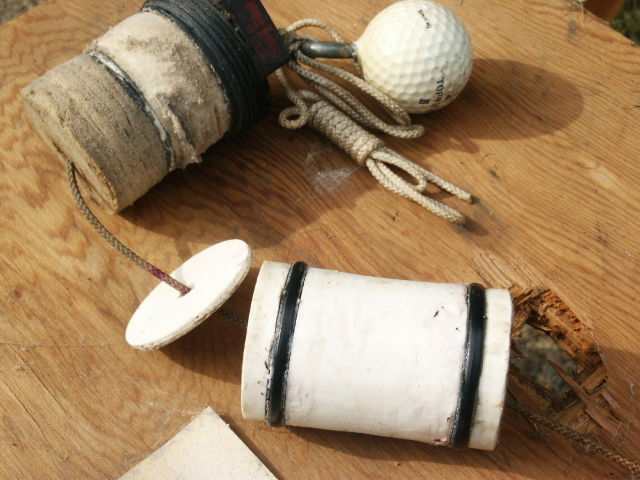

I can't wait to see this thing in action! I do have some advice though. When I built my 2.5" QDV tennis ball launcher, (4" PVC chamber coaxial never posted because trigger handle broke) I found that materials such as solid plastic had too much inertia and blew the back out of the cannon on the second launch. I instead used 2" PVC pipe and plugged both ends to make a much lighter piston. As for o-rings, 2" PVC Unions (both sch40 and 80) have o-rings that fit perfectly in 2.5" sch40 PVC pipe. With this piston, it sealed well, actuated faster, and didn't give you a massive jolt when fired. Good Luck!
auxiliary wrote:I can't wait to see this thing in action! I do have some advice though. When I built my 2.5" QDV tennis ball launcher, (4" PVC chamber coaxial never posted because trigger handle broke) I found that materials such as solid plastic had too much inertia and blew the back out of the cannon on the second launch. I instead used 2" PVC pipe and plugged both ends to make a much lighter piston. As for o-rings, 2" PVC Unions (both sch40 and 80) have o-rings that fit perfectly in 2.5" sch40 PVC pipe. With this piston, it sealed well, actuated faster, and didn't give you a massive jolt when fired. Good Luck!
My first QDV the apple cannon does have a PVC piston. (See my ABS Test Cannon) I have built several PVC piston cannons and they all fatigue pistons. The piston has a finite service life. This is the primary reason I have moved away from PVC except for barrels. The apple cannon is the only cannon I own that hasn't broken a PVC piston yet.
As far as weight, it has been a non issue with HDPE. The only "Massive jolt" I get is recoil with launching high mass projectiles in the larger diameter barrels. A large Gatoraid about knocks people on their butt.
HDPE has held up well to extensive testing at high pressure and heavy field testing. My 2 inch cannon has a spare piston if I need it, but I haven't needed it. The same is true for the Marshmallow cannon. I use the spare piston as a show and tell item. It is the piston I show the floating o rings on in my using o rings youtube video.
For recoil control of the piston, a substantial bumper is used along with a crushable piston stop that is regularly examined for damage. In the Marshmallow Cannon this is PVC due to the small 1 inch piston. In the T shirt cannon this is ABS. So far I have had no measurable damage to the piston stops in either. The foam pad in the Marshmallow cannon is showing extensive crushing. Part of the new build will be to test a new bumper to handle the higher mass piston on higher pressure.
A typical PVC failure is a fatigue crack.  This is the 4th piston the Mouse Musket broke.  This crack is not in a high impact area.  Over time with repeated stress, PVC cracks.
ABS test cannon PVC piston.  My only PVC piston that hasn't broken.
Last edited by Technician1002 on Sun May 30, 2010 11:53 pm, edited 1 time in total.

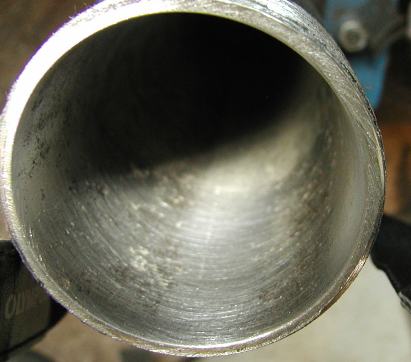

I've been sanding like crazy. The way I sanded it is to use self stick sanding pads and stick one edge onto a 2 inch ABS pipe. I stuffed paper towels under the flap to provide pressure. Then it was several sessions of getting a workout. First came off a layer of rust. Then I started to cut through the black pipe finish in the area of the seam. Now I'm starting to wear through the black finish down to steel all the way around and the full length. A couple more days sanding to sand down the seam and remove all the black finish is the goal before cutting ports.

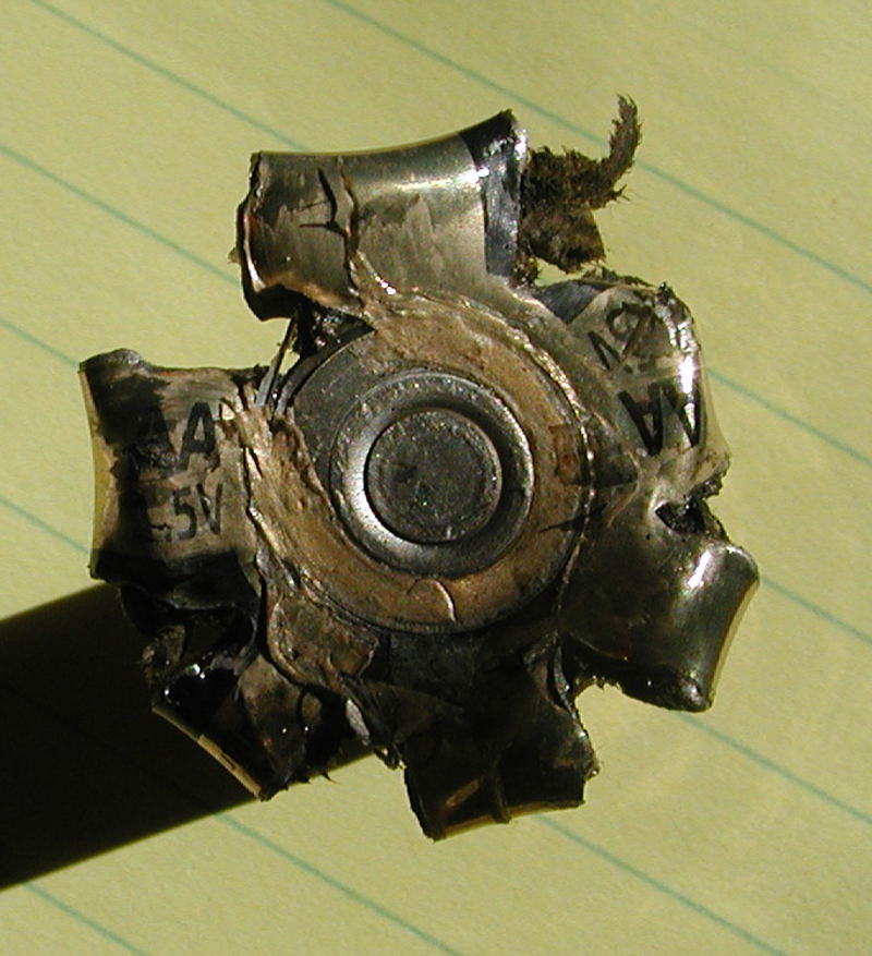

I decided to test those camera batteries that went into low batt wink mode on my camera while shooting a golfball target shot. I tested them and the strength of my 2.5 inch valve material. The valve held up with nary a mark. The batteries didn't fare so well. Test conditions are point blank range, 1/2 inch conduit barrel 7 feet long on the Marshmallow cannon at 100 PSI.
Top view of a short AA battery.
Various AA battery impact tests.  The pipe didn't dent at all.<br /><br />Truth be told, I tested on a scrap piece of pipe.  I didn't risk damaging the valve.

Sanding the inside of the valve.  This is lots of work.

You figured right. I moved to a power drill to drive the sanding process. Due to the large amount of scale and black pipe surface, I switched to 80 grit for the bulk sanding. I found a drywall sanding screen works well, but wears out quickly. This is much larger than the sanding job on the 2 inch or the Marshmallow cannon.

The pipe seam after a bunch of sanding is looking a lot better.
For comparison, this is how the pipe looks when I started.
Test fit of the o ring and the amount of sanding left to remove the black pipe surface and the pipe seam.  It has threads now!

The entire length is sanded. More attention is given to the area the rings will seat. Due to the design and a planned piston stop to prevent the piston from launching, the piston will have to be serviced out the breech like the marshmallow cannon. Due to that, there can't be any high spots in the pipe. They are all sanded off. This is one of the reasons this valve is taking longer. The pipe is in worse shape to start with. I picked it because the seam is not in a deep valley like some I was considering. It's easier to sand off peaks then it is to fill in a valley. Some pipe has a terrible seam. Either a tall ridge or deep valley. I decided to deal with some rust pitting instead of a bad seam.
