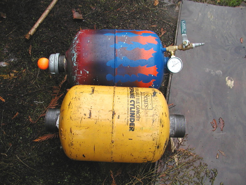

Size comparison with my 2 inch 3 gallon.

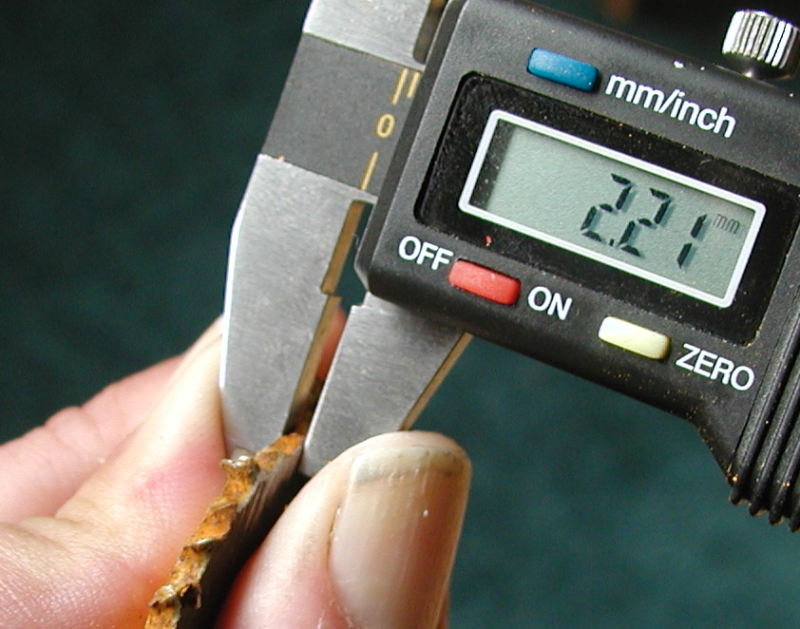

It's cold and wet today. I'll probably wait for nice weather to get good photos to mark up. I'm planning on cutting the ports tomorrow or Saturday. If I do, I'll be sure to get good photos to mark up. I have a benefit of the way I cut the tank. I can easily measure the tank thickness.
Edit; Nice halloween math class.. I wish I had this guy as my math teacher. He's fantastic.

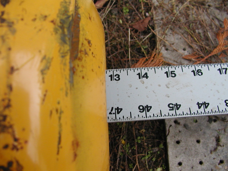

Tank thickness can be measured from the edge of this piece.

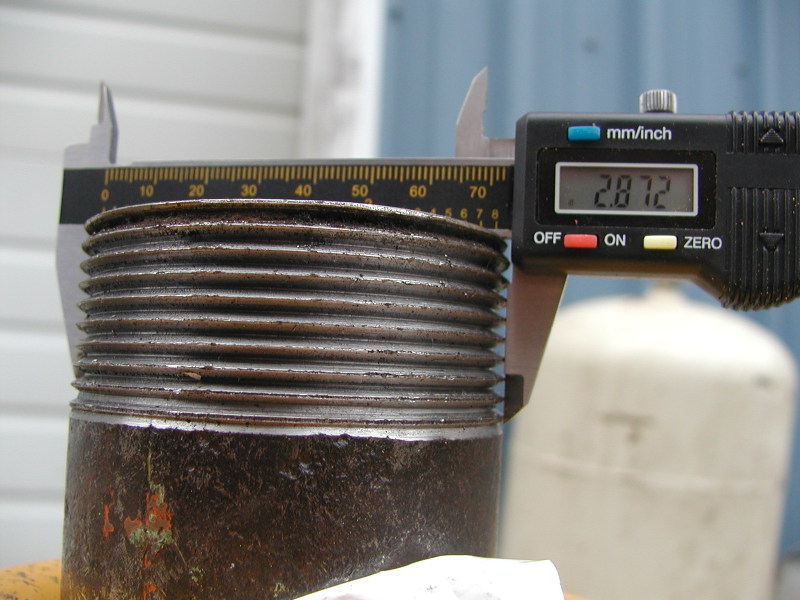

OD of the pipe is about 2.872.  My calipers didn't quite reach from the side or end.  I'll remove paint off the other piece and measure it later.

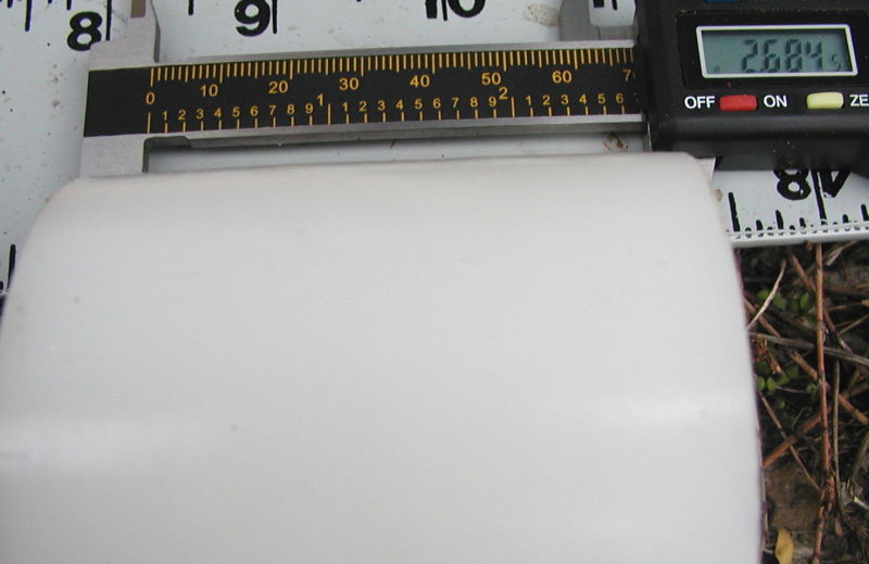

Piston is 2.684 inches long.  I get to turn it down this weekend on a lathe.  No need to measure the current diameter.  It's too big.

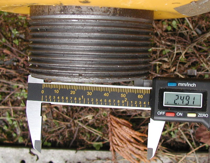

ID of the polished pipe is 2.491 inches.

Thickness of the bottom of the tank. 2.21 mm

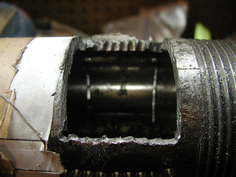

Port cutting is finished.  A little de burring and edge rounding will finish the job.

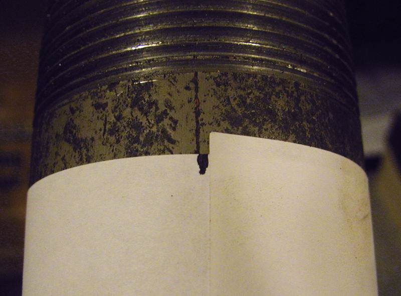

The other sides are marked with a hacksaw.
Pattern transfered by drilling the lengthwise cuts.
Divided into thirds by folding.
Distance is measured with a piece of paper.
