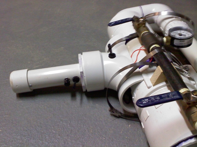

I made this under-over advanced combustion cannon with a friend last summer. It performs very well with an HGDT estimated muzzle velocity of over 500 ft/s with a 70g projectile. It's got quite a kick. The only drawback to the gun is its heaviness. The fuel and metering system strapped on board adds a considerable amount of weight. The gun is triggered by an electric grill igniter housed in the back handle. Sorry I don't have any pictures of the interior of the chamber. I'll upload them as soon as I get a chance.

  • *Barrel length: 72 in
    *Barrel diameter: 1.5 in
    *Chamber volume: 180 in<sup>3</sup>
    *C:B Ratio: 1.5
    *Fuel: Propane
Features
  • *4-gap spark strip
    *Breach loading barrel
    *On-board fuel meter
    *Push button trigger
    *12v chamber fan controlled by toggle switch
    *Toggle switch safety mechanism
The whole thing (with the propane tank detached -- for now)
Chamber and trigger assembly

Niiiice. I'm a fan of combustion guns, not that I have a problem with pneumatic's though. You have a good looking gun, and I like the chamber vent through the front grip. As far as the heaviness goes, have you thought about using pvc for the meter pipe? That would lighten things up considerably. Or maybe use a cartridge type propane injection like Starman uses on Triple Thunder.

Is the inner diameter of the barrel really just 1.5 inch (3,8cm)!? Or did you mean the radius? When I look up 1.5inch on the folding rule, I can't image that any potato or apple or whatever would fit anywhere near. And your barrel looks much bigger than 1.5inch in your video.

The only suggestion I have (which is moot, now) would be to drill your electrodes under the saddle tees to hide the wiring.

It's diameter. You can expect thgat it'll be slightly larger as PVC pipes have the "pipe size" and then the "average size".
The average ID of 1.5" PVC pipe is 1.592"
