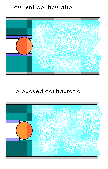

Back to the subject of this thread, finally got some velocity data with the long 6mm barrel, not as dramatic an increase as I expected but impressive nonetheless:
0.22" 16 grain pellet (flared out to fit barrel) - 1049 fps - 39.1 ft/lbs
0.25g airsoft BB - 1096 fps - 10.3 ft/lbs
0.12g airsoft BB - 1179 fps - 5.7 ft/lbs
As to the cartridges, while the mini works, I'm still not willing to let go of the potential benefits of having a friction seal instead of a burst disk.
Perhaps having the BB already in the seal on pressurising is a bad idea, and I should change the configuration, maybe with an o-ring instead of a tubular seal.

- cartsealconfig.GIF (8.13 KiB) Viewed 3599 times

what were the mixes that you were using?jackssmirkingrevenge wrote:Back to the subject of this thread, finally got some velocity data with the long 6mm barrel, not as dramatic an increase as I expected but impressive nonetheless:
personally i think it is more trouble then it is worth because it is going to be really fiddly to get it right, on just one then you have to make more, also with the friction and heat i would think there would be a lot of wear so the power would slowly decrease and fixing it would be a painjackssmirkingrevenge wrote:As to the cartridges, while the mini works, I'm still not willing to let go of the potential benefits of having a friction seal instead of a burst disk.
Well, it works - but there's a certain je ne sais quoi about pulling back the bolt and seeing the extractor kick out the cartridgeilovefire wrote:yea, is there something wrong with "just tipping it out"?![]()
All done at 14x
Ne'er a truer word spoken, but I want to make sure I've milked the idea before putting it aside. In that regard, I've just come back from the hardware store with my weekly (:roll:) supply of Araldite and $5 worth of o-rings in various sizedpersonally i think it is more trouble then it is worth because it is going to be really fiddly to get it right, on just one then you have to make more, also with the friction and heat i would think there would be a lot of wear so the power would slowly decrease and fixing it would be a pain
