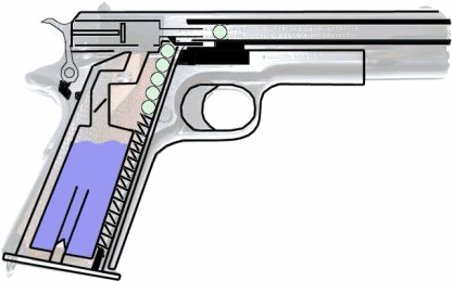

Look at lozz08's earlier project, made with some custom parts it could be made to fit in a compact pistol sized package.MrDinoRAWR wrote:The auto idea would more suit maybe a machine gun or something, maybe not a pistol as much. Lozz08, what are you talking about with making refillable mags? If you have good idea's on the construction of them could you lend me the thought, please.
An airsoft mag usually looks like this.
The green is liquid propane. A hammer hits the purple button, which opens the valve (yellow) for a shot. You could use a schrader where the yellow is. You could fill the chamber to say 400 psi with a shock pump.
When you insert the mag, the schrader goes into an o ring. The chamber can now be vented by a blow gun.
Or you could just have an onboard chamber like i did.
