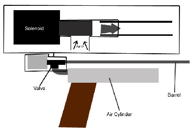

Here is a new design that I came up with for a small calibre semi auto pistol. The tank would be filled with either liquid propane or high pressure air. The solenoid would open for a split second allowing only a tiny amount of gas to pass through and hopefully allow for multiple shots.
Any ideas for magazines? Also has this sort of valve been done before?

That is vaguely the same principle as the one used by the Daystate Mk.3 that uses a solenoid to strike a hammer valve open. It looks like it would work well provided your solenoid is strong enough.

Looks good, were you planning to shoot BBs with it?

I was either going to shoot 6mm bb's or .22 air gun pellets.

I made a prototype today and it works apart from some sealing issues.
ie. It leaks alot but the valve obviously works.
I'll hopefully get round to fixing it up in the next few days.

For the valve I used a modified direct acting 3/4" sprinkler valve, I took out the diaphragm and made it so the solenoid armature opens/closes the barrel like the diagram.
