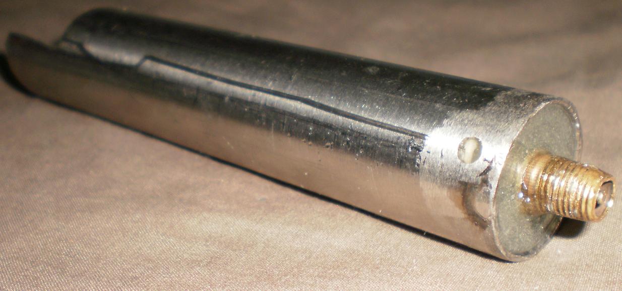

i started to make one like the pic jsr posted, but im going to use a leaver to hold it back. more like the real thing. should have pics later today.
- Crna Legija
- First Sergeant 2
- Posts: 2333
- Location: australia
its been awhile hope you dont mine the double post but i have new pics, still need to make the leaver/trigger but it should be done later today.
- thats the hole thing its 25 cm long like that. the blade part weighs a hefty 89 grams
- all.jpg (21.25 KiB) Viewed 4188 times

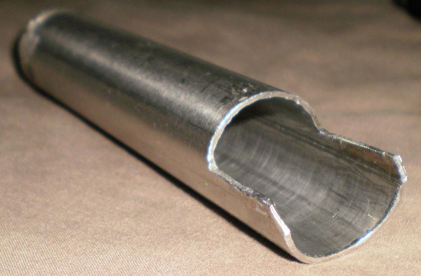

- the pipe and blade side, i got some really crap epoxy took like 3hr to get hard enough to touch without recking it.
- blade+rod.jpg (23.24 KiB) Viewed 4188 times

So pretty much the QD propels the knife forward, and the little discharge of air boosts it? Am I correct on that? If so, I think I know what I am gonna be spending $10 on!

EDIT: PS, Crna Legija, how do you cut your o-ring grooves? I've been using a miter saw followed by needle files to cut mine, but it's a little hit and miss.

yep that itwarhead052 wrote:So pretty much the QD propels the knife forward, and the little discharge of air boosts it? Am I correct on that? If so, I think I know what I am gonna be spending $10 on!
i put a peace of all thread in the pipe and tighten two nuts on ether side. then put in the drill press and used a round fill to make the cut.

This is fairly normal, in general the longer epoxy takes to cure, the stronger the result. I usually allow 24 hours for my marine epoxy to cure, depending on ambient temperature.i got some really crap epoxy took like 3hr to get hard enough to touch without wrecking it.
