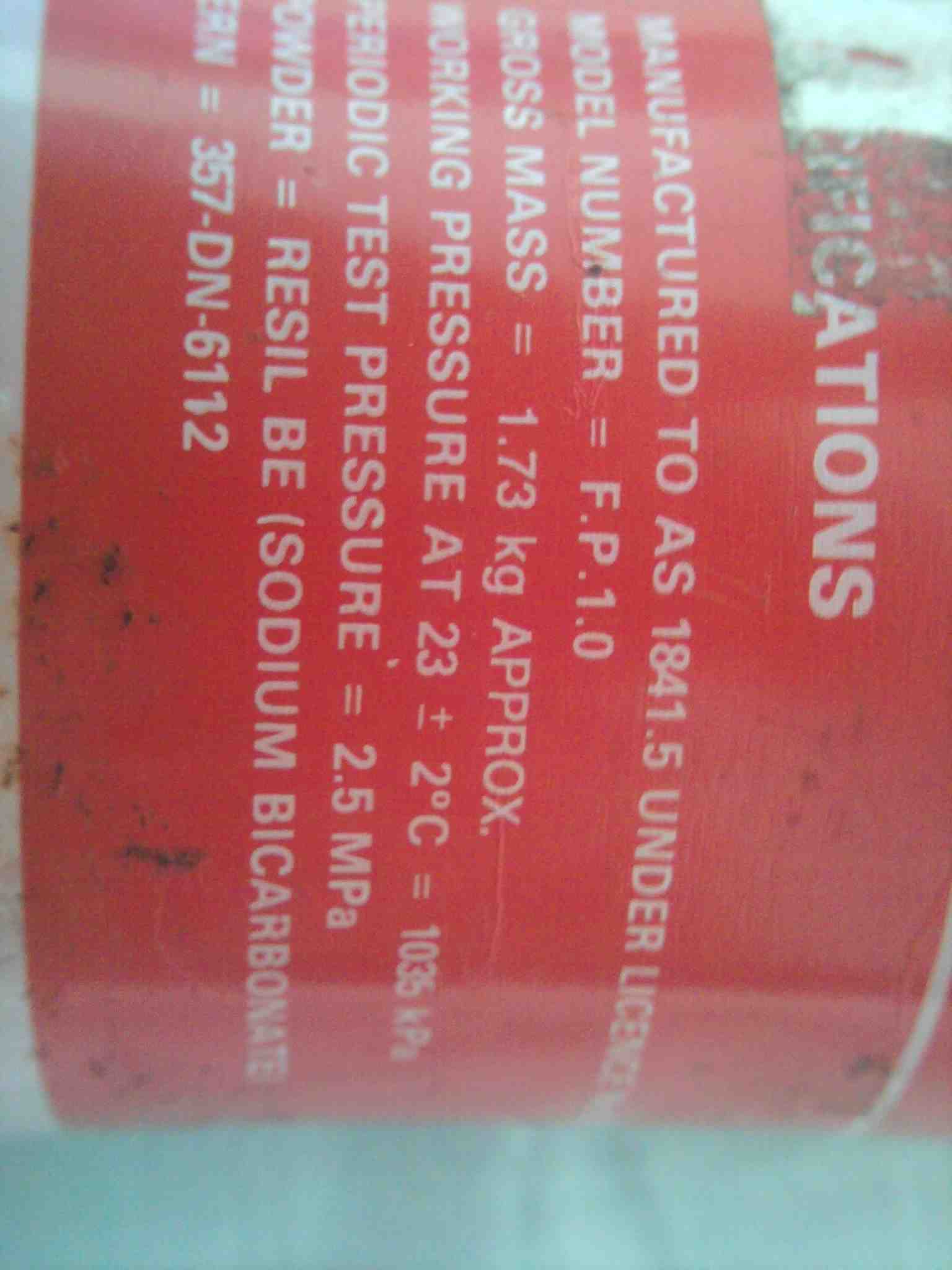

i have a steel fire extinguisher that has written on it that is has been tested to 2.5mpa (362psi), would it be safe to take it to that or similar pressure on a regular basis? how much would be a safe pressure to use it at? i had a look inside and it only has surface rust and very little at that so its still in pretty good condition

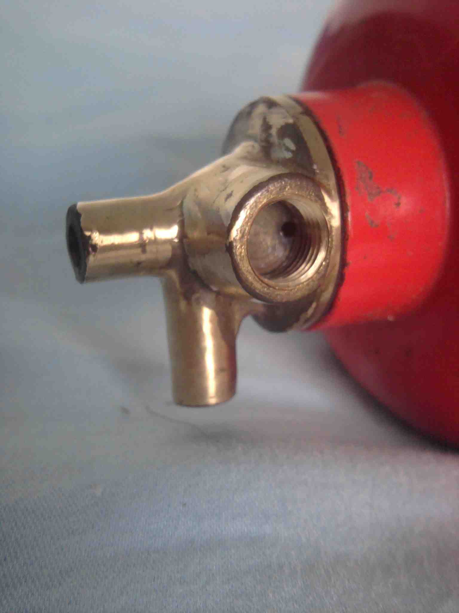

ah ok yea i didn't know the capitals mattered, but yes is it MPa not mPa, as for sittings i have cut down the old valve a bit and there is a thread where the pressure gauge was and it fits the nosily from a blow gun so maybe i could use that to attach a hose to like you do with a fridge compressor. flow isnt much of a concern to me because i am only thinking of making a semi in ether 5 or 8mm, anyways here are some pics

Wow, your lucky to have found a FE with pre made threads like that. I would be lucky to find one with a metal valve, even though I have one I would like some more....

If you can attach something to those fittings, that would be amazing.
ilovefire
Posts: 511
do you mean amazing as in really really hard?

2.5MPa is the listed as the "periodic test pressure"... this is a proof pressure, not a working pressure.
The label also states the working pressure to be 1036KPa @ 23C +/- 2C.
Where's the confusion?

Gippeto wrote:2.5MPa is the listed as the "periodic test pressure"... this is a proof pressure, not a working pressure.
that is all clear, the main question was if it would be safe to take it to the periodic test pressure regularly, or would i have to keep it to the working pressure?

I didn't realize that was proof pressure. I would recommend against measuring the wall thickness and calculating the failure pressure, then testing to that because the walls at the neck are generally much thicker than further down the bottle.

It would be amazing if you could use the connections already on the extinguisher.
