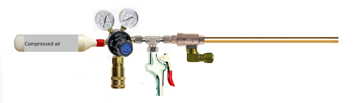

Would this work?

a regulator, why haven't you seen one before?Alster370 wrote:What is the thing with the knob and gauges?
it might, but two issues I see are you dont block of air from the pilot so when you pulll the blowgun you let air out of your main chamber as well as the pilot, a three way valve would be much better suited. Also on some of the regulators I have seen the bottom port is on the low side so you wouldnt be able to fill the large tank, you would need a T fitting before the regulator.

im going to hook up a fridge compressor to it and the tank is small, and mr. crowley how will i trigger it if there isnt a trigger?jor2daje wrote:it might, but two issues I see are you dont block of air from the pilot so when you pulll the blowgun you let air out of your main chamber as well as the pilot, a three way valve would be much better suited. Also on some of the regulators I have seen the bottom port is on the low side so you wouldnt be able to fill the large tank, you would need a T fitting before the regulator.

Goats spudz wrote:mr. crowley how will i trigger it if there isnt a trigger?
Google search

Ok thanks! i wasn't quite sure! lol
