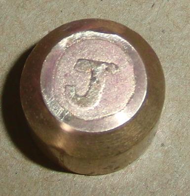

Some etching experiments, using concentrated nitric acid on one piece and the hydrochloric/peroxide mix recommended in jake's link. In both cases I used nail polish (from my own personal collection, naturally
) to mask the design.
Unsurprisingly the nitric went much quicker and bit deeper. I don't have the chemicals required to black it but used some ink and gave them a light polish, really happy with the effect
) to mask the design.Unsurprisingly the nitric went much quicker and bit deeper. I don't have the chemicals required to black it but used some ink and gave them a light polish, really happy with the effect

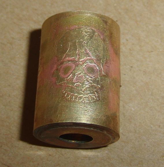

Had some fun with etching in the meantime, damn this focus on aesthetics and my artistic streak forcing its way out of the cellar I had confined it to! I have engineering to do aaaughhh!!!!
Long storyjmez1996 wrote:What are the symbols on the ring?

Damn, those skulls look sick!

wow that final skull looks insanely cool!! what are the things your etching on?

I think they're past sickGun Freak wrote:Damn, those skulls look sick!
Scrap pieces of brass, just playing with techniques at the moment.what are the things your etching on?
