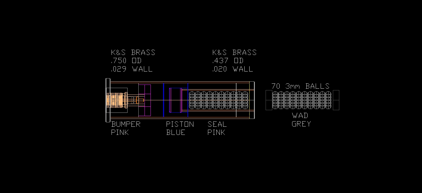

Is this what you are looking for?
3 inch long total, 3/4 inch OD.

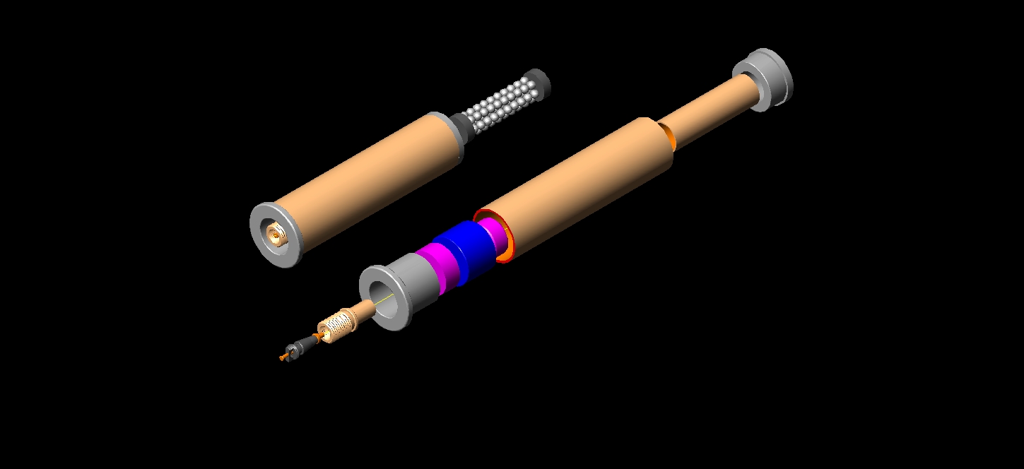

Wow dewey is that my design in 3D or a different design? It looks like mine.
If there is a shotgun shell in real life that is 3 inches long then I'll probably go with that or just increase my design by 1cm.

The design was for a hybrid cartridge that I did for JSR and modified it for a pneumatic cartridge. Here is a wiremesh side view.DerpWithAGun wrote:Wow dewey is that my design in 3D or a different design? It looks like mine.

Not to hijack or anything, but how much would it cost per shell like that dewey?
I think it would work though, the only thing would be a firing mechanism (unless I missed that somewhere in the thread...)
Very nice as always dewey!
(I've downloaded sketchup in the meantime... baby steps
I would make the piston out of delrin, this would remove the need for a bumper and possibly seal, and greatly reduce piston travel. The chamber is so small that piston bounce should not be an issue.
