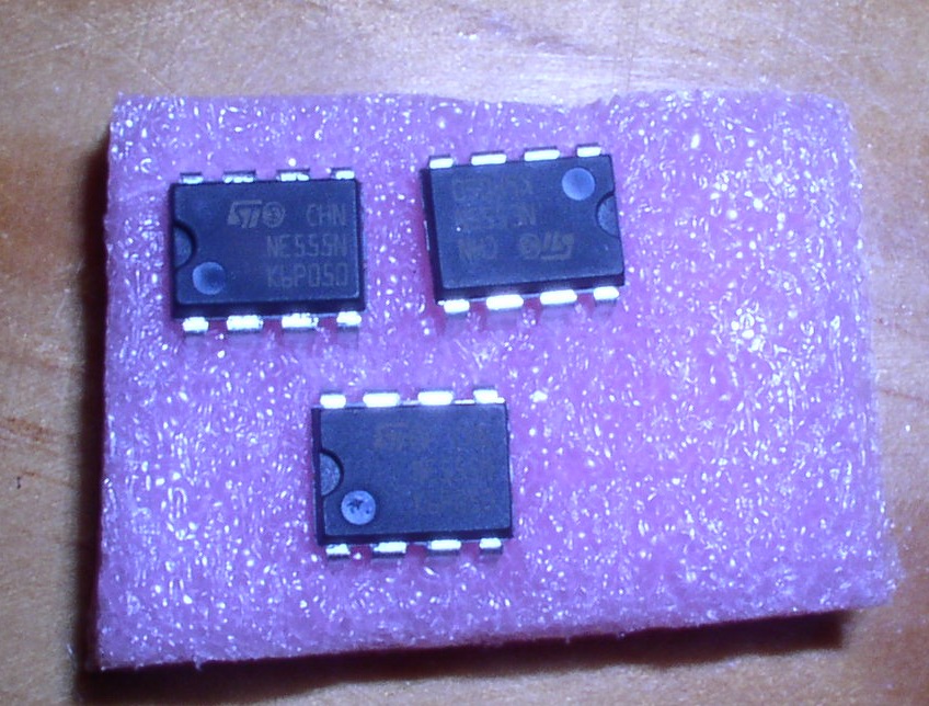

I have the circuit part done by dewey-1, very well done actually :)
what I need is find the right input/output of the 555 circuit, the real 555 circuit doesn't looks the same as in sketch :? .

wyz2285 wrote:I have the circuit part done by dewey-1, very well done actually :)
The schematic shows the pin numbers.
Are you referring to the physical IC package?
See this for the pinout diagram.
http://en.wikipedia.org/wiki/555_timer_IC
