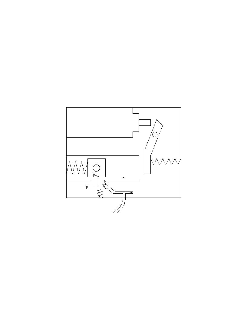

Like this quick 2 min job
Something like that (sorry i made it in 2 minutes)

Yes but the problem is when you press the trigger, unable to reset sear, not enough mass to open the valve, if spring was strong enough you would just get 1 big hiss of air,
Your looking for this then
