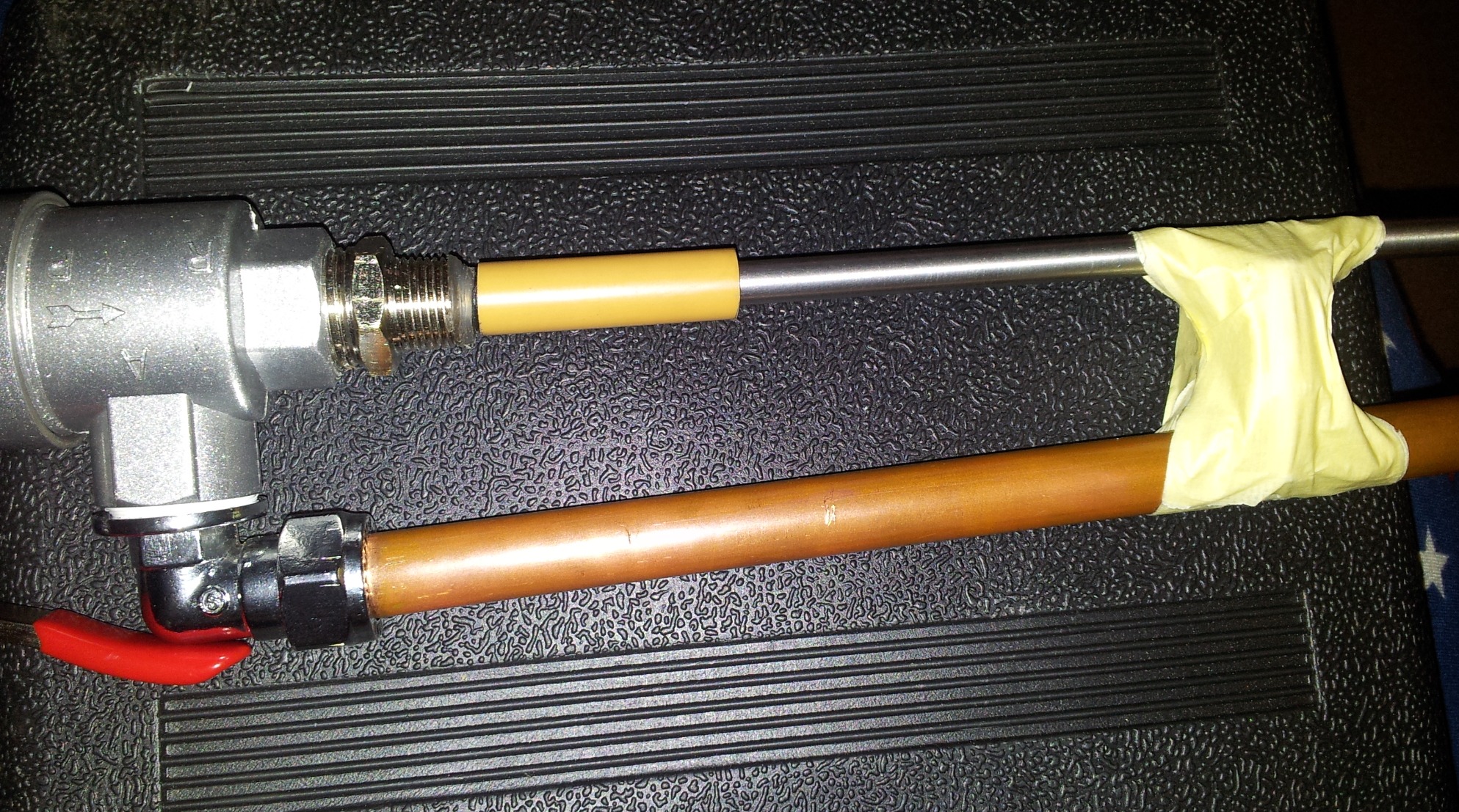

finally got a chance to finish the gun and acquired a stainless 500mm barrel 8mm OD and 6mm ID.
I had hoped to use this barrel with airsoft bb's and 6mm steel ball bearings but the ID is actually slightly undersize at about 5.9mm so they wont work but i can get 5.5mm bearings instead and also .22 ammo.
I have only tried it with this barrel under 60psi so far till I sort out the breech loading and few other bits.
i found a pretty good fit projectile which is the rear part of a dart! its a slightly loose fit in the barrel but i used it for the test shots.
i took two shots at a DIY chrony one at 30 psi and the other at 60psi.
projectile weighs 1.3 grams.
30psi = 29m/s (0.55 Joule)
60psi= 63m/s (2.58 Joule)
pinch of salt on the above figures but they are pretty close
with the pump I bought i can manage 200psi but any higher is nearly impossible to pump so it would be interesting to see if the velocity scales up at high pressure.

Managed to add breech loading to it and found some very good ammo to use with it :twisted: M6 threaded rod is a perfect fit! :D
I know i added a bit of dead space with the breech loader but it still shoots very well! at 60 psi an 8mm piece of M6 rod went cleanly through a can and the 6mm thick fiberboard that was behind it!
I also added a basic barrel support as ya might have noticed :lol:
1.3 gram 8mm piece of M6 threaded rod loaded into barrel
