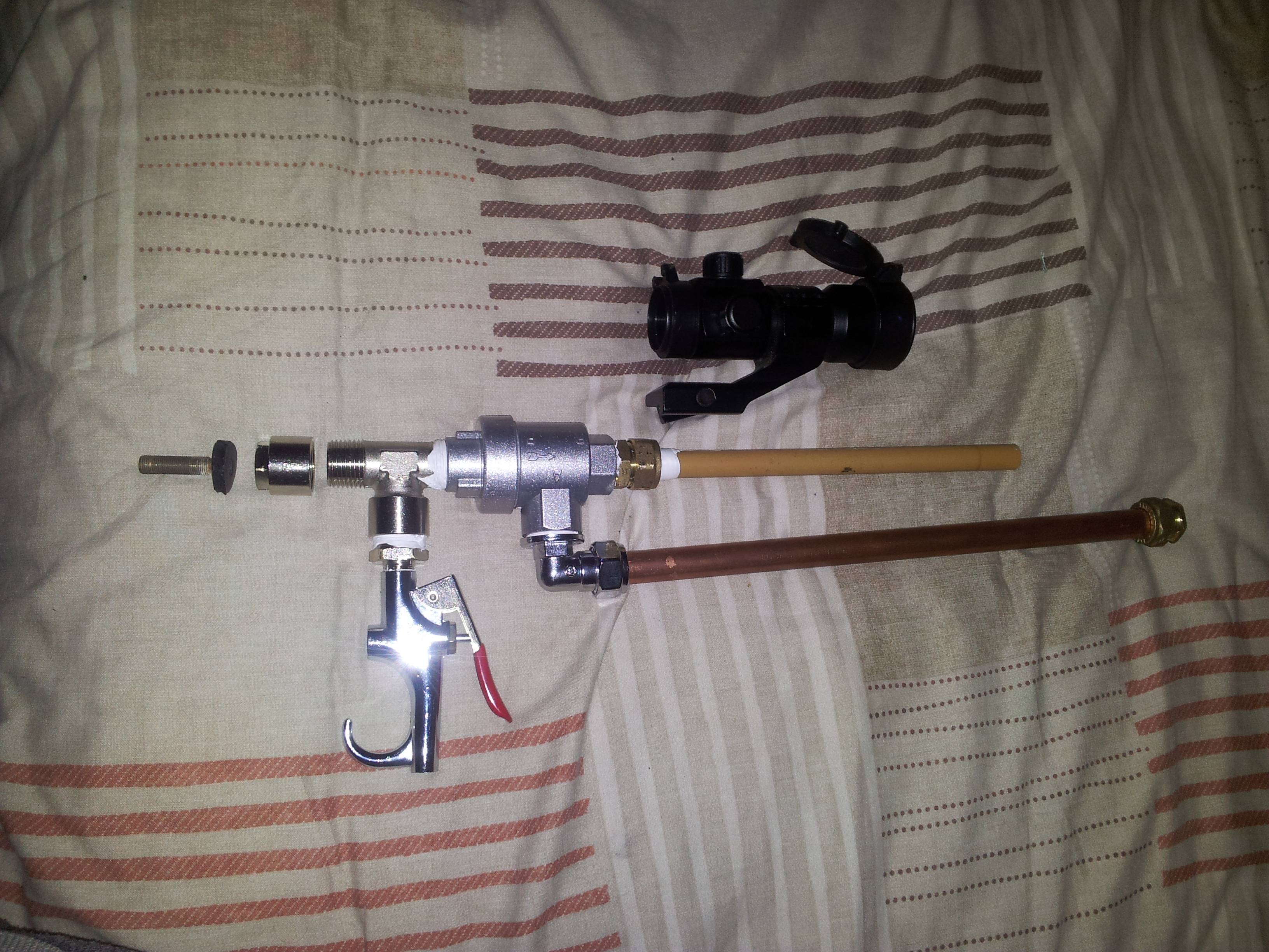

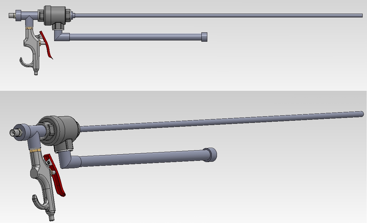

Bitta research into the different items needed I compiled a list and then set about getting an idea of how id lay it out using solidworks.
The main parts being 15mm copper pipe 300mm in length for the chamber.
1/2" "European style" QEV
usual 1/2" bst plumbing fittings
1/4" bst blowgun
650mm 6.03mm airsoft barrel
I tried out GGDT and got the following although having never used it before I probably went wrong somewhere.
0.25g 6mm airsoft it reckons velocity of about 220 m/s (6.2joule)
and 150 m/s (10joule) for 6mm steel ball bearings weighting approx 0.89g.
I then decided I didn't really want such a long barrel so I will probably go for a 400mm barrel which brings the above figures down to 188 m/s (4.4joule) and 125 m/s (6.9 joule) respectively.
big hit in performance for a shortening of barrel but I was happy enough with the estimated power.
As of this post I have all the parts minus the barrel and only need to machine the blanking endcap on the tee joint to fit the schrader valve and I can begin low pressure testing with a much smaller airsoft barrel I have lying about.
picture included with plastic barrel for mock up and I want to try mount a rail to mount a scope like shown.

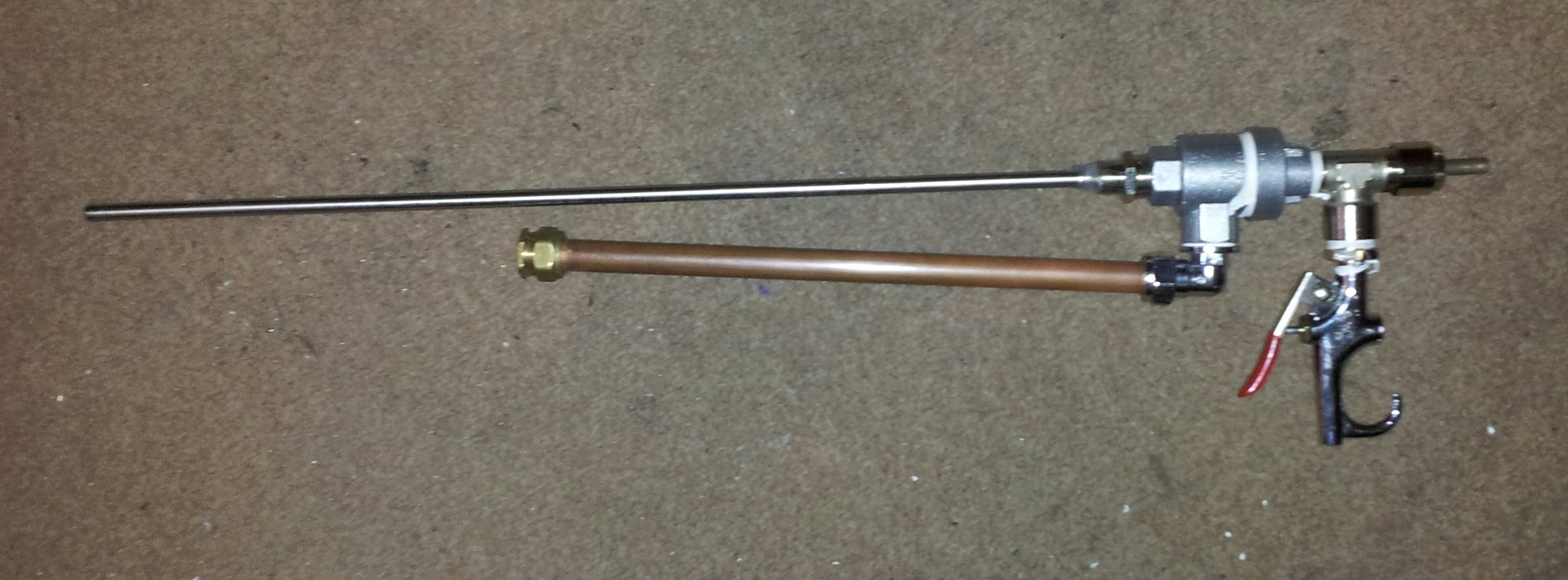

finally got a chance to finish the gun and acquired a stainless 500mm barrel 8mm OD and 6mm ID.
I had hoped to use this barrel with airsoft bb's and 6mm steel ball bearings but the ID is actually slightly undersize at about 5.9mm so they wont work but i can get 5.5mm bearings instead and also .22 ammo.
I have only tried it with this barrel under 60psi so far till I sort out the breech loading and few other bits.
i found a pretty good fit projectile which is the rear part of a dart! its a slightly loose fit in the barrel but i used it for the test shots.
i took two shots at a DIY chrony one at 30 psi and the other at 60psi.
projectile weighs 1.3 grams.
30psi = 29m/s (0.55 Joule)
60psi= 63m/s (2.58 Joule)
pinch of salt on the above figures but they are pretty close
with the pump I bought i can manage 200psi but any higher is nearly impossible to pump so it would be interesting to see if the velocity scales up at high pressure.

Nicely done for a first project (and nice SW rendering too :D). If power is what you're after you should really consider higher pressures, essential for small calibres.

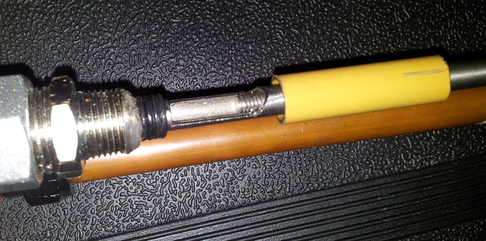

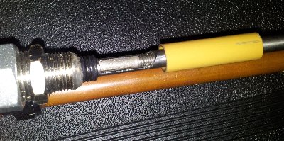

Managed to add breech loading to it and found some very good ammo to use with it :twisted: M6 threaded rod is a perfect fit! :D
I know i added a bit of dead space with the breech loader but it still shoots very well! at 60 psi an 8mm piece of M6 rod went cleanly through a can and the 6mm thick fiberboard that was behind it!
I also added a basic barrel support as ya might have noticed :lol:
1.3 gram 8mm piece of M6 threaded rod loaded into barrel
