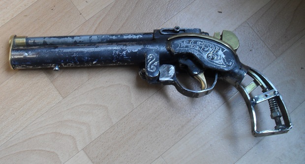

Well...as I announced earlier, my pump-pneumatic has been cut short and given a new life as a PCP pistol.
It's not yet finished ( looks like it was salvaged from a bombcrater...)
but fully functional..
I decided to keep it a single shot repeater.
The Girandoni style sidemounted magazine was removed.
I need to acces the breech in case of a jam and I didn't like the look of the tube mag.
I could do a cilinder or revolver style but I really don't think it'll look right.
I'd have to place the cilinder too far forward for it to work.
It feels like a desperate attempt to make it look like a firearm...wich is completely unnessecary..
On top of that...I think the lever action was kinda smart and I wouldn't like to destroy it.
I'd rather start all over and keep this one like it is.
Swinging open the triggerguard exposes the breech...I just pop in a roundball from my pocket.Works well.
The rough unfinished look gives you guys plenty to comment about , I'm sure... :wink:

I've fitted the 12 gram adapter into it and sprayed it flat black in a hurry..
And I've increased the flow by about 200 %..Just filed out the opening and unrestricted travel on the poppet-plunger-piston thingy..
That's all I've done since last time.
Still no grip on it.
Power is amazing though on a 12 gram bulb btw.
It'll pretty much pancake a roundball.
The shot felt ( not very objective I know) more powerful than Old Shat' .
Unfortunately on the second testshot the ( counterbalance) o-ring tore up...something I had expected to happen much earlier as it wasn't very good to start with...I got better ones and fitted the piston with two instead of one..
I need to keep tha pressure off that one side!!
I haven't had a chance to get new bulbs so I only did two shots.
Well..I didn't really feel the urge to...
I want to build a new/cleaner one as I'm not content with it as it is.
So for the time being I don' t even feel like getting CO2...
Opening it up to fix the O-ring problem emptied my last bulb.
Without the O-ring the valve is near impossible to knock open.

Sorry boys..
Some rough parts just bothered me.
For instance, I had to shorten the main tube to allow acces to the 12 gram adaptercap.No way of tightening it if it is housed completely inside of a tube... :D
You guys got to me..I decided to do some work on it.
Before my fix yesterday the main tube was cut short, but not very straight.. :oops: So I fixed that.
Another thing I hated was the gap between the sideplates and the pressuretube.
I decided to fill that up.
I want the structure and design of the gun to look clean, the finish can be rough though..like a well made -but worn afterwards- kinda look.
I finished bondo, sanding and paint yesterday.
Unfortunately the clearcoat I used dissolved the paint partially so I´ll have to redo that, hopefully today.
One thing is still unclear and eats at me in the back of my mind.
Did the O-ring tear because of freezing issues???
Maybe... :roll:
If that was the reason then CO2 is not even an option...
