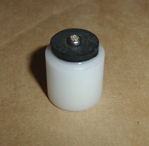

A quickie while I'm at it, delrin piston for DaxSF

Wyz tell me how it works. If its good id like to test one :P

Sure thing, but I don't have a decibel meter or chrony. :(

Record shot with and without it. Then ill do the smae. We should get a comparison. I mean ill do it with the baffles i have

I'll use audacity then, as soon as the parts arrives :)

Yap, took way more work to install it than I thought through :roll: there were two screws inside I didn't knew about, had to sand a slot.
Worked way better than I thought too :shock: I noticed the effect right on the first shot.

That's a problem, I don't have any video of it without the internal and now it's stuck there I can't remove it :(
