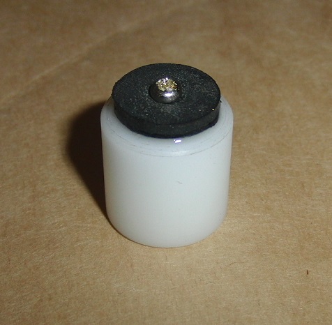

Wyz tell me how it works. If its good id like to test one

Sure thing, but I don't have a decibel meter or chrony.

Record shot with and without it. Then ill do the smae. We should get a comparison. I mean ill do it with the baffles i have

I'll use audacity then, as soon as the parts arrives

Did you get the parts after all?wyz2285 wrote:I'll use audacity then, as soon as the parts arrives

Yap, took way more work to install it than I thought throughDid you get the parts after all?
Worked way better than I thought too
Excellent, glad to hear itwyz2285 wrote:Worked way better than I thought tooI noticed the effect right on the first shot.
Did you do a comparison video? And does it still shoot well?

That's a problem, I don't have any video of it without the internal and now it's stuck there I can't remove itDid you do a comparison video?
Oh well, as long as it's better now
