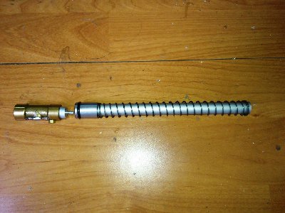

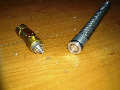

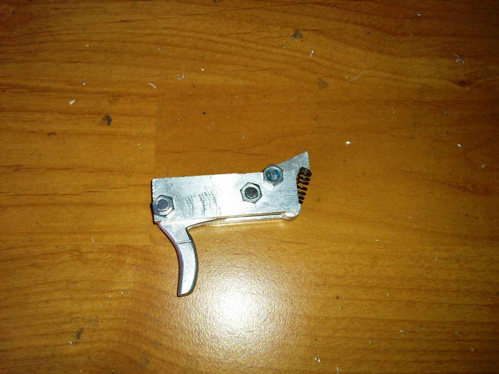

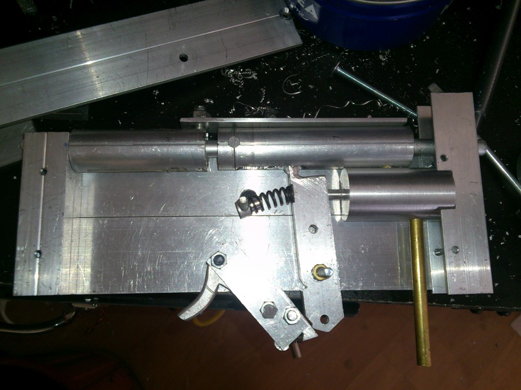

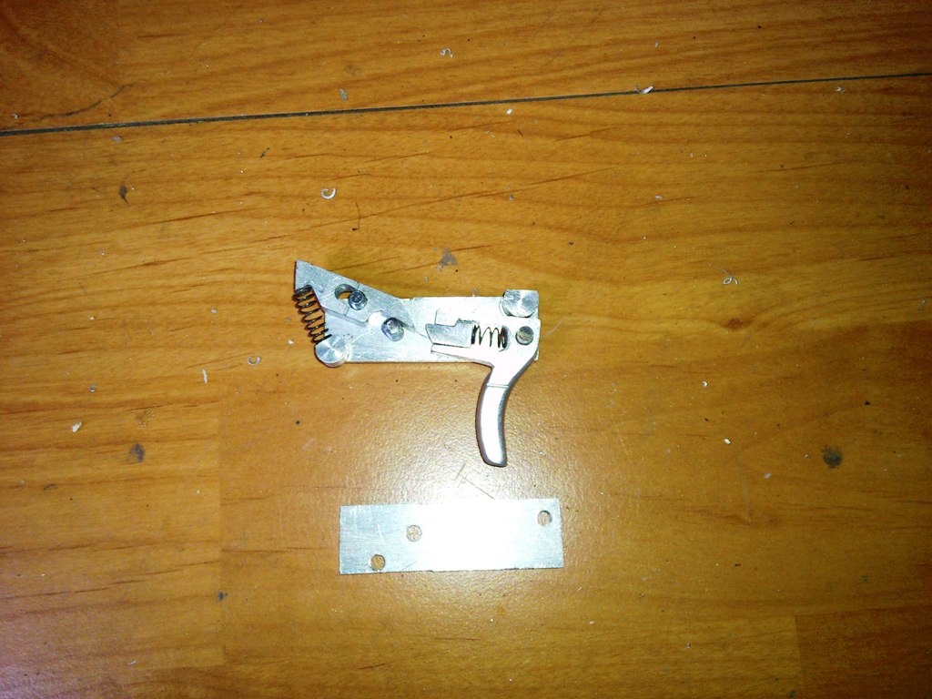

For now I have finished all the tricky parts: trigger, valve and airtight hammer with spring.
Semi-auto blowback WIP

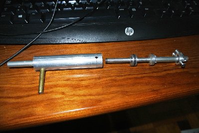

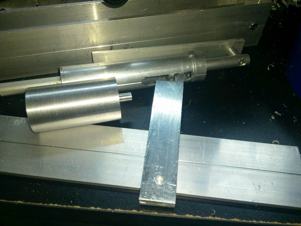

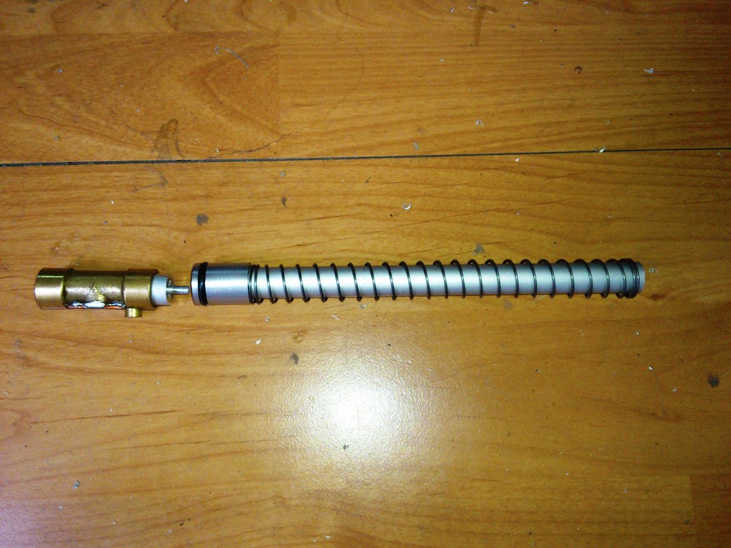

made this work, wonderfully.
Works the same way as what Gun Freak and JSR posted, but I had it in my mind for a while also.
My spring box haven't arrived, but thanks to the o-rings I bought I could make the all the little spots airtight.
Only tested it by push a blowgun nozzle against the port that will be connected to the hammer valve, with quite a strong spring pushing the piston, it still delivers a hard kick and the flow isn't bad at all.
Designed a new rotating hammer for it, going to mill it out tomorrow, hopefully next week I'll be able to post the gun

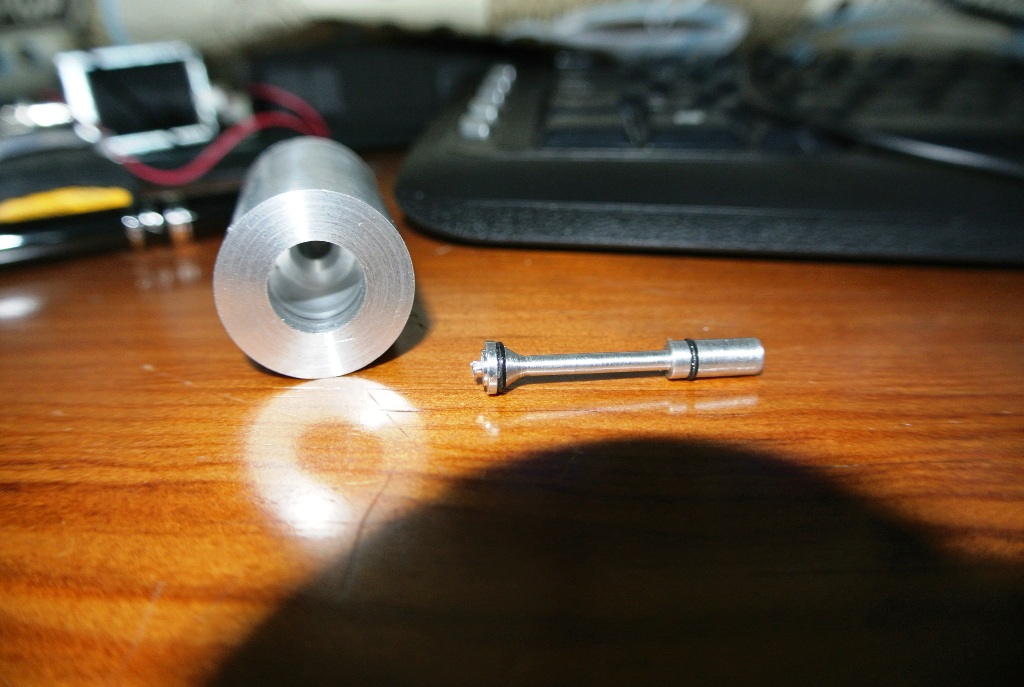

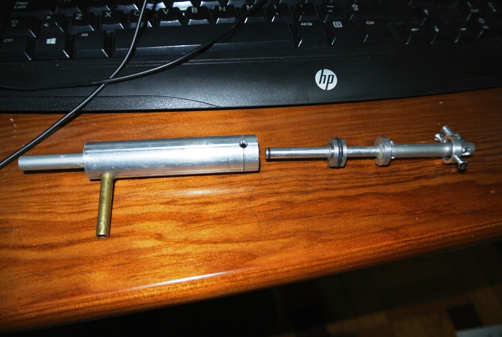

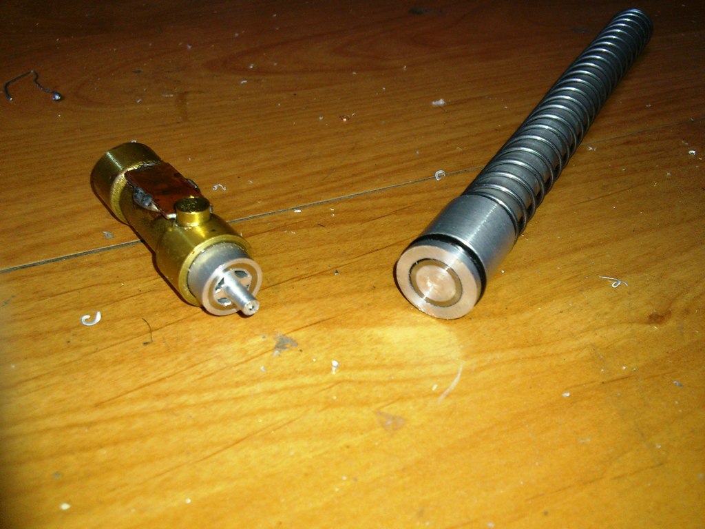

Finished the valve, I machined it from a solid aluminium cylinder
The valve stem is probably the most tricky thing I've made so far
but with the help of some homemade HSS tools it turned out really well
I'll finished milling the hammer this afternoon and start assemble tomorrow.

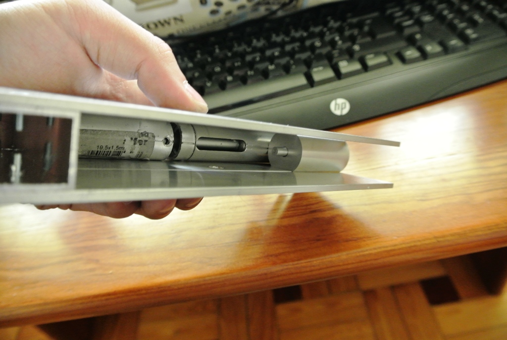

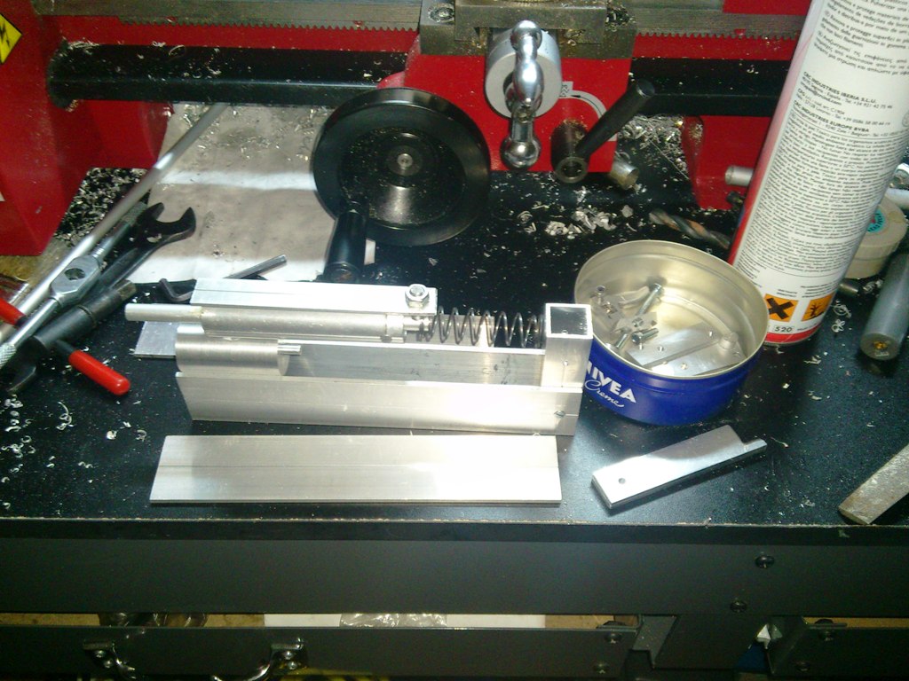

Epoxyed the valve with blow-back cylinder, hammer locking mechanism finished, roughly shaped the hammer which already works
All left are actually just some holes to drill and mount everything

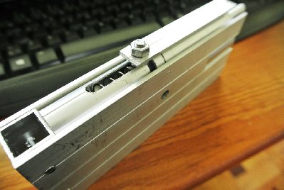

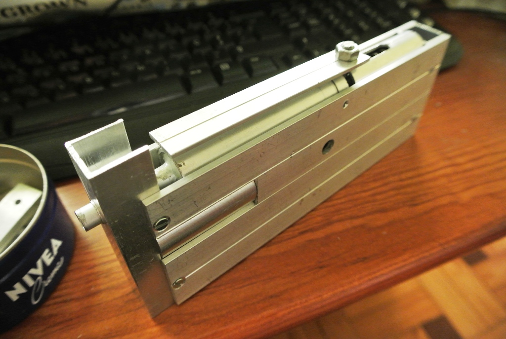

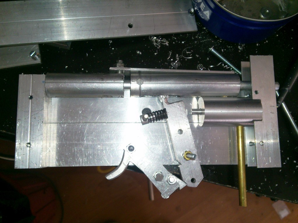

Finished the housing, now just missing some holes to mount the pieces of trigger and hammer
Edit: made some adjustments on the piston length, burst the power a little
Also will favor the return spring life span.

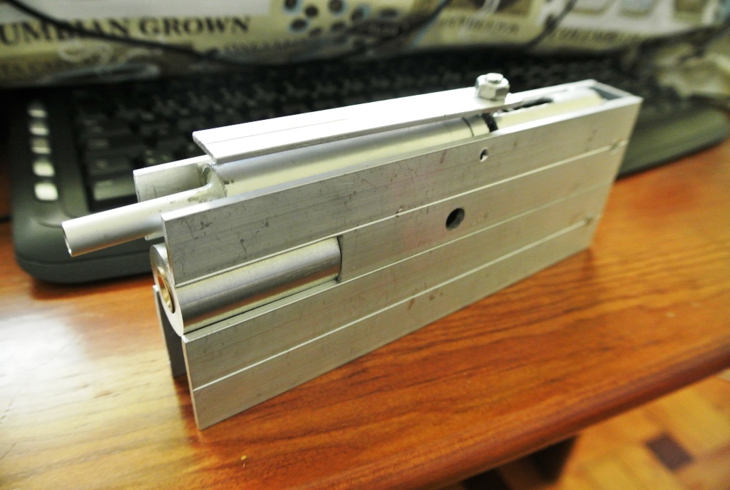

Finished the hammer and lock.
Tested, worked at pressure as low as 50 psi. past through 100 psi the piston opens as a bang also travels back way further than I thought. Hammer is re-cocked reliably, however I'll take the advantage of the extra piston travel to use a weak spring but longer for a smoother operation.
