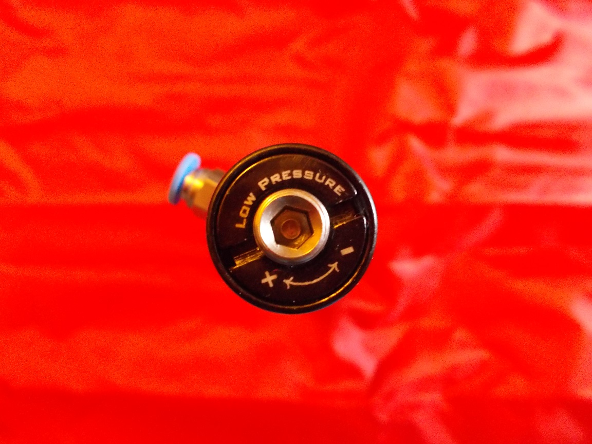

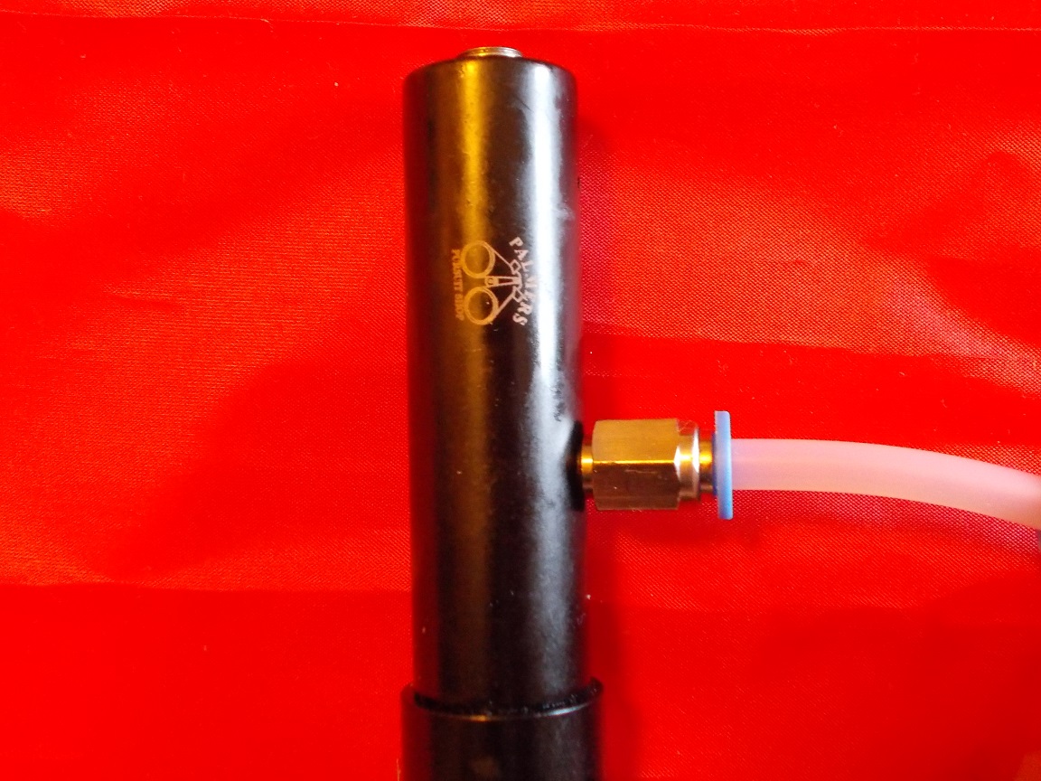

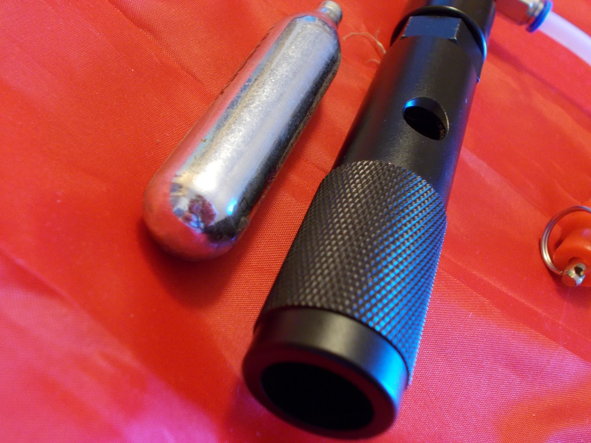

OK, so I bought the Palmers Pursuit Rock The Boat CA regulator as you recommended. But am a wee bit unsure of how to work it properly. The problem is that when I turn the screw and set the out put pressure to its lowest setting or off.
And then (with the regulator not connected to the guns circuit) I screw in a 12g Co2 canister, and instead of stopping and air from getting out of the regulator the air just shoots out of the regulators output port. It does this at high speed and the air seems to be unregulated. What does CA or Constant Air mean? Is my regulator faulty or am I just doing something wrong?

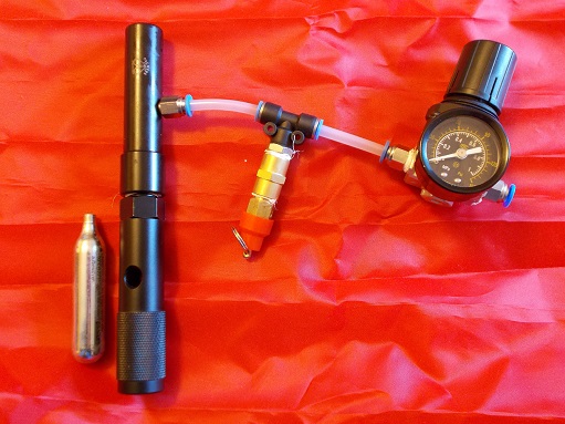

The regulator set up I plan to use:

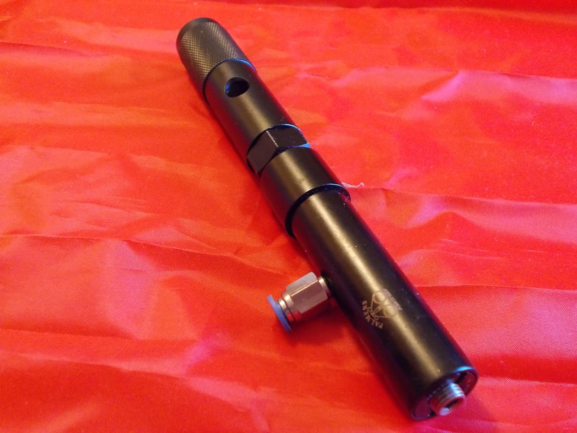

The regulator unconnected as when tested:
As you see on the regulator circuit I have installed a safety 10 bar pop off valve should the regulator fail. I also have a second regulator for fine adjustment of pressure to the gun.

The regulator's job is not to act as a valve - the +/- setting increases or decreases the output pressure but is not an on-off valve.
Did you try this setup with the secondary regulator output sealed? I would do that with the Palmer reg at its lowers setting and progressively increase this setting and see how the pressure changes on the secondary reg gauge.
