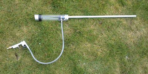

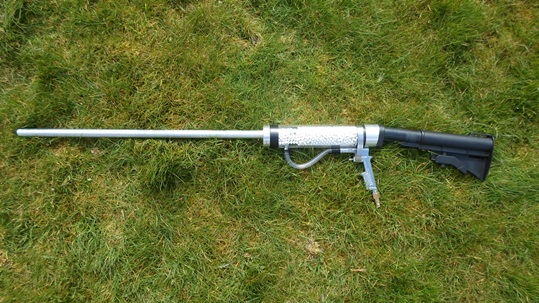

The parts and materials I started with were: an airsoft stock, 50mm OD 40mm ID and 200mm long clear acrylic tube for the magazine and firing chamber, a billet of aluminium bar, a blow gun and inner and outer barrel.
I started by turning down the aluminium to 50mm to match the od of the tube. I cut in to 40mm 50mm long for the vortex block to fit inside the tube, i did this for another bit 10mm in for the end cap.
I did the rest by hand using a hacksaw, file and obviously drills. This took quite a bit longer than I expected but this is what the finished block looks like
Assembled with aluminium outer barrel and 6.3mm id inner barrel, 400mm long

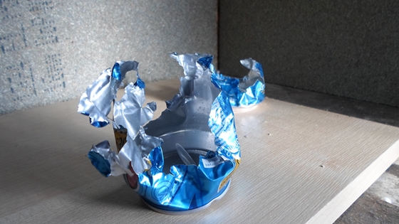

I'm sure this did some pretty decent damage too:
You should also make the forum aware of your other projectile launching endeavors:
http://fibrestudios.weebly.com/paintbal ... ncher.html
