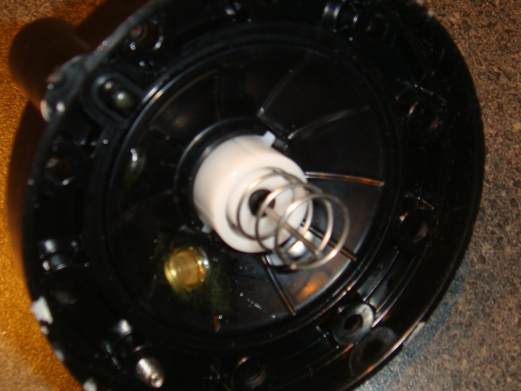

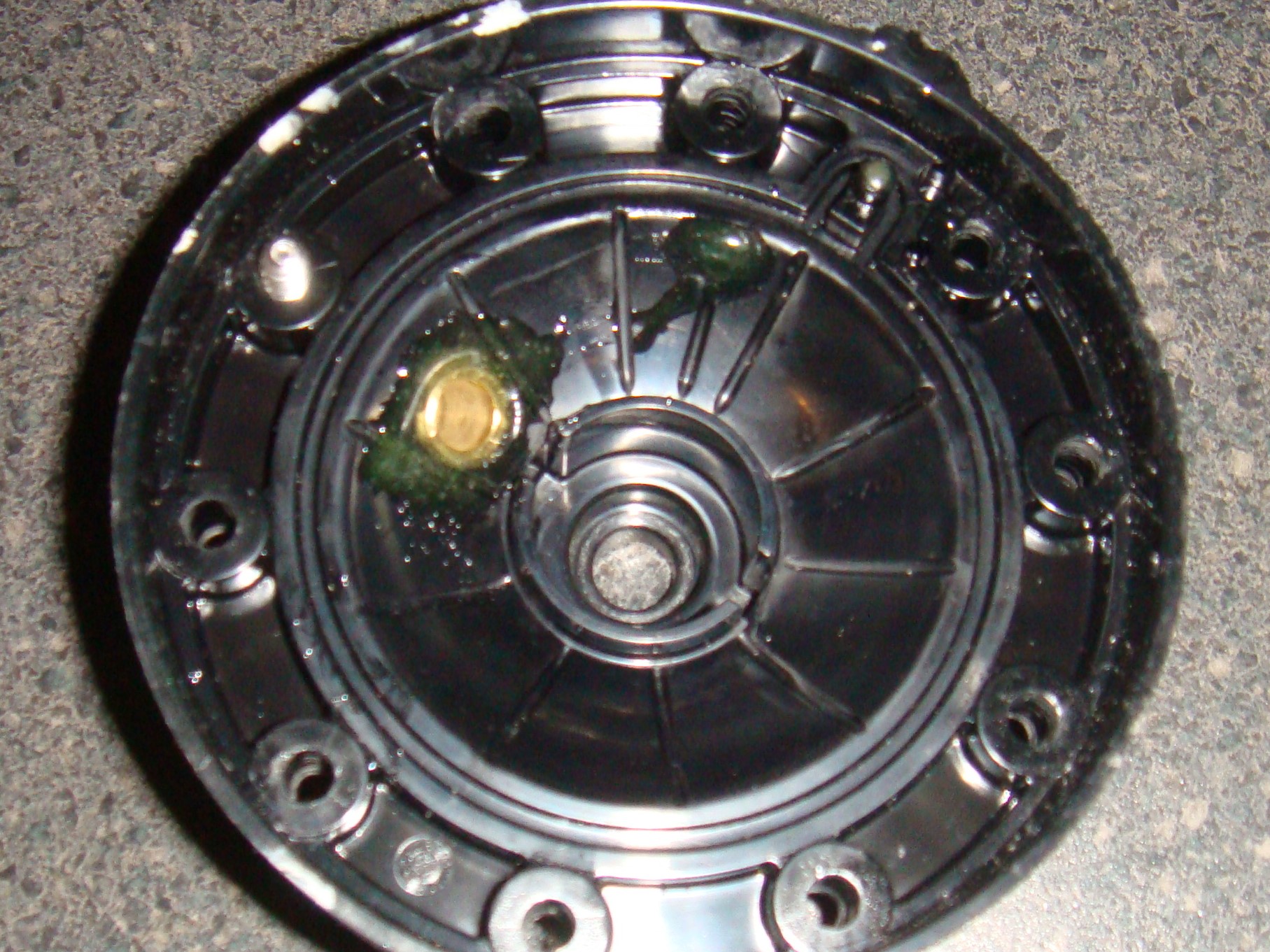

ok so I now have modded the sprinkler valve from the side (leaving guide rod ect in place),1/2 inch thread into the side of the valve,got a 10$ blow gun,just waiting for the epoxy to harden.
heres some modd pics

in the last picture the hole at 1 oclock should I have poxied that one?It joins up with a hole that runs to the exaust side of the bottom half of the valve.
Boomer58cal
- Posts: 125
- Joined: Tue Apr 01, 2014 12:53 pm
I would plug the little hole at 1 o clock, it will probably allow the valve to stay open longer.
