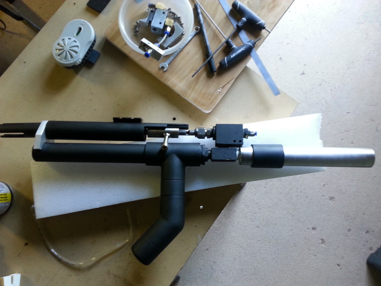

Stainless steel chamber upgrade work, the original PVC front part of the chamber is plugged off, will be doing a chrono test soon as well.
