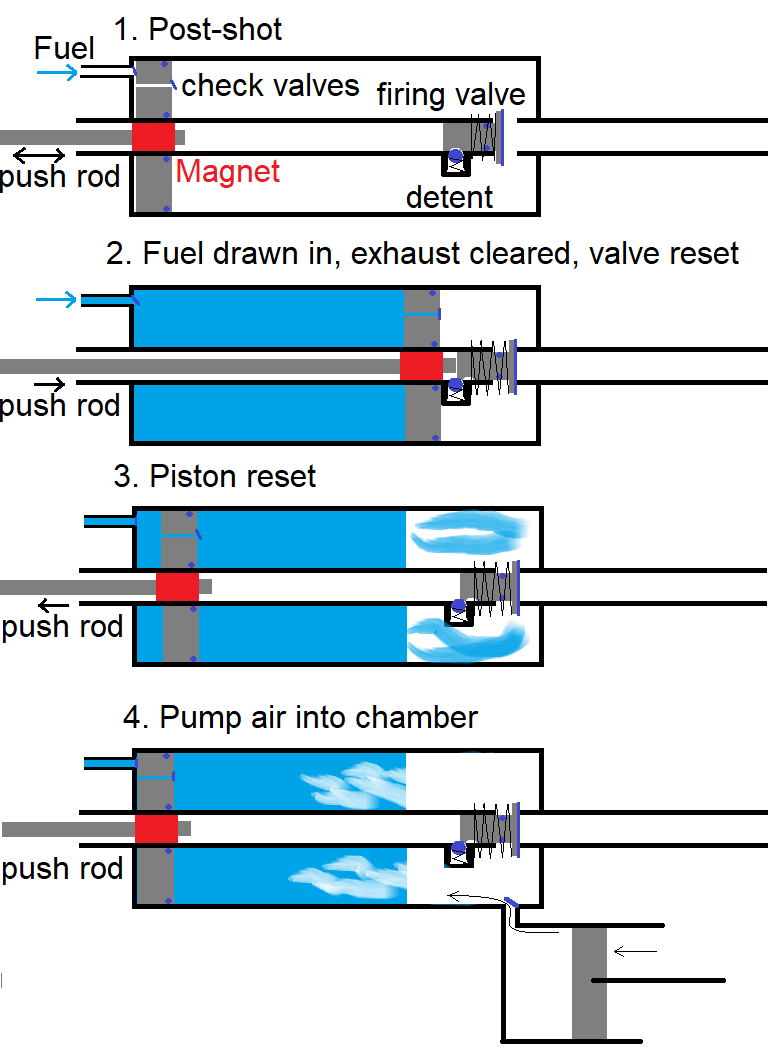

Here's what I was thinking for the fuel/exhaust cycle:
When the gun fires, the firing valve piston gets trapped by the detent, so it stays open post-shot. Then, the push rod is pushed forward, drawing in fuel through the check valve from a near-atmospheric-pressure fuel reservoir (eg, syringe or balloon). At the end of the stroke, the push rod releases the firing valve from the detent, closing it. Then the push rod is withdrawn, and the fuel flows through the check valve in the fuel/exhaust piston and occupies the chamber. Finally, the pump pressurizes the chamber with air.
I'm thinking that the push-rod could be coupled to the loading mechanism, so that a new projectile is loaded at the same time. The push-rod could also be coupled to the pump, so that as the pump moves forward, it pulls the push rod forward until the push rod hits its limit of travel. At that point, the push rod disengages from the pump and returns using a spring. I'm still kinda fuzzy on the details of making that catch/release mechanism.

Have you already got the materials to build the prototype? It may work, but to be safe and learn from the facts, you need to build and test this idea. Surely, while testing or building, new doubts and problems will arise. I will be attentive to your updates on the prototype.

Edit: The more I think about it, the less I like the idea of having a bunch of moving parts and seals in the chamber. Maybe the way to go is a manometric metering with a 3/2-valve that empties into the pump air intake. At 24x or so, the presence of exhaust gas in the chamber is pretty much a rounding error. I also don't like the idea of being stuck with a single mix ratio that I can't adjust.
