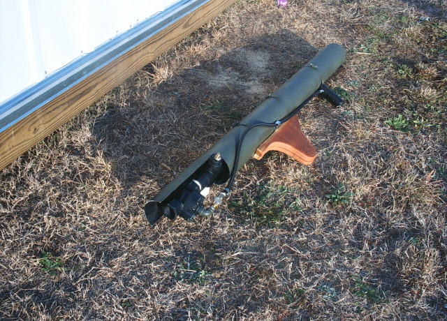

Well I’ve made reference to this gun before as my “LAW” or my coaxial air cannon; I figured I might as well post it.
It was never finished, meeting an untimely demise at the hands of gravity (it fell of the loading bench well I was doing some test fires last week.), but here are some of the original pictures and the guns specs:
Caliber: 1.50 inch
Barrel length: 28 inches
Camber diameter: 3 inches
Chamber length: 28 inches
Muzzle velocity with a 3oz. projectile: approx. 300FPS
Max arming range: approx. 300 yards
Max combat range: approx. 150 yards
Accurate range: approx. 100yards
Min arming range: approx. 30 yards
The piston was made out of hot glue, works great, and the sealing face is sheet rubber labeled as “gasket material”.
The muzzle end has a built in coupler and the plan was to modify that and a short piece of pipe so that the barrel could easily be extended for longer ranges.
Originally it had a 0-100psi gauge on it but I upgraded it to a 0-150psi gauge.
Later on I added a ball valve safety, and some decals.
When I get around to fixing it I’ll paint on the decals and put a brass plate on the butt-stock with the make and model on it.
And here she is:

Yeah thanks, I was going for the Bazooka look, except shorter.

I forgot to say this in my original post:
The gun was designed to be portable; it’s about the length of a gun case so it fits in the back of our van. Oh and here are the decals I made for the cannon:

No scope, I am going to make an optical sight though, just no magnification. The magnification makes it hard for me to judge distance.
The wood was fun to work with, but it doesn’t fit right, that's another thing that needs fixed.
I’ll post pics of the gun in it’s current, damaged, state as soon as posible.
