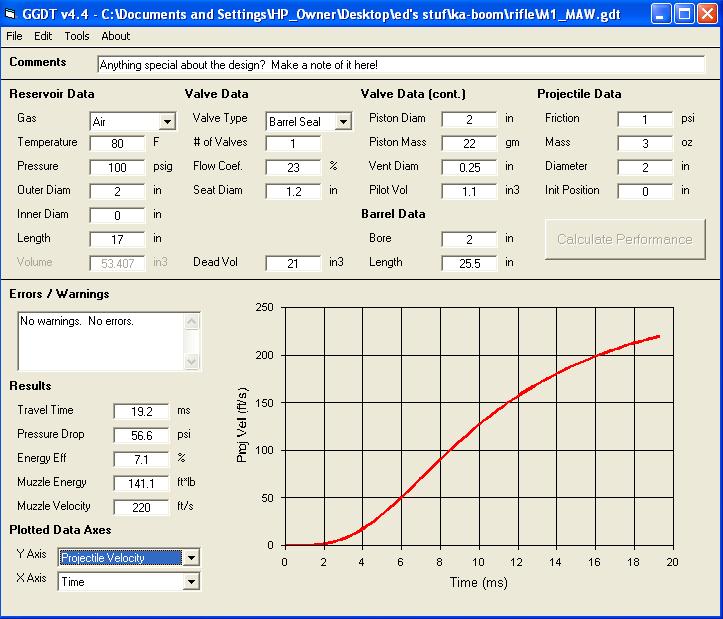

Caliber: 2inch, 50mm (2”X10”R M2 cannon cartridge)
Barrel length: 26 inches, 660mm, 13calibers
Reservoir: 2”X17” 53.4in3, 50X431.8mm
Muzzle velocity at 100psi: 220fps, 67m/s*
Muzzle energy at 100psi: 141ft*lb, 191.3J*
*according to the GGDT

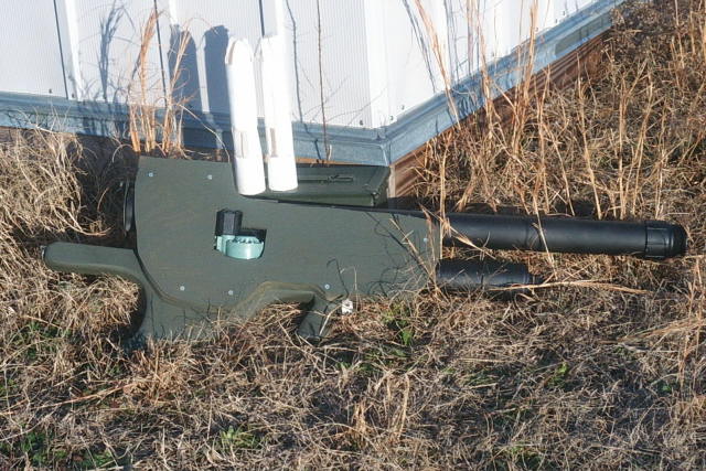

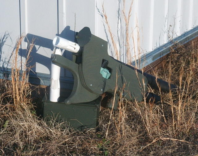

A1 version adds a plywood receiver, a pine wood stock and pistol grip (modeled from a Colt SAA grip frame), and a breach plate
On the muzzle there’s a 2” female threaded adapter, to which will attach some planed accessories, including: a bipod, 20” barrel extension turning it into a mortar, a choke for shot, and a 3”X12” barrel extension for larger projectiles.

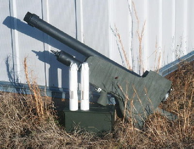

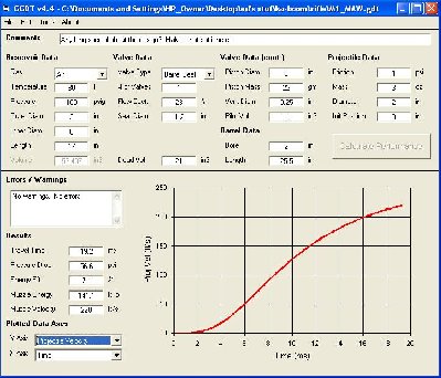

Here’s some photographs of the cannon and the GGDT data on it:

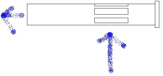

the air comes in through the slits in the side of the cartridge and pushes the projectile out the front, see pic.jon_89 wrote:Looks pretty good. Can you explain the cartridges more?
if you need a more technical drawing give me a while and i'll dig up some of my high quality images.
- cartridge.JPG (12.28 KiB) Viewed 4665 times
nice and clean looks a little like some thing from halo. looks like theres some dead space from where the sprinkler valve is. also what is that coupler on the end for. Again go into a little more detail of how the cartridges work maybe a schematic, its probably really simple but i dunno.
edit, okay i understand do the cartridges seal well it looks like you might lose some air.

For those of you that still don’t understand the cartridge the first picture in the first post shows how it works.Gas Assisted Recoil Prototype
As for the dead volume, well it’s actually a good thing, according to the GGDT if I cut down the dead volume it it’ll cut back the muzzle velocity, go figure…
