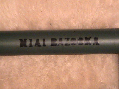

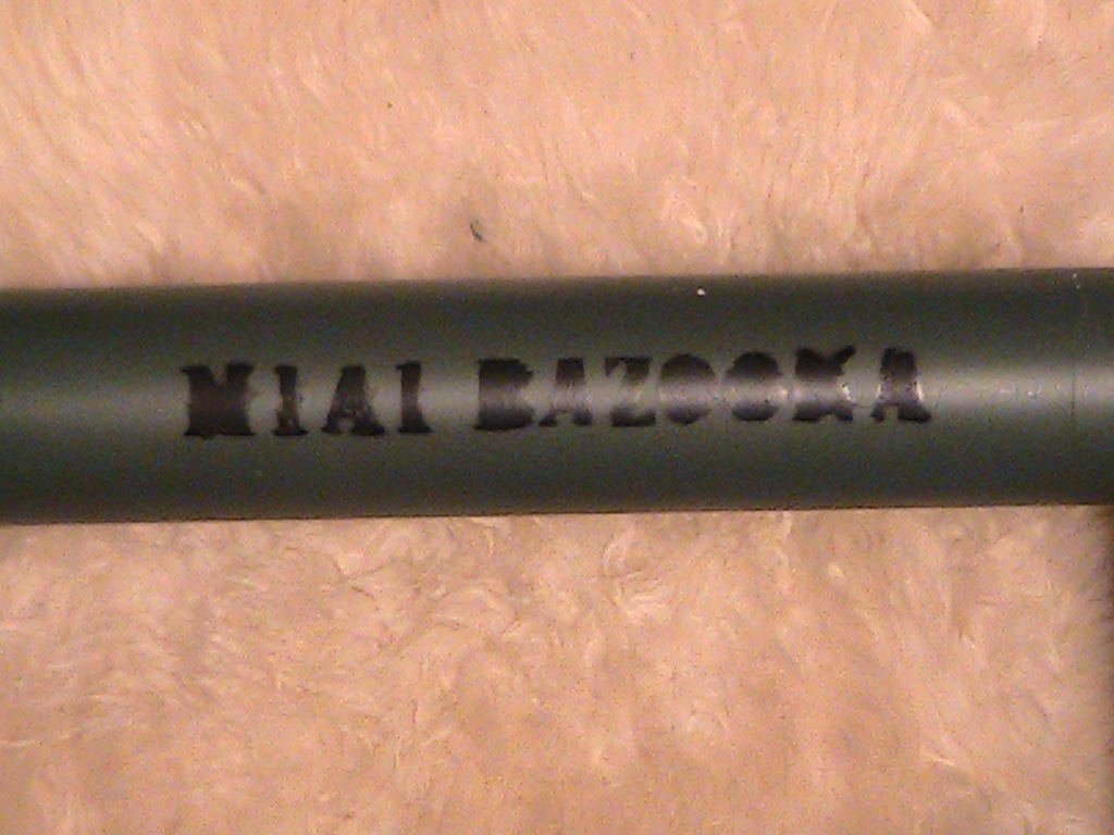

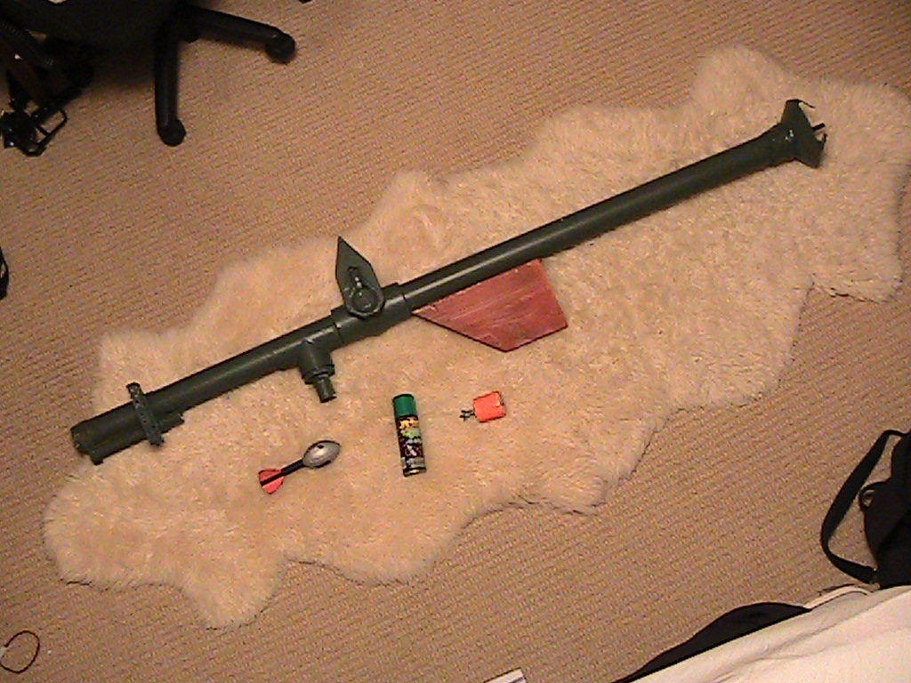

this is a cruddy little thing my mate wanted for airsoft games. It has a 2inch ball valve as a valve and has a spring powered setup(not pictured).
caliber-2inches
cb ratio- 3:2 (3 foot chamber and 2 foot barrel)
main ammo- mini nerf rockets- 2 inch wooden slugs (not for airsoft of course)-airsoft bbs for bb showers.
it can shoot surprisingly far for its short barrel with an approx. 300ft range with nerf rockets.

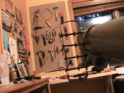

the leverage stick on the ball valve is a mock (and oversized) rear bazooka rear sight. the front sight works and is made from steel strips. it is an elevation sight with 4 different settings.
the stock is wood furnished and stained
the rear flare thingy on the back (not sure what the weapon name is for that) is from a water-heater chimney brace from one of many water-heaters i have installed and taken out.

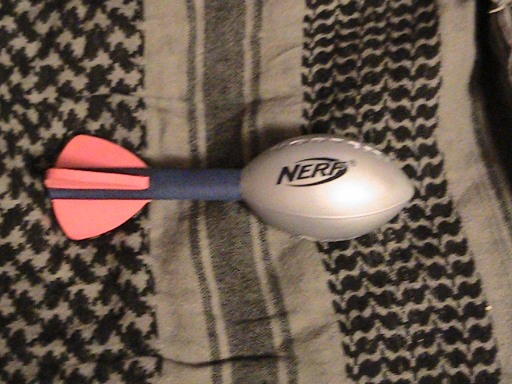

the nerf rocket. makes a satistfiying "whump" when fired

the bazooka. it is over 5 feet long so for an indoor picture i needed to turn the camera diagonally to fit it in the picture

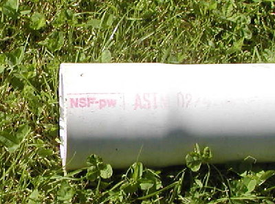

As promised, here are the photos of a golfball bazooka. This was designed to quickly stash and not raise suspicion when tossed in a pile of pipe supplies. It is designed to not look like anything dangerous. It is just under 6 feet long.
This cannon is built like my Mouse Musket. It too has a close ratio valve. Due to the thinwall chamber and barrel, this is a low pressure launcher.
The camouflage paint scheme is industrial shop incognito. It works well in it's environment and is easily concealed in a shop.

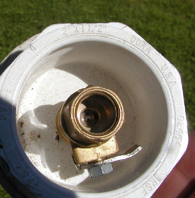

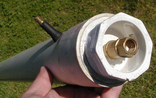

Close up of the trigger inside a 2 inch threaded plug makes this launcher valve serviceable.  This like the Mouse Musket has a 2 inch pipe inside the Female Adapter to act as the piston cylinder.
A ball valve concealed in the breech hides the true nature of the launcher as a coaxial piston launcher.

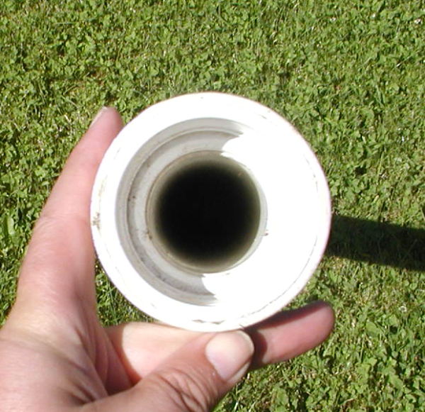

A view into the muzzle reveals the golfball barrel inside.  From the inside out is the 1.5 inch GB barrel, a 2 - 1.5 inch reducer, a 2 inch coupler, and the chamber is 2.5 inch thinwall PVC pipe.
Like the Mouse Musket this used advanced PVC forming.  This muzzle is a 2 inch coupler and a reducer inside the chamber.
