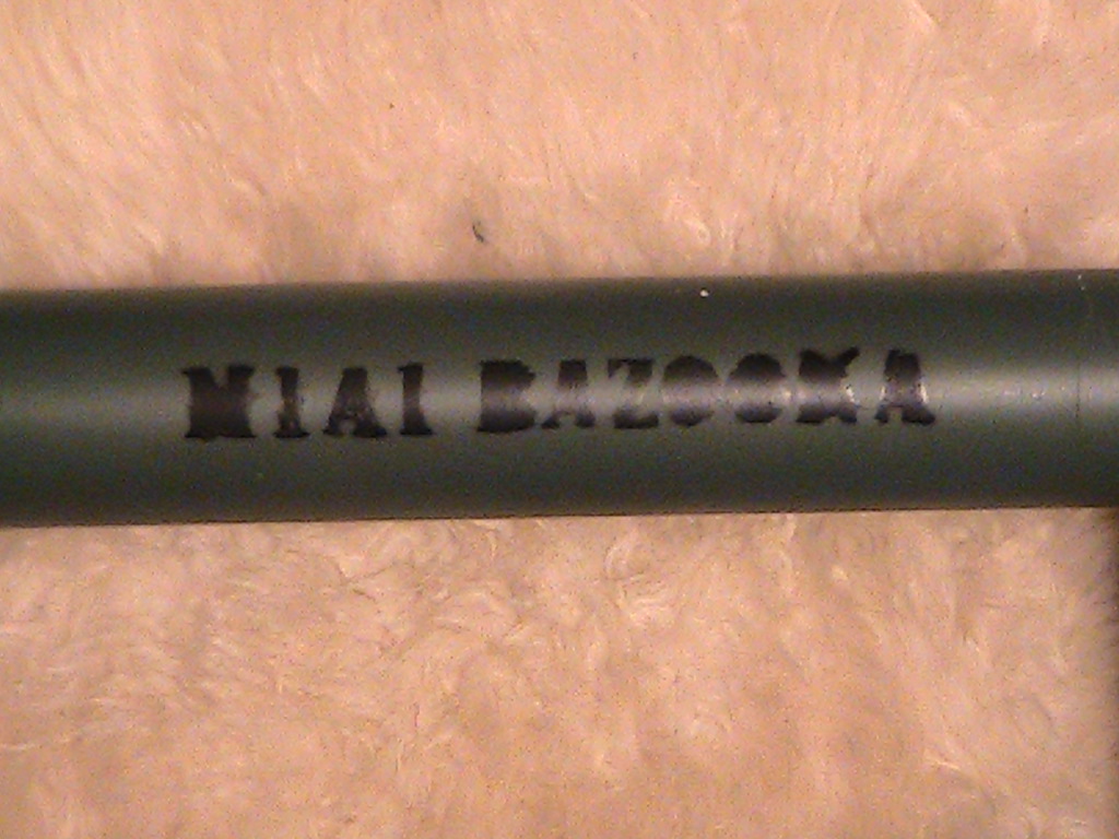

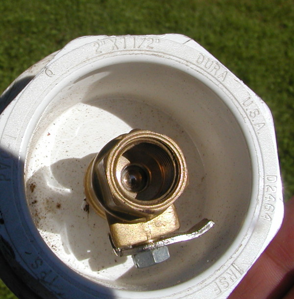

this is a cruddy little thing my mate wanted for airsoft games. It has a 2inch ball valve as a valve and has a spring powered setup(not pictured).
caliber-2inches
cb ratio- 3:2 (3 foot chamber and 2 foot barrel)
main ammo- mini nerf rockets- 2 inch wooden slugs (not for airsoft of course)-airsoft bbs for bb showers.
it can shoot surprisingly far for its short barrel with an approx. 300ft range with nerf rockets.

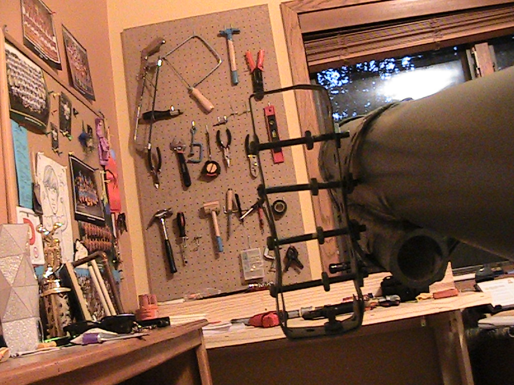

the leverage stick on the ball valve is a mock (and oversized) rear bazooka rear sight. the front sight works and is made from steel strips. it is an elevation sight with 4 different settings.
the stock is wood furnished and stained
the rear flare thingy on the back (not sure what the weapon name is for that) is from a water-heater chimney brace from one of many water-heaters i have installed and taken out.
M1A1 BAZOOKA

Interesting. I like ball valve guns, but I would suggest that you get a 1" sprinkler valve and mod it, you will get alot more range.It seems that everyone builds (or wants to build) a bazooka eventually.I'm working on a bazooka right now, its just on paper tho. Nice shop btw.

I'll have to agree with Ranger though. A Sprinkler valve will give you more consistency, and make it more accurate if you pilot if with a blowgun. The trigger pull will be less so than the awkward nature of a ball valve.

Looks good. I would also suggest a 1" sprinkler valve...

yup my buddy wanted to keep it simple bc he had never made an air cannon . he also didnt want to spend much money of a sprinkler valve. half way through biulding this i said "bullocks, why didnt i make a coaxial piston valve?!?" because the srping powered trigger valve(not pictured) was a real gremlin to make work

You mentioned your friend didnt want to spend money for the a sprinkler valve but 2 inch bv are about 10 bucks and so are sprinkler valves, blowguns are 3-4 bucks at stores like walmart so it wouldnt be a giant price increase, so if you ever build a another one you may want to considar this

yes but in the town i live in those valves are not readily available and i would have to special order itclemsonguy1125 wrote:You mentioned your friend didnt want to spend money for the a sprinkler valve but 2 inch bv are about 10 bucks and so are sprinkler valves, blowguns are 3-4 bucks at stores like walmart so it wouldnt be a giant price increase, so if you ever build a another one you may want to considar this
