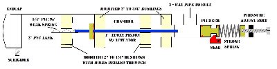

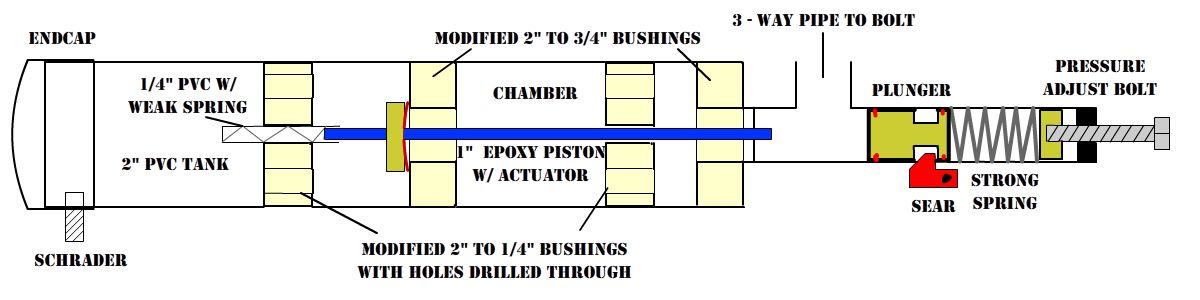

Morpherman, I have been thinking more seriously about using your plans instead of clide's HEAR valve (for my paintball semi), as your valve is easier to make. It seems to have the same efficiency (no pilot), good opening times, it's semi, and frankly in theory it should be more reliable.
SO... I examined the design I tried to pick out the errors and make it less rough and do-able. I made a picture with my changes to show you!
Specificly, I added stabilizers to the piston, moved the sear (no air loss), and enlargened and streamlined the chamber area. I also added a screw to adjust the spring pressure to account for different PSI's.
MorpherValve redesign!

if someone builds this i think i might have to copy it. you do realize that if you let the sear just stay down you get full auto at an incredible RPM.
ALSO!!! why use the blow-foward bolt when the piston/sear can actuate the bolt opening-closing. its far more efficient...........
Hailfire753
Posts: 348
Joined: Thu Jun 28, 2007 11:50 pm
Location: Near Philadelphia, PA
Yes, we relize that. This has the potential to become the one of the best semi-auto/auto valve, maybe even surpassing the HEAR in preformance, efficiency, and reliability. The one limiting factor, like morpherman said, is that it would need a stronger spring at higher PSI's, meaning slower and less efficient.
I also though about using the piston to actuate a bolt, but I don't know how I would do it. It can't be put inline because the actuating piston would hit it. You have any ideas?
EDIT: I think I have a solution for the high pressure issue. Pic may follow, but for now I will just describe it. Like in clide's valve, there would be a second piston on the same axis, but behind the pressure source. In this case, It would be in an isolated section behind the schrader. If you don't understand, TOO BAD! :twisted: Or, the piston could be 1.25" and cover a 3/4" barrel, so that there is only a small foward pressure from the air and spring.

Also, do you see any problems with my pic?

Yup, I'm just waiting for some advice from some knowedgable members such as clide,jsr,BC,SB and some others. As soon as I findout What strength pring I need, I'll start pushing ahead. Thanks for your imput btw,We seem to have similar goals right now
Edit: The only thing i see in you pic is that The air might rush out the barrel before recocking the hammer.

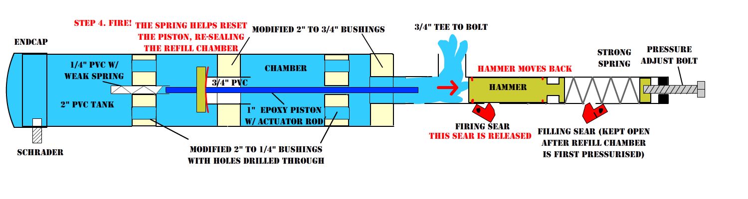

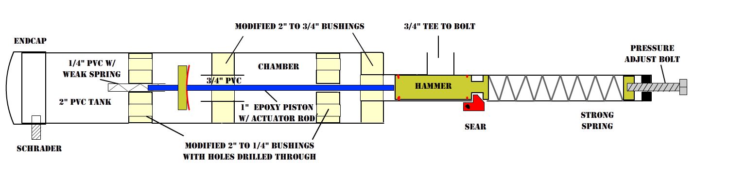

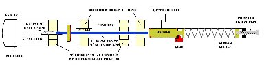

Ok, this is my idea. The hammer would hit the activating rod, which would open the refill chamber, charging the primary chamber. The hammer would be held from opening by a sear. When released, the piston would seal before the hammer releases the air in the primary chamber.
This way, the primary chamber is always fully charged, so there is virtually no delay between trigger pull and firing. The chamber would have enough time to fill, and there is no pilot air lost or air loss from the sear. You would need a heck of a sear to hold the hammer back, (OR a good spring) but that shouldn't be too hard, would it?
You think it would work?
EDIT: WHOOPS! The hammer looks like it is connected to the actuating rod, but it is not. I also forgot the refilling sear. See my next post.
My idea
My idea

Hailfire753, I'm not sure I understand how your above design works. It looks like the pistion is blocking the air passage to the barrel. I'm not saying that it won't work because i don't know, but I think the first design was better.
Hawkeye
Posts: 462
You would need to have more room for air to get past the rod as mentioned above. It needs to fit snugly at two points that so that it isn't rattling around, just not there. I'm not sure how you intend to actually fire this gun. Usually a hammer valve would just release the air. How exactly do you intend for the air to get out of that smaller chamber? It looks like you intend to "fire" the gun just to fill the firing chamber. What then?
If you are happy with a weak gun, just direct the air released right out the barrel through a T. No sense letting it expand uselessly into that smaller chamber.

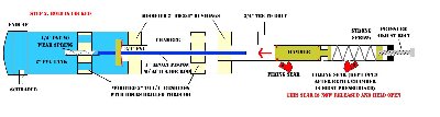

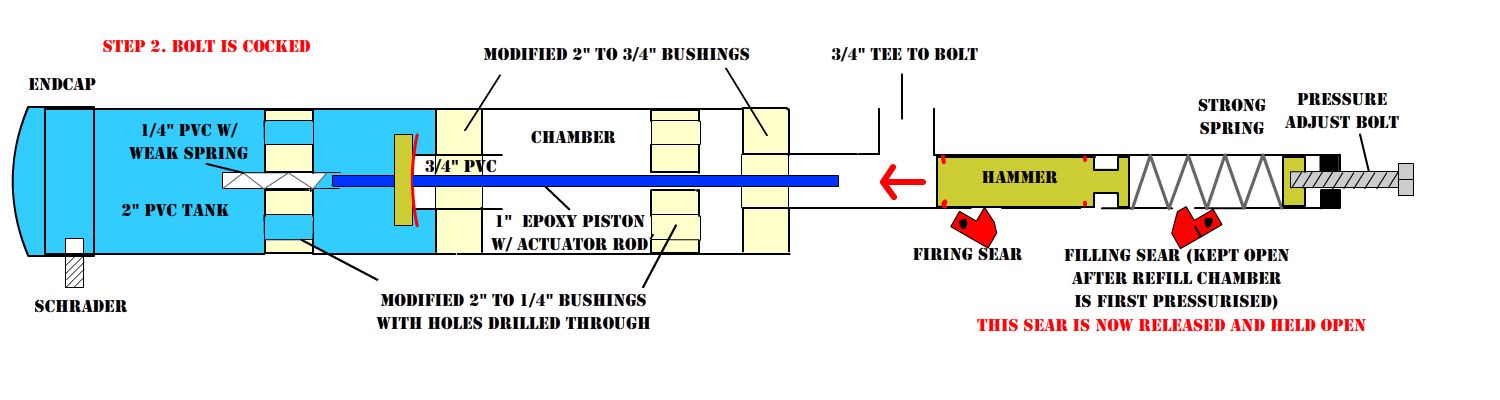

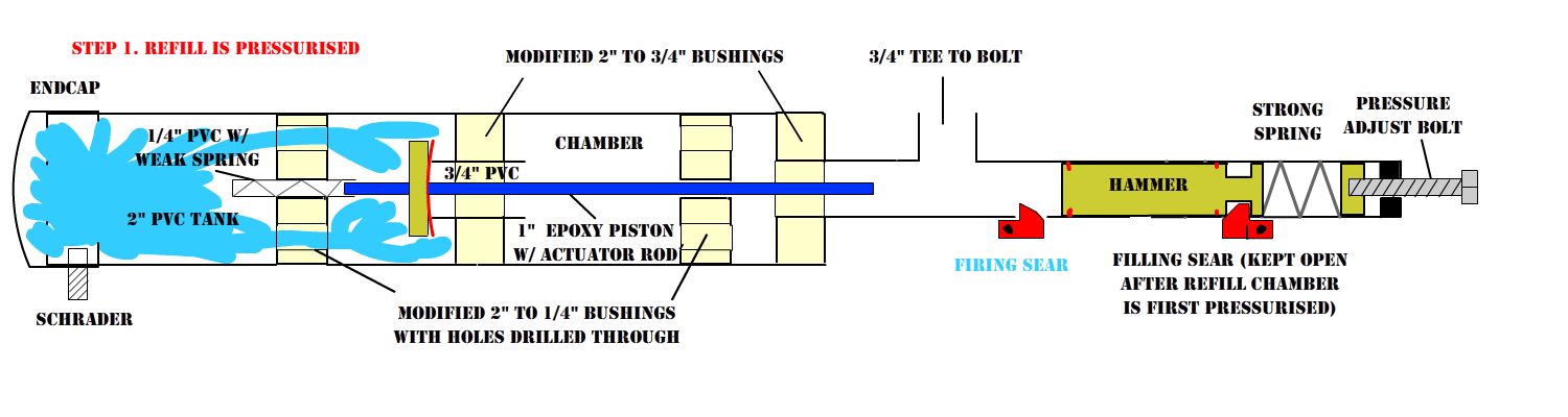

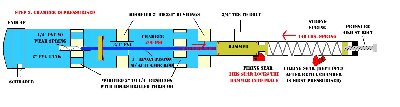

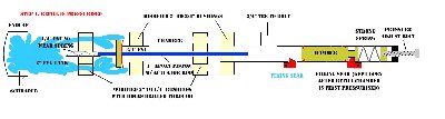

Opps, in the picture it looks like the hammer is connected to the actuating rod, but it is not. Also, I forgot the refill sear. The mechanism works like a paintball piston.
It goes like this:
1. The weak spring seals the refill chamber.
2. The refill chamber is pressurised.
3. The refilling sear is released, so the hammer slides forward. It is kept open so that the hammer does not catch it when it is cycled.
4. The hammer pushes the actuating rod, opening the refill chamber to the primary chamber. The firing sear catches the hammer and keeps it from cyclying open and reseting.
5. The firing sear is released, and the hammer slides foward from the primary chamber pressure. The piston re-seals from the air pressure and weak spring before the hammer opens. The hammer slides back enough to allow the air through the tee, to the bolt and barrel.
6. The hammer slides foward again, reseting the process. If the firing sear is held open, a high rate of automatic fire is achived. If semi-auto fire is desired, a mechanism is used to only open it briefly.
7. To refill the chamber the refilling sear is released and the gun is fired. The hammer would catch the sear, which would prevent it from cycling and opening the piston.

Hawkeye
Posts: 462
Still, why that smaller chamber? You're just giving your tiny burp of air room to expand and do virtually nothing. You also have to realize that you need to have quite a blast of air to push the hammer back and fire the projectile. It will run out so fast that the potential for even semi-auto will be limited to very few shots. It may still cycle well as pressure drops since the valve will be easier to open and should stay open longer which may regulate shots fairly well.
Hailfire753
Posts: 348
My valve is for a regulated CO2 paintball gun, so air is not an issue. The "smaller" chamber is the only chamber. Its like the piston chamber on the GB semi. The refill chamber is for exactly that, to refill the chamber for semi/auto shots. Maybe I don't understand what you are saying. Also, in the new valve, there is no "burp" of air. The piston stays open
