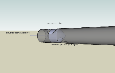

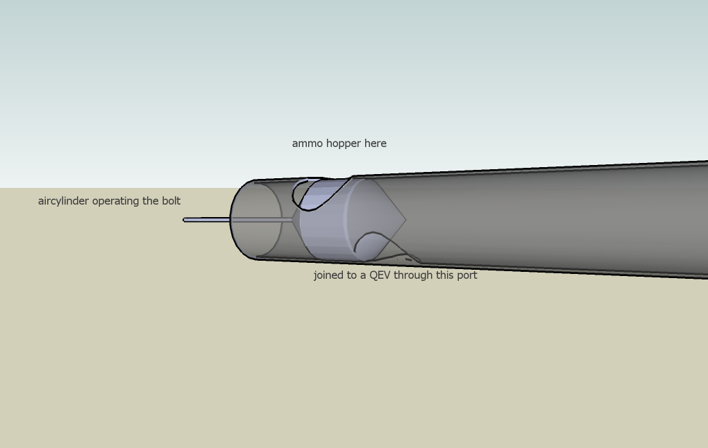

I want to improve the loading mech which IMO restricts the flow a little bit too much and is rather uncomfortable to work with (copper fittings suck!!)
well first I wanted to try a rotating bolt mechanism (basically a 3/4" Ball valve + a rotary air cylinder) but the mass (and cost) of most rotary air cylinders is too great...
so the idea is as follows:
the general design of the gun stays the same... it uses a reciprotating aircylinder and there is a 90 deg turn from the QEV to the barrel.... however, in order to avoid flow restrictions by having a flow-through bolt and to reduce deadspace I decided to use a solid bolt that slides inside the breech part of the barrel...
the barrel will have two ports cut in it: one for ammo and one for the main valve... when compared with the previous design ammo port will be closer to the shooter/behind the T and the bolt will push it past the 'QEV' port... and... that's it
I hope the pic will help to understand what I mean as it's rather simple (though I know that diagrams are very easy to understand by their authors but not necessarilly by others
any ideas?? comments, opinions ??

I had also concluded that a solid bolt is about as good as it gets to minimize restrictions and dead space.. soo I like :).
Obviously, the qev port must be slightly smaller than the ammo. I thought about drilling two holes maybe 2/3 barrel diameter side by side with a thin strip left between them for the ammo to ride on to prevent it from getting stuck in the valve port and not pushed forward enough. Only works without creating a restriction if your valve is bigger than barrel though.

Yeah, eliminating flow restriction from a drawing to components gets tricky. I was aware of flow restriction on a design I've been getting together myself. But now, I keep imagining a feed ramp opening or having the entire barrel move. It gets more complicated trying to keep the bolt from turning out of line, etc.
Looks like a great design there, on the new one, the pointy bolt should help feeding(?)..
