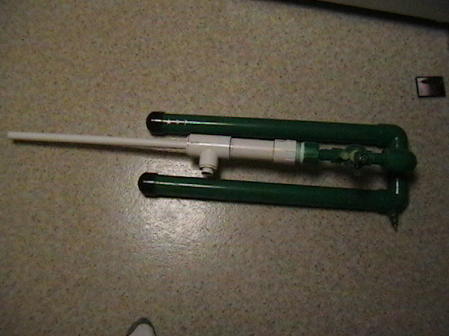

I built a barrel a few days ago for my pneumatic which is designed to shoot water. Its a 1.5"x2' barrel with 2" female threads to match my gun. Just behind the reducer is a 2" T. On the non barrel axis of the T is a reducer that attaches to a garden hose adapter. I attach my gun to my compressor and the barrel to my hose, sit in a chair in my front yard while my daughter and all the neighbor kids run around and wait to get shot, yes I said it,
I SHOOT CHILDREN... with water, lots of water... a 20psi shot shoots a 8' wide spray about 30', while a 40psi shot increases those numbers proportionally... have not tried anything higher than 40psi, but dont need to, my yard is only so big... my little compressor takes about 5 seconds to fill to 20psi, and the barrel fills about 2/3 of the way up, its great...

... still doesnt sound practical... plus mine can be shot every 5 to 10 seconds effectively... plus it shoots water, not steam/water mixed with super hot gases... Im gonna build a high powered water gun soon, using a hand bike pump which are sold at walmart, mounted on a small air tank, and a large water cylinder with a small opening, just a ball valve and a T with a clean out plug to fill the water cylinder with... ill stop describing in and just post it when finished...

not a bad idea, but rather than 3" to 1" reduction, I used 2" to 3/4"... It works great, but im gonna build a smaller chamber for my pneumatic that my current sprinkler valve will thread into... a chamber with a more efficent C:B, with my 2gallon compressor charged to 100psi I get 10-15 30' shots til the pressure has to recharge... oh and its semi automatic, just gotta wait a few seconds for the barrel reserve chamber to fill up... heres what my current set up looks like... the new chamber will be built in a week or two when my stimulus check comes in... the piece in the T is a 2"/3/4" threaded reducer which a garden hose screws directly into
