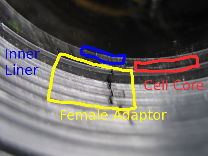

This failure is from a bad glue joint. Either the coupling or pipe was contaminated, the joint put together crooked, old glue used, or not enough glue was used. The joint blew apart. Only a small portion remained bonded to the coupling. The tooth missing from the pipe is still glued in the coupling.

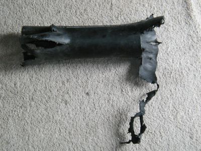

A pipe failure looks like this.
This failure is the barrel on an oxy-propane cannon. The page did not state if this was cellular core or not.
The original page is here;
http://www.sentex.net/~mwandel/cannon/my_cannon.html
This page is the one that got me to try pressure testing ABS Cellular Core in the first place. I like the failure mode over PVC.
I have not been able to find any ABS damage photos in a normal combustion, only exotic mixes. If you find a true pipe failure under normal conditions, please let me know.

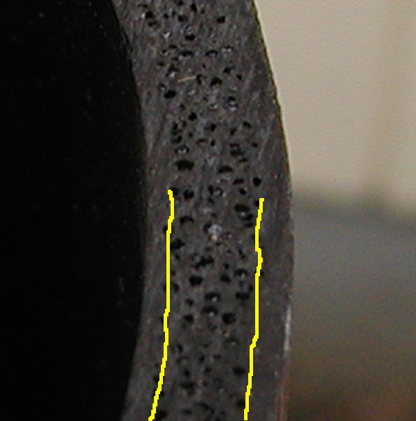

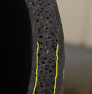

Do you have a photo of the label on that pipe? I have used both Cellular Core ABS and solid ABS. Solid does not have the 3 layer construction. Two layers of the pipe are showing in the photo. That pipe is Cell Core.
BRB.. I'll grab a photo of the end of a piece of Cell core for comparison.
