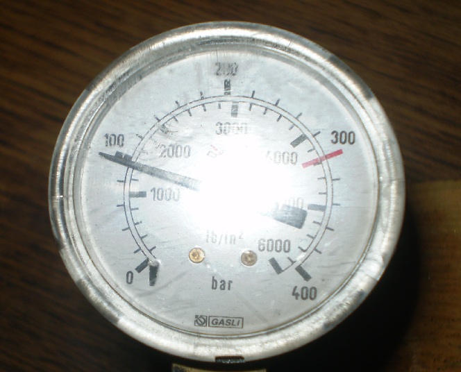

Do you really get 100 bar out of the fridgy?
Damn...I never ran it that far.I got scared at half that pressure!
yes ill upload a pic, the fitting most probably wont come off as its all hydraulic and welded onto the fridgy :D

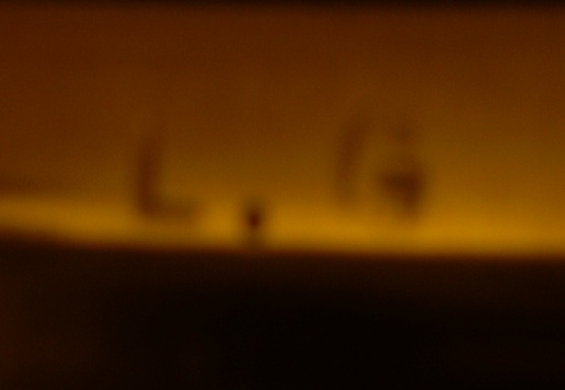

stamped my initials L.G but it looks blurry because the tube is so shiny, also im going to do the model number &amp;quot;0001&amp;quot;
stamped my initials L.G but it looks blurry because the tube is so shiny, also im going to do the model number &quot;0001&quot;

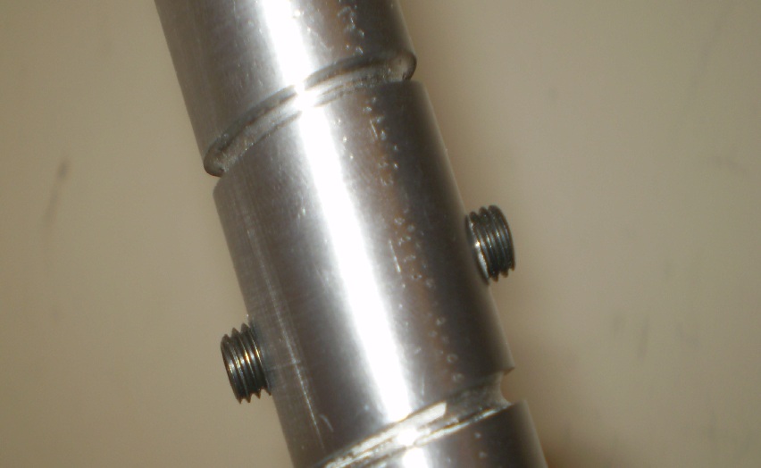

Grub screws, there long because there going through an aluminium action block aswell.
there Brian 100 Bar, had to turn it off just under because it shakes like crazy if the input isn't right.
daredevil!

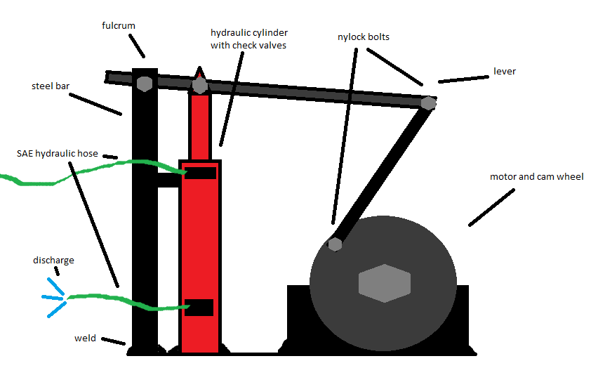

Im thinking of using a hydraulic cylinder and a lever attached to a reciprocating motor with 100 bar input to fill up-to 250 bar.
Diagram :)
not sure about motor torque?

Wow, Goats, that's incredible. 100 bar out of a fridgy? Over 1,000 psi right? Your hydraulic pump idea may work.

warhead052 wrote:Wow, Goats, that's incredible. 100 bar out of a fridgy? Over 1,000 psi right? Your hydraulic pump idea may work.
1500 Psi, i think the cylinder may work for water or low volume air.

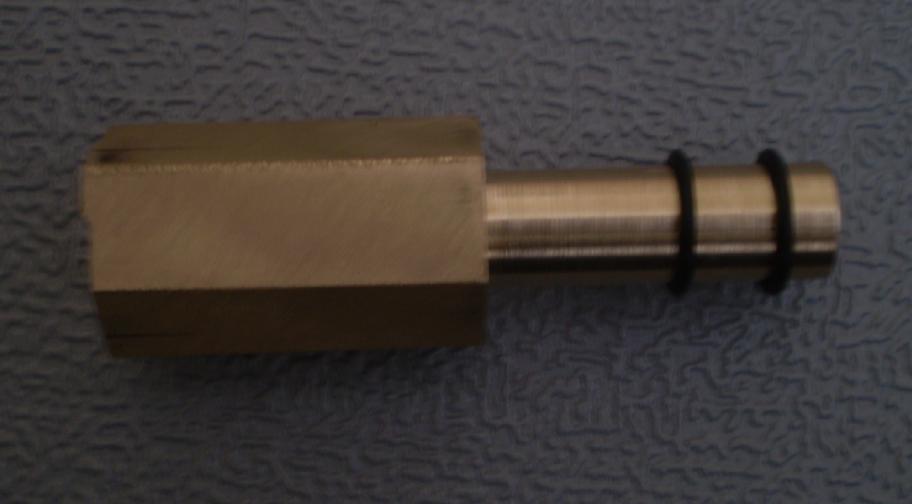

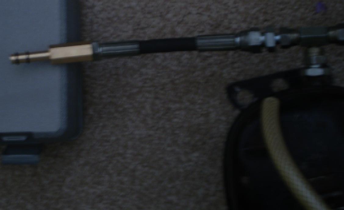

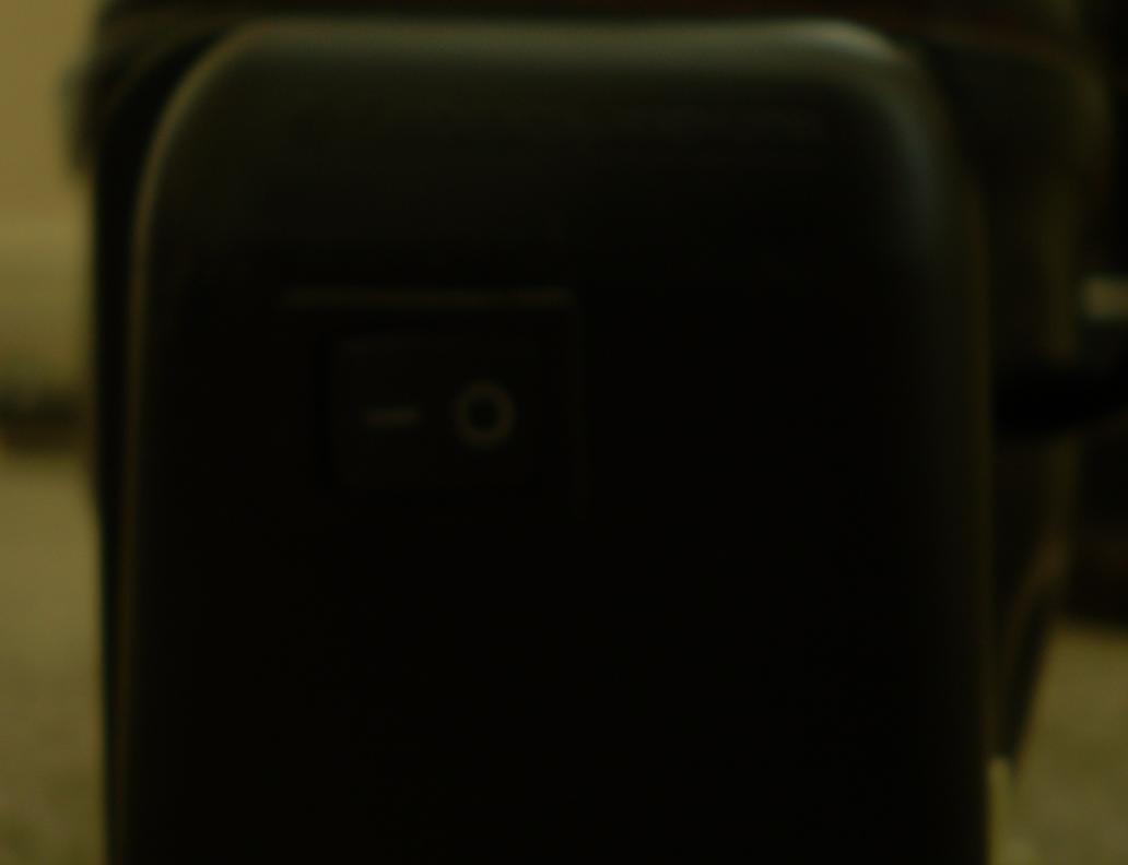

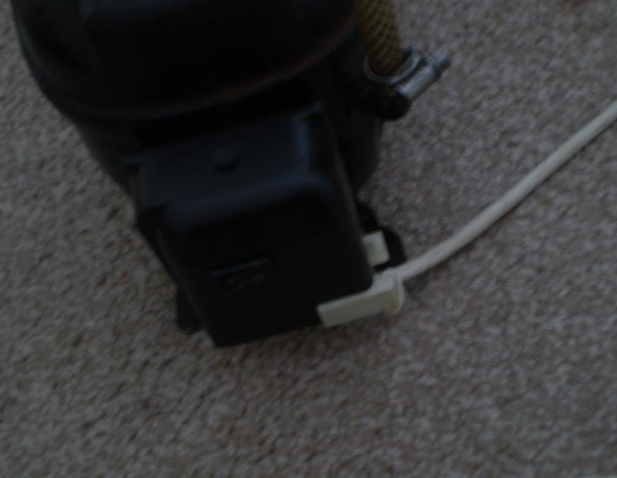

Sorry i haven't posted in a while, i have been really busy with other things, anyway i had some time today to do some machining, after seeing wyz's hybrid i noticed the "cool but ergonomic" fill probe, so i had a look at these and they seem stupidly simple to machine so i had a quick go, this will go on my fridgy which i installed a switch on the starting unit and removed all the unused wires, now it only has one wire coming from it and a switch mounted nicely on the rear. i only need to do the grooves
Attached to the fridgy
Switch
Switch
nice switch mounted in starter unit
Brass Fill probe needs o-ring grooves

Probes are a great way to fill IMO. I think you may end up having some trouble with extrusion though...o-ring grooves need to be deeper.
If you haven't already done so, remember to vent the hole to prevent blow out if/when you get a nicked/extruded o-ring. The vent hole should be at least the same size as the oriface in the probe itself.

I agree, my grooves are deep (covers about 80% of the o-ring).
Still so you better vent it first then remove it.

i havent cut the grooves yet i had no time and had to go for an emergency, also im having a problem with my valve insert, when i push it in the tube it gets cut in the holes ( burrs )

Just to clarify...by "vent", I'm referring to a "through" hole where the probe is inserted. Failure to provide pressure a place to dissipate in the event of a leak will cause the probe to be ejected...possibly with some real force behind it.
It SHOULD go without saying that the fill line should be vented off before removing the probe as well.
i haven't cut the grooves yet
I suppose you really DO need to make them deeper then. :lol:

:D im cutting off the burred part and doing it like the one in your pic.
