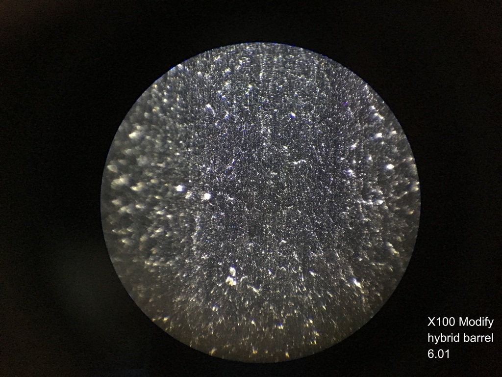

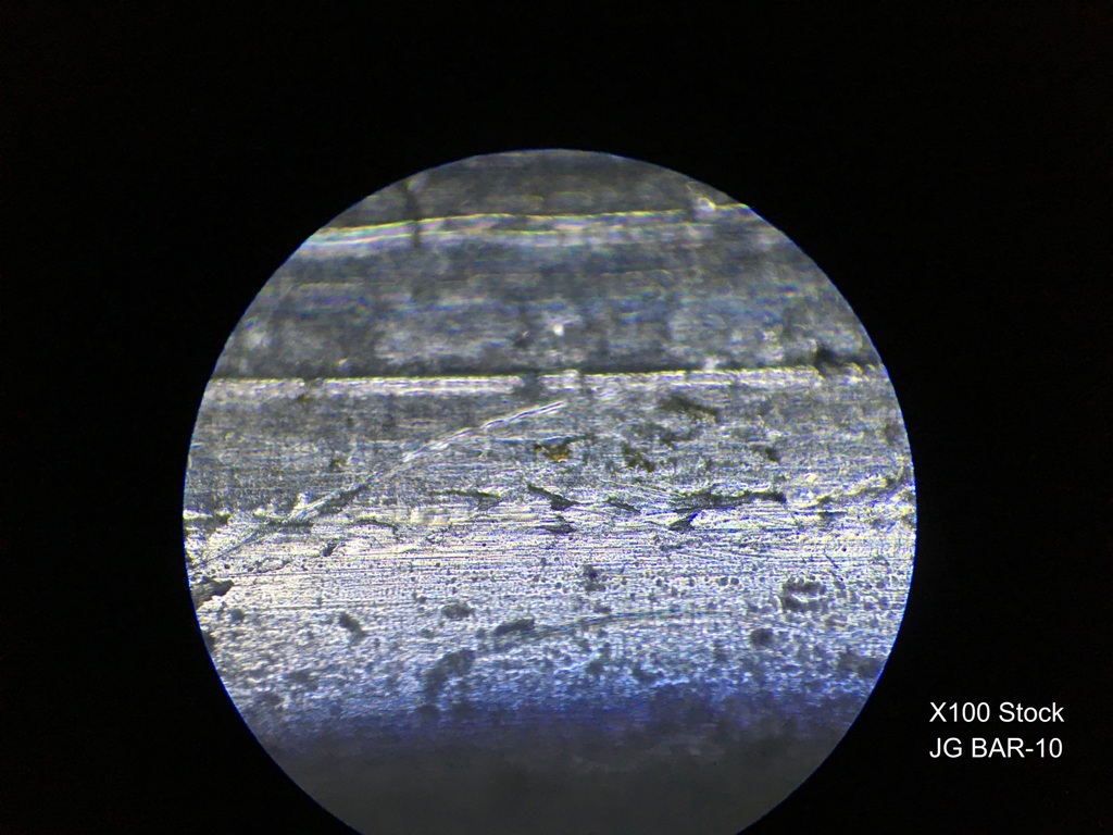

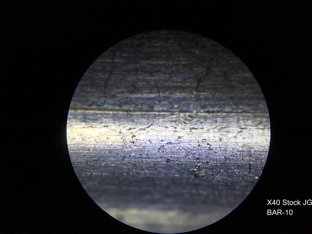

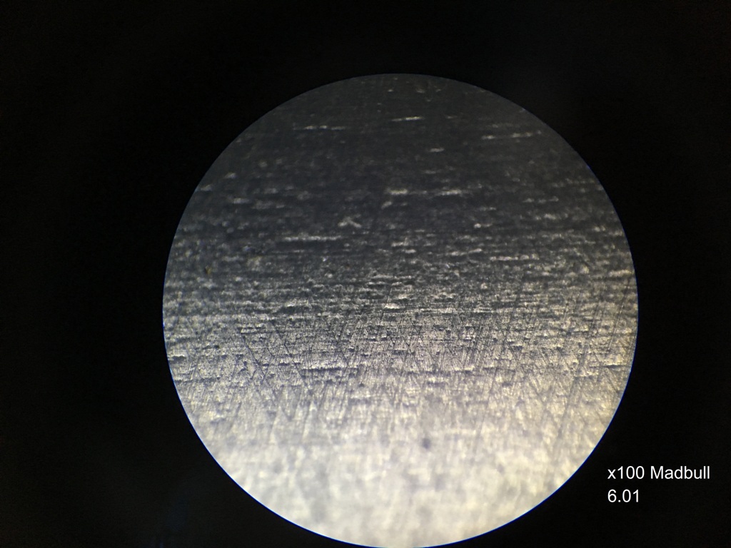

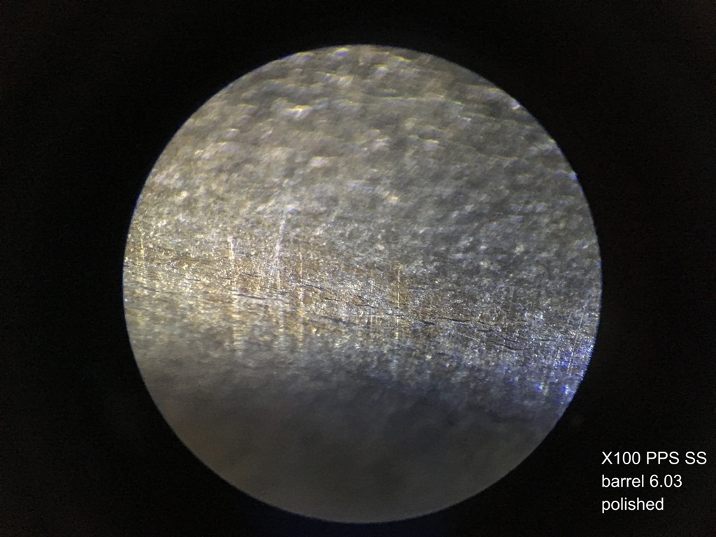

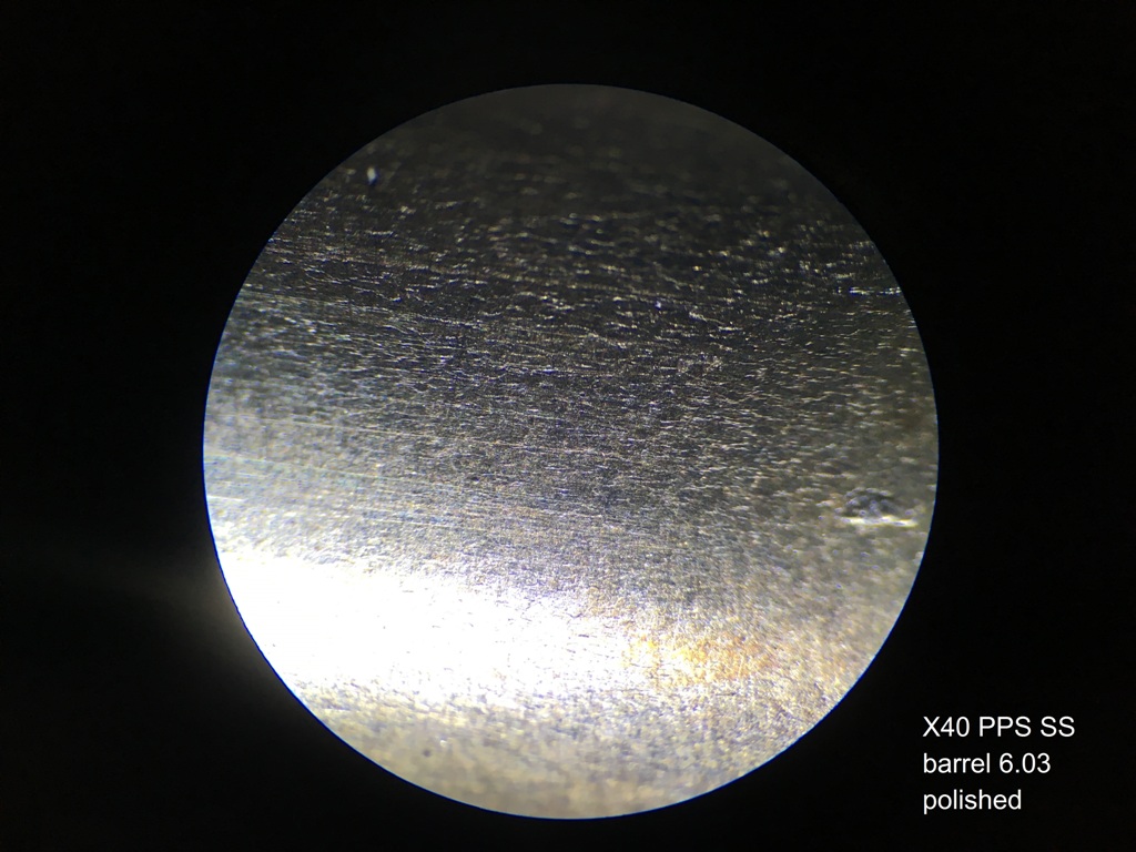

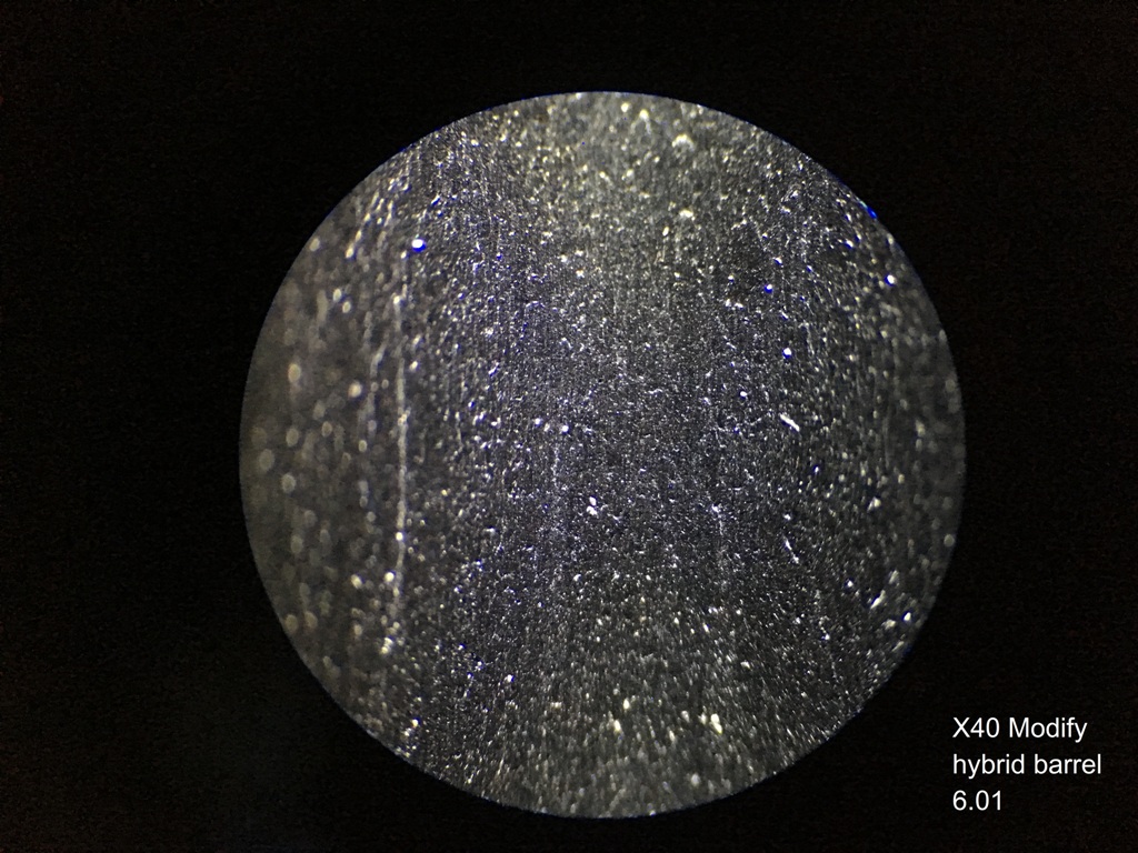

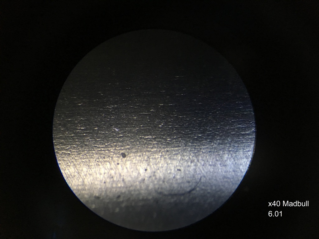

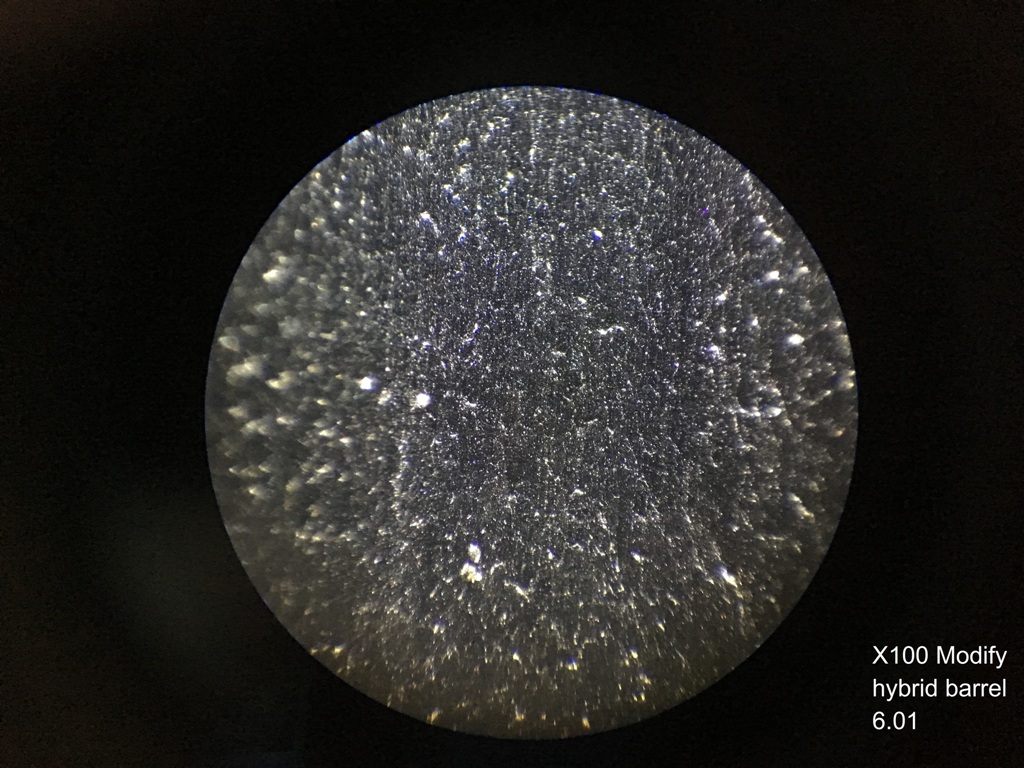

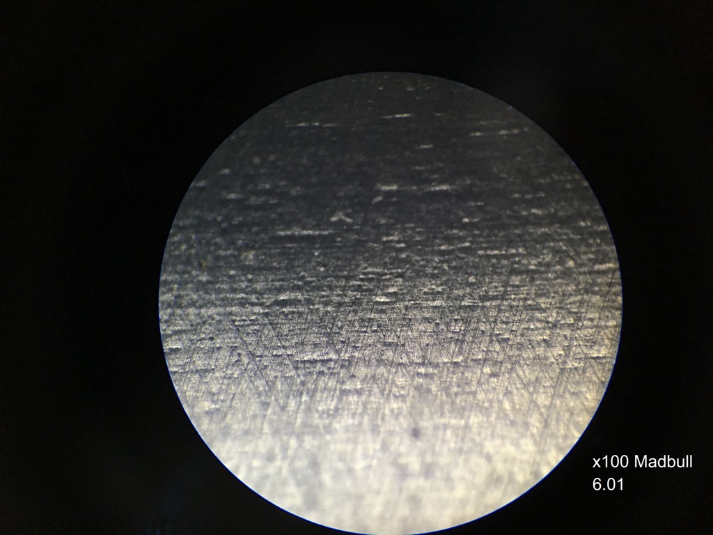

So I have digged deeper into airsoft barrels in general, through some relatively scientific methods.
First I saw a video on Youtube, the guy was saying polish barrel with a drill leaves a spiral scratch inside the barrel and was promoting a "polishing kit", basically a semi guided rod that you push and pull inside the barrel so no circular movement. Pretty bullshit to me as in college I polish metal all the time on rotary polish tables and after the final polish is scratch less even under microscopes.
However we did have 1 micron diamond polish solution and fancy fabric to use. So I decided to check if with a fine cloth/lens clean rug plus fine car polish can achieve a decente finish. Also I wanted to see if it does leave scratches.
To be able to compare, I cut several barrels in half, all stock, to see what they look like under microscope. I managed to use my dads microscope to take photos at 40x and 100x. It's not as good as I'd get with a metallurgy microscope but definitely good enough after some DIY led lighting.
The barrels are: Madbull 6.01 aircraft grade aluminium, Modify 6.01 hybrid barrel (worst barrel EVER), WE stock brass barrel (will add photo later), JG BAR-10 stock aluminium barrel and a 6.03 PPS SS barrel (polished with my method).
The BB could also be a factor so I picked a mid range BB and took photo at 40x and 100x as well. The surface finish is surprisingly good, good enough to be irrelevant compared to the barrels inner finish.
However I do plan to at least try to compare a lapped barrel and a drill polished one to see if lapping in airsoft is indeed working. I'm working on a universal barrel test launcher as well to do all the comparisons.
Sorry there isn't any high end barrel here, ain't rich enough to cut a Laylax/PDI
