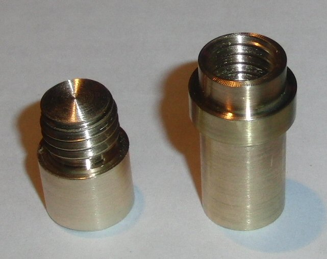

Tailstock is sliding nicely but no joy with either end of the die. Diameter is 11.70mm
How do you chamfer the end to help things?
I don't. :?
I've threaded lots of rods the way you do it, before I bought the die support. No obvious reason it does not work.

Did you get a decent quality tap and die set? Even low quality should handle brass but you never know. Also if starting the thread is the only problem make the part a little oversize then part off or cut down the crappy part Of the thread
And are you locking the tailstock or sliding it by hand like lemaudit said? If not it won't thread correctly
Edit looking at your picture I think the piece you are threading is too large in diameter for the die are you sure it's the correct die?

jor2daje wrote:Did you get a decent quality tap and die set? Even low quality should handle brass but you never know. Also if starting the thread is the only problem make the part a little oversize then part off or cut down the crappy part Of the thread
After some discussion with LeMaudit, we came to the conclusion that:
a) my tap and die set is the product of defecation
b) 1/2" or so threads is around the limit that can be cut using the method described.
It's not locked, I was sliding it by hand.
Yep, 12 x 1.75 - LeMaudit tried to do the same with a 1/2" die and had similar results. Or at least he claimed he did, in order to convince me to buythis and further his commision with Sherline ;)
I did manage something better though, starting it off on the "wrong" end then manually continuing with the tapered end while the part was clamped in a vice, using white spirit as cutting fluid.
Bedtime now but I'll give the proper part another go tomorrow. Any objection to threading before drilling the central hole?

Milk does work on copper, but I suggest you use it in a well ventilated area. I nearly vomited last time. Then I resorted to rather ridiculous speeds, carbide, and plain water as lubricant.
For future threading, you could lock the tailstock, then use the ram to force the die holder against the workpiece.
Tried that, didn't work :(
Going to give the part another go.
edit: not too happy about the thread, major diameter is 11.1mm and I'm pretty sure I hadn't turned it down that far... hmm. Anyway, part done. ish.
