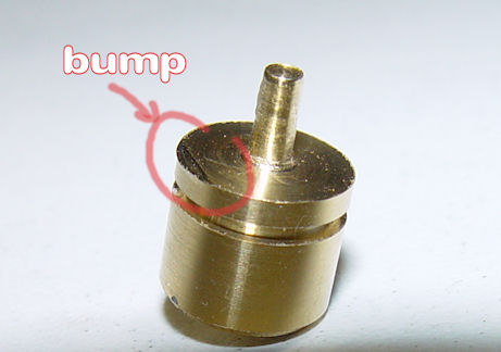

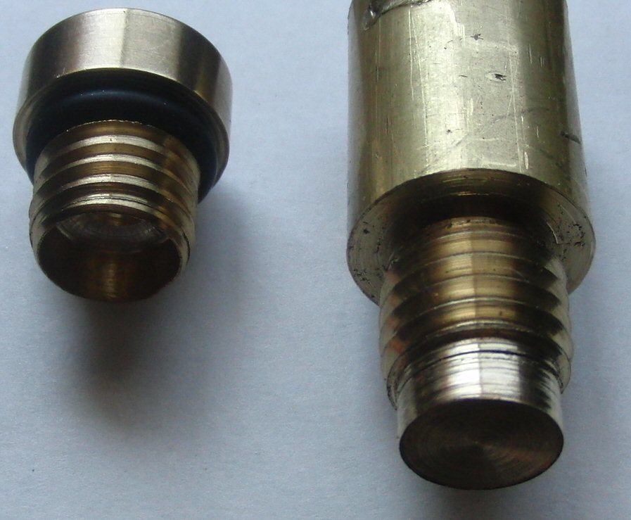

JSR, just to ease your pain about redoing work...
me too I had to redo this piece... look, there was a beump on the edge.
I first wanted to hold the piece only by the little rod onto the chuck... it was not long enough and the piece get loose and was stuck between the tool and the chuck.
Please also note that the fact that this mistake was not preventing the piece to work nor was visible inside the aluminum cap is completely irrelevant :D

LeMaudit wrote:me too I had to redo this piece... look, there was a beump on the edge.
I can just picture that :D
"Sacrebleu, une beump!"
*bins*
That clarification was far from necessary :)

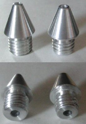

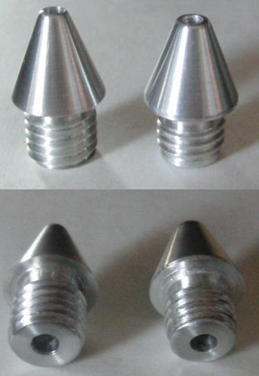

Anyway, redid the nose part, this time I made the thread first, now much more crisp, and made everything else around it. Still not perfectly concentric but better than my previous effort, and the correct length too :)
Sacrebleu cannot come close... in fact if I remember well what I said was in Spanish and involving one's mother.
:? I'll never do direct TV show :lol:
Good job on the redoing!

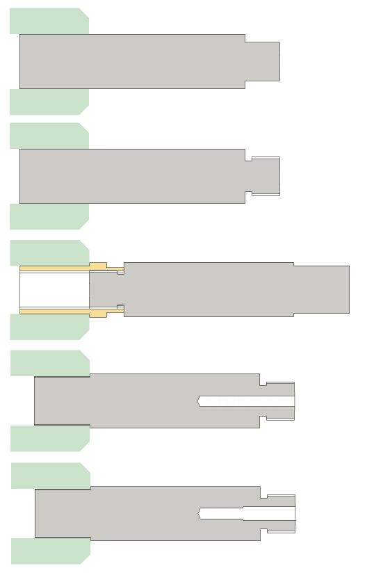

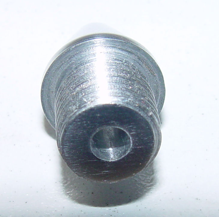

Just to be sure, when you say it is not concentric, is it when you screw it in the brass piece? Or looking at the bottom? Because it is normal the bottom is off center, due to the thread. Also, hand made threads are never perfectly concentric, this is why my body's step turn everything down to the final diameter; nose, plug and body. That way the concentric errors are canceled ;-)
I HAZ A BANG!
LeMaudit wrote:Sacrebleu cannot come close... in fact if I remember well what I said was in Spanish and involving one's mother :?
The thought of Jacques Clouseau uttering "Me cago en su puta madre!" is as amusing as it is disturbing :D
Thanks :) but still not happy with it. Do Sherline pump gaseous perfectionism into their packages before sealing them?
Screwed in the brass piece, the centre hole wasn't concentric. I tried to avoid it with the following cutting plan but it doesn't seem to have worked :-/ As far as I can tell the theory is sound, cut the thread, use it as the new centre reference in the brass part and turn down everything around it - I think I'm cutting the ali too deep/fast and it's knocking it off centre in the chuck.

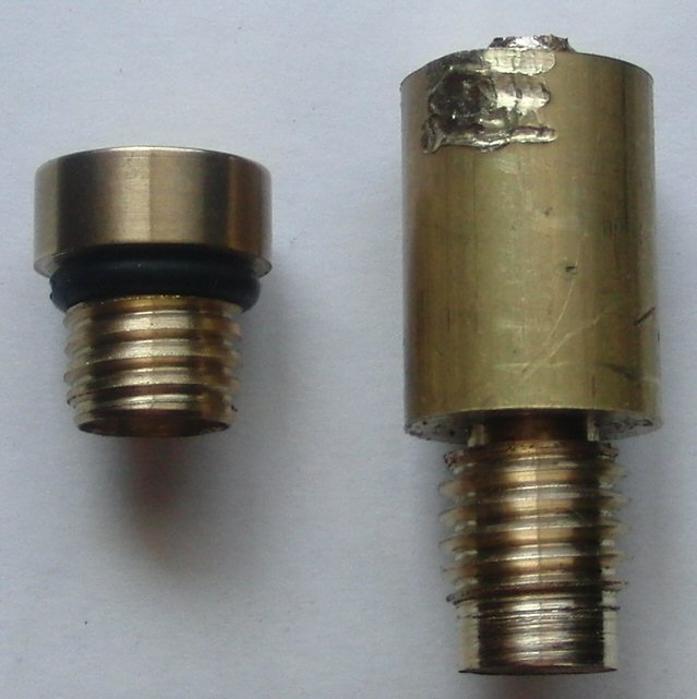

update: was going to start the body but since it is so dependent on the endcaps which I'm not too happy with, so I'm remaking those first.
Here's the endcap first stage, cutting the thread. Note that it's much better cut that the previous one, and that I added a 5mm extension (which will later be cut off) turned down to the thread minor diameter to help keep things centred and make the die bite more easily. Note also the marks where it was held in the vice and how tightly it was held in order to cut the thread without slipping.
