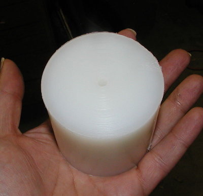

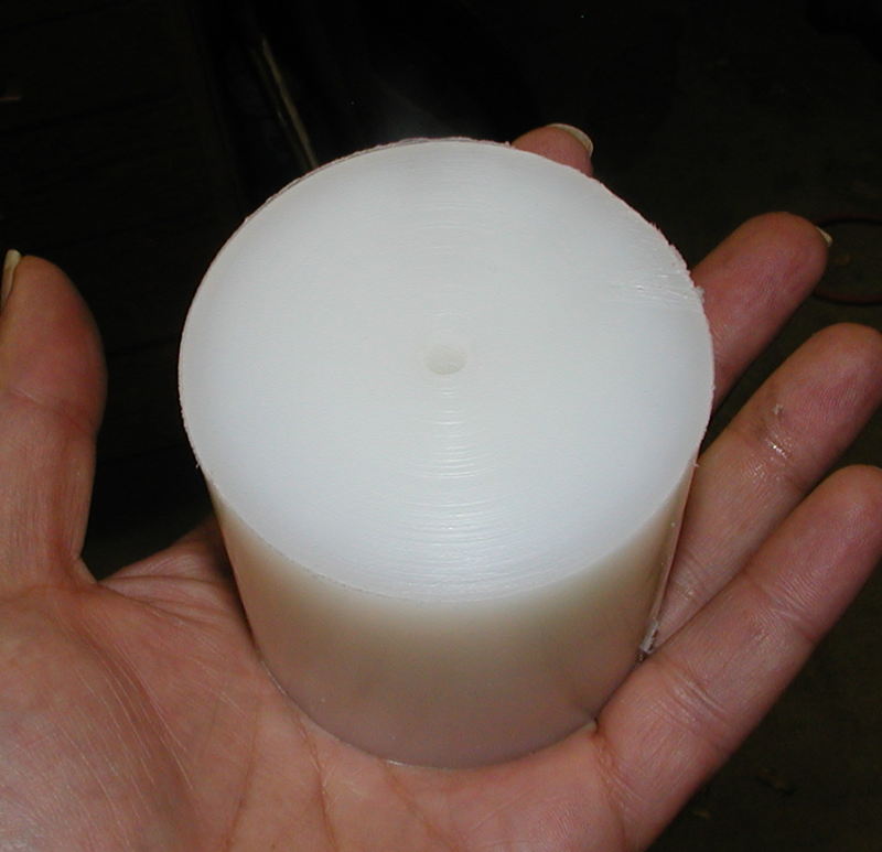

Update, the 2-1/2 UHMWHDPE round stock is too big to fit 2-1/2 inch SDR21 160 PSI PVC Pipe. I just tried it.
This does mean it is big enough to machine down to test rounds that fit like a glove. :D
2-1/2 UHMWHDPE round stock.  I was given a piece.

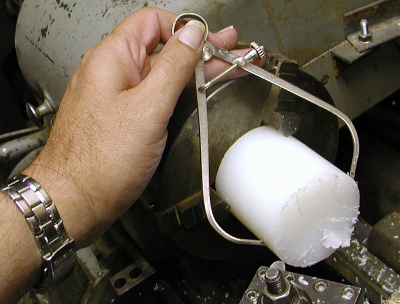

Preparing to trim the end in my dad's lathe

Tech, our large 21" lathe has a 3.5 inch through bore. That material will go through and be machined nice and dandy :D Here it is posed with Grock's 4" piston.

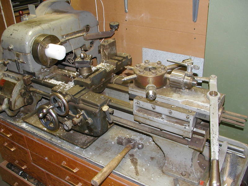

@Jagerbond.. Nice lathe. It is big enough to do engine blocks. My dad's is configured to make production bolts, screws, flanges, etc. It is much smaller. If my memory is correct it has a 8 inch swing, 36 inch bed and just over an inch through the headstock.
Instead of a regular tailstock, it has a 6 position turrent so repetitive operations can be rapidly repeated. I'll post a photo when I'm at home on the other computer. As a thread cutting lathe, it has the compound gearing, six belt selectable speeds (2 on motor and 3 on the jackshaft) and a full gearbox selector for carriage advance speed/threads/inch. Included is a set of gears to switch to metric.

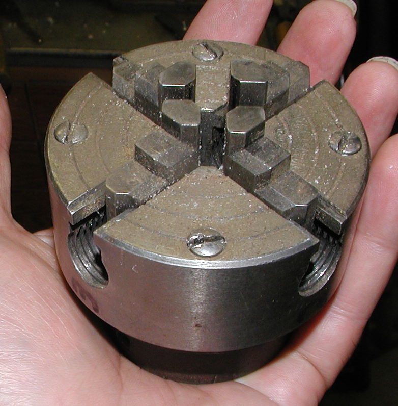

For excentric jobs such as cams, he has the 4 jaw chuck.
I asked him what he paid for it. Man has inflation run up prices. He bought it used in 1961 for $300.
Edit; Added photos of lathe and 4 jaw chuck. This one is either 8 or 10 inch swing (I don't remember) and has a 1 inch through bore.

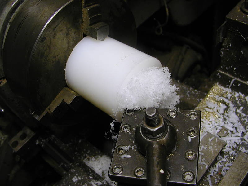

Facing rough cut end of 2-1/2 inch UHMWHDPE stock to show the size of the 3 jaw chuck.  This chuck is much smaller than the one at Shureshot. :(
This 4 jaw chuck and be screwed on in place of the 3 jaw chuck.  Each jaw is individually adjustable to hold odd shapes and off set stock to cut cams.
My Dad's lathe.  Configured for production cutting of bolts, etc.  Turrent tailstock and leadscrew transmission for most common thread pitches.
