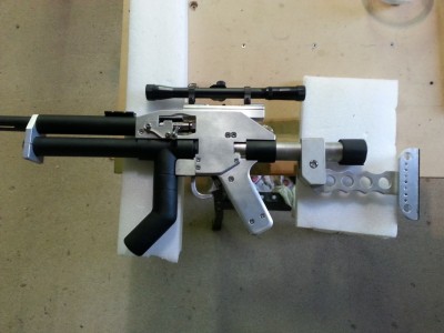

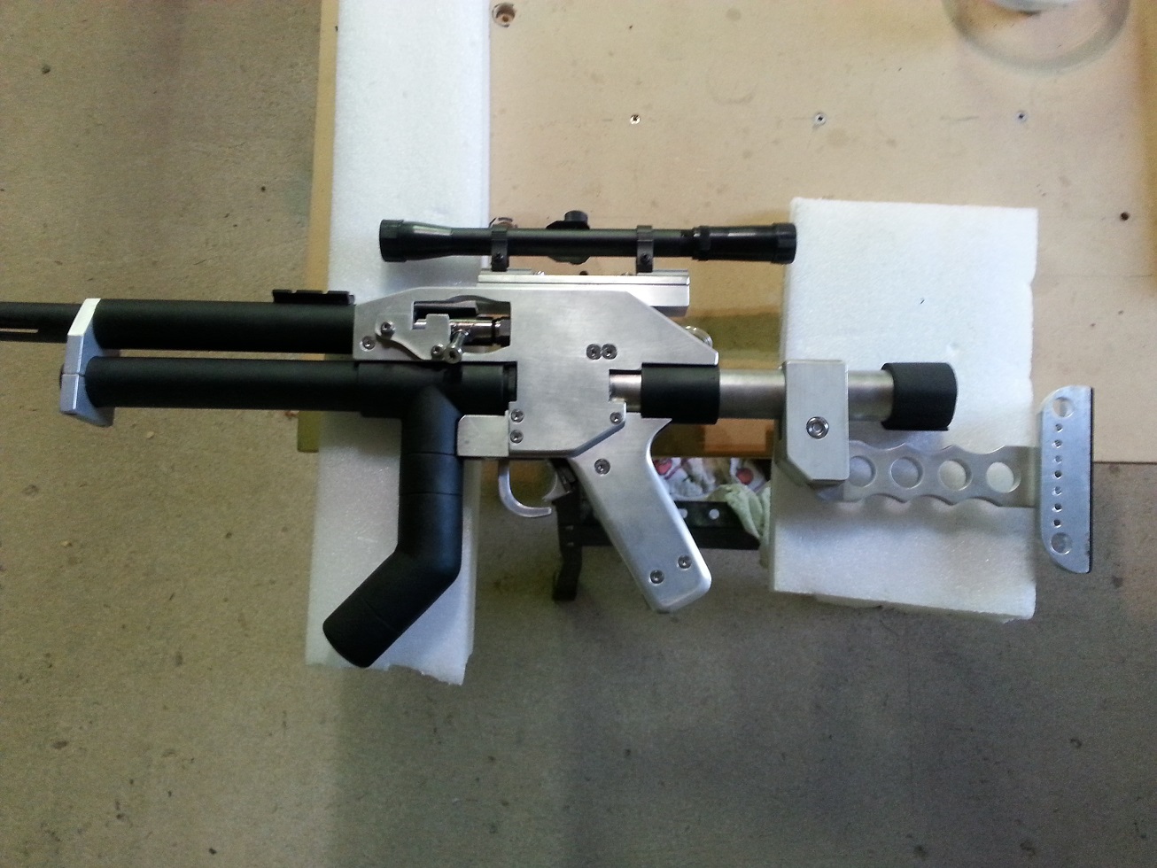

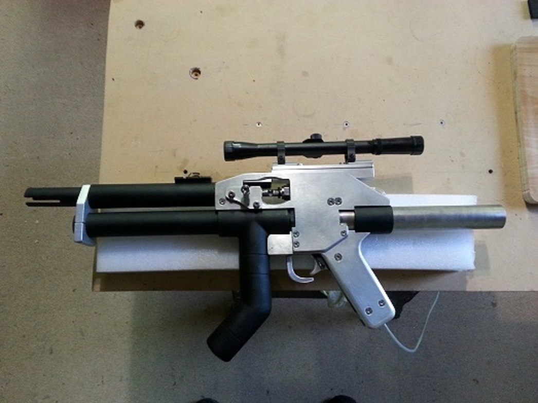

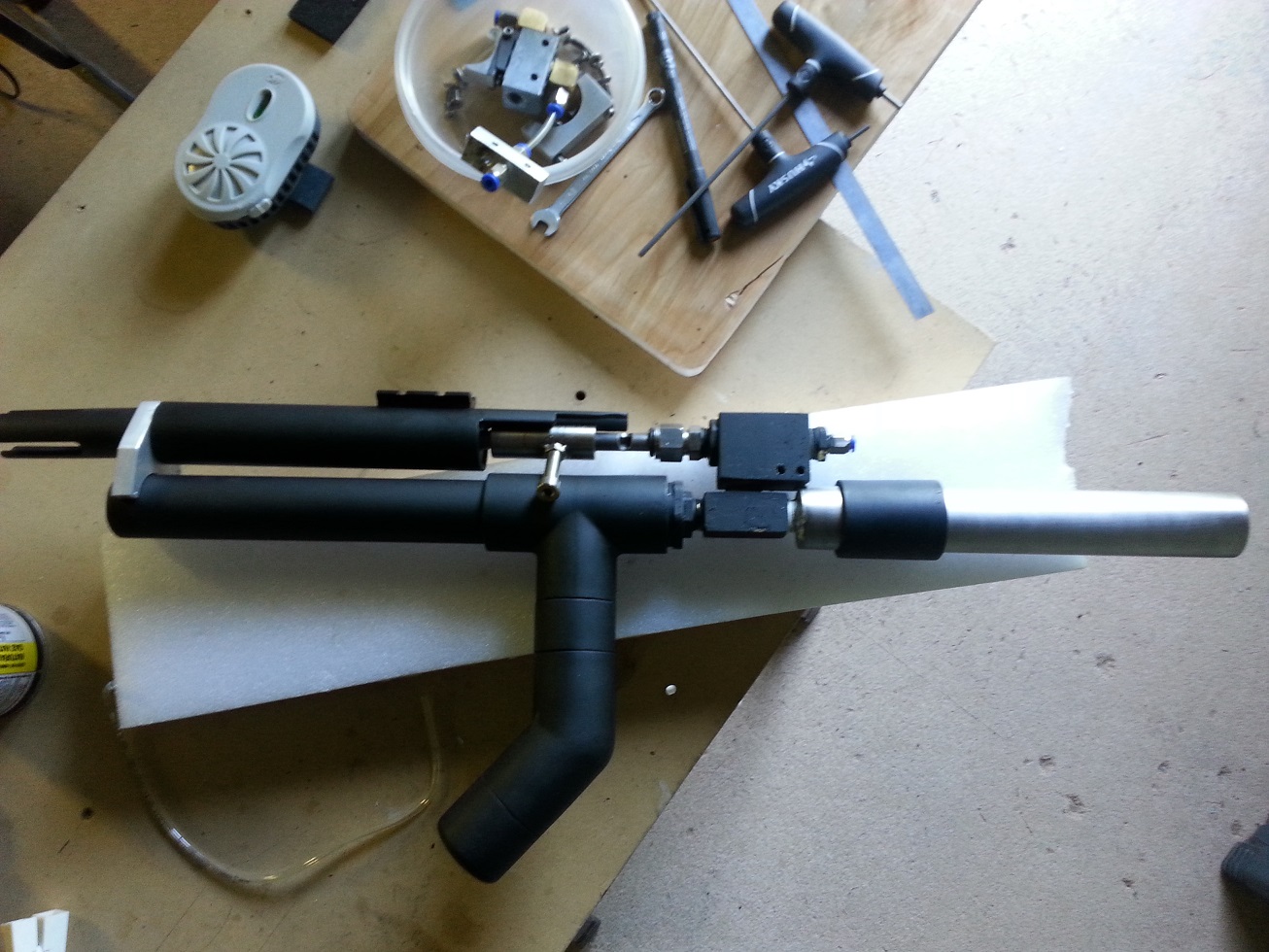

Stainless steel chamber upgrade work, the original PVC front part of the chamber is plugged off, will be doing a chrono test soon as well.

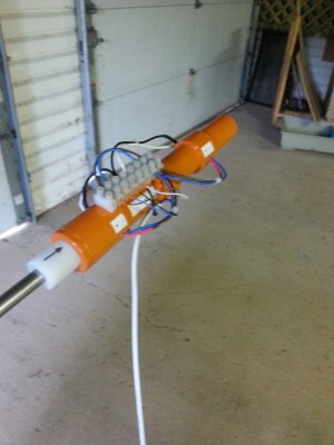

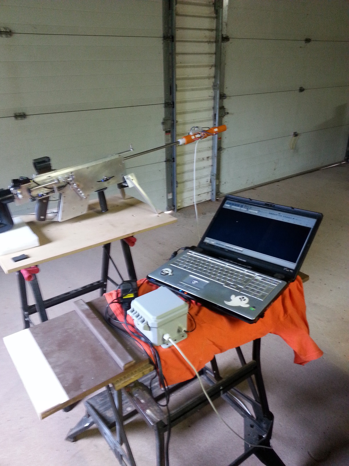

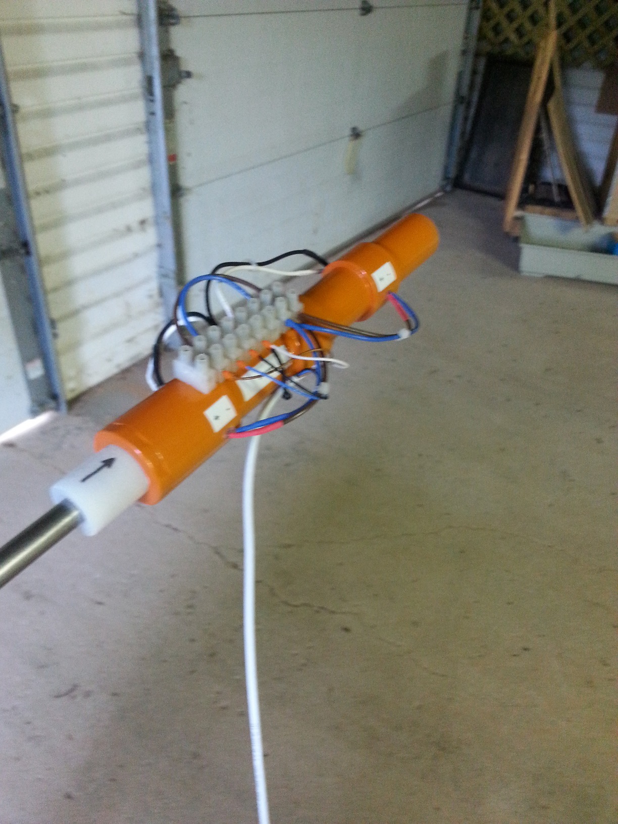

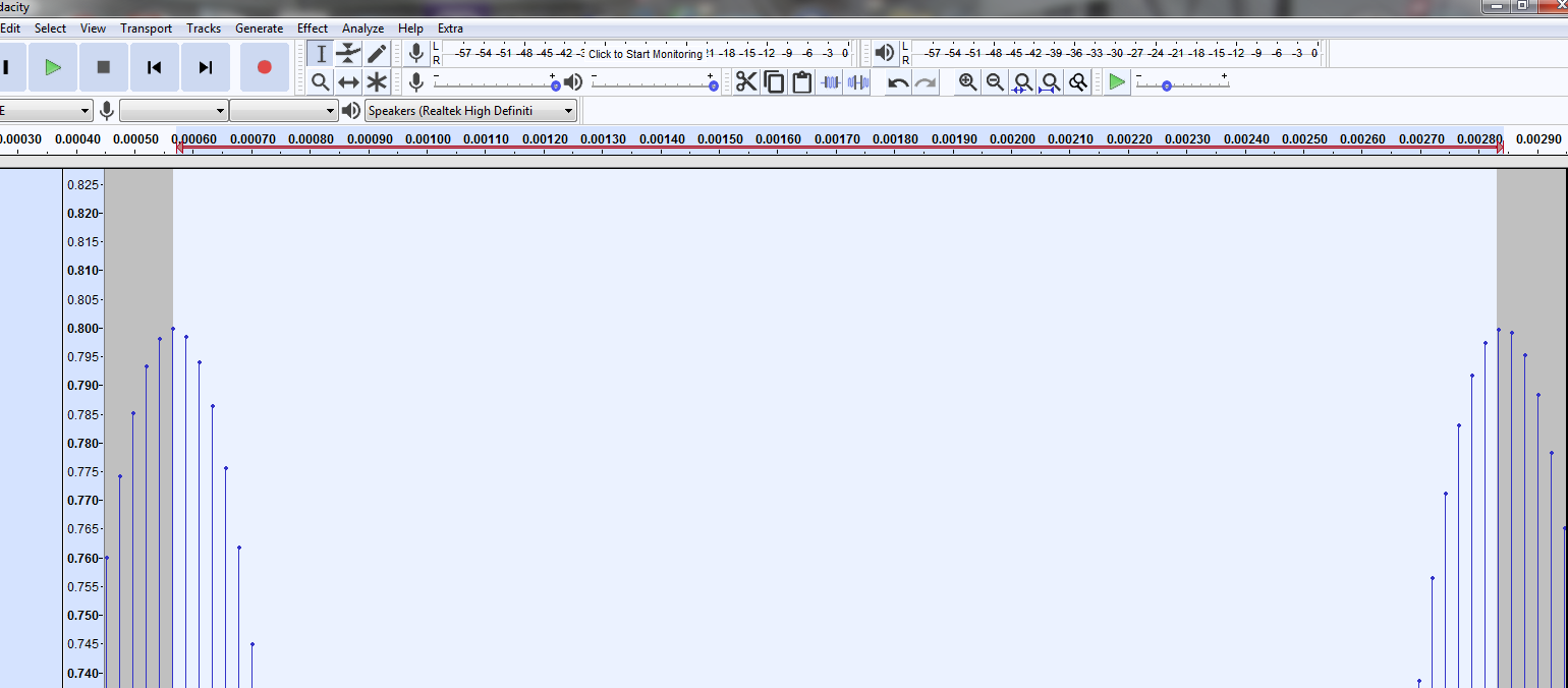

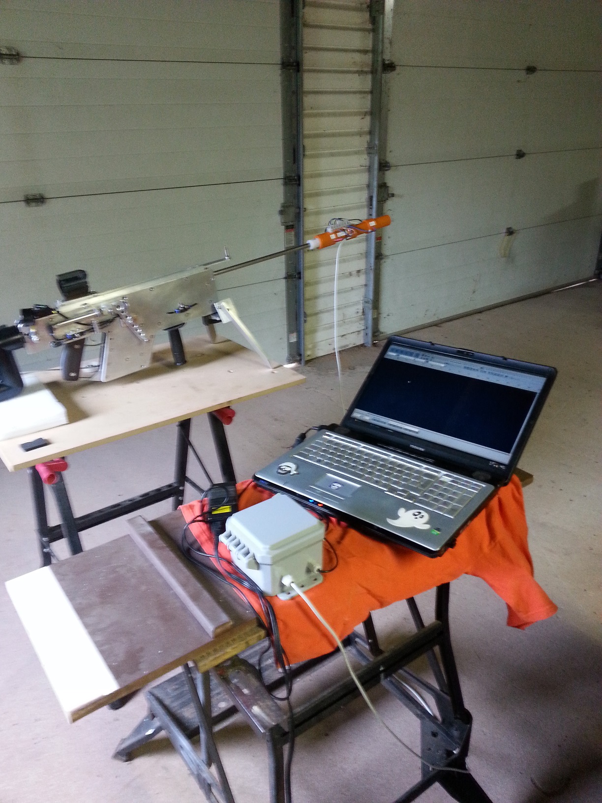

Did you build your chrono ? Looks like you were going to make one the same as I did (Jimmys), I used 2 pairs of 5mm photo emitter/receiver diodes (Ebay) spaced at 6" (0.5ft), powered by 1.5Vcell in the junction box. It works well and is consistent. I am using Audacity to capture the trace, it is tricky to read the spacings though, might try and look for another program with higher resolution.

Looks like Audacity is as good as any, I think if I cut and paste the selected pulses and use maximum zoom it is easier to read, should get to test a couple of air soft tomorrow hopefully.
This is sort of what I get

Did the chrono test with 0.2g,
150psi = 694fps
160psi = 706fps
So looks like around 700fps with the pressure I can safely give it, that seems pretty good :D
