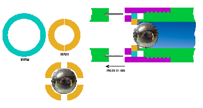

Wait... I think I've heard this before...jackssmirkingrevenge wrote:an idea in the shower combining balls and ring

I was exited by a design for a seal made with o-ring, and at the same time positively locked, typically for a large ball bearing projectile.

For me... no way I would manipulate a small cylinder under pressure with a projectile that is not positively locked
I want to be able to drop the thing... and feel safe about it... cause I will drop the thing

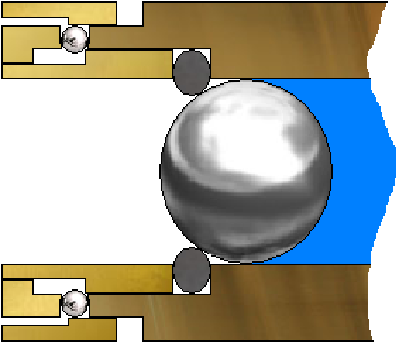

As LeMaudit pointed out I've already done this, both for pneumatics and hybrids (on your suggestion!)POLAND_SPUD wrote:Ever heard of a process called swaging ? I think something like that might work...
Here's my idea from yesterday, the ball detent holds an internal tube that keeps the o-ring compressed...
- Gun Freak
- Lieutenant 5
- Posts: 4971
- Location: Florida
- Been thanked: 8 times
I don't think that's a good idea... Doesn't seem fool proof enough to me.
I'm pretty sure it could work, using an o-ring detent compressed by a threaded fitting it's possible the fire a blocked projectile by loosening the thread thus reducing the compression on the seal.Gun Freak wrote:I don't think that's a good idea... Doesn't seem fool proof enough to me.
Still, too complex for my liking.
It certainly could work, but it have not this 100% safe feeling I seek... for that reason it seem to me overly complex without any gain (...jackssmirkingrevenge wrote:I'm pretty sure it could work, using an o-ring detent compressed by a threaded fitting it's possible the fire a blocked projectile by loosening the thread thus reducing the compression on the seal.Gun Freak wrote:I don't think that's a good idea... Doesn't seem fool proof enough to me.
Too much pressure, or a o-ring that crumble/tear-off will result in a projectile that shoot unexpectedly. With a positive lock in front of the projectile, as a brass ring or several small steel ball like a quick coupler, it will not.

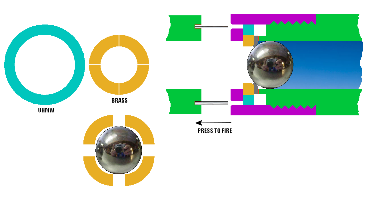

Here's my best try.
The rubber washer could be replaced by a o-ring... but I feel this will have more chances not to be ripped-off by the air flow
The UHMW ring could be replaced by a few small steel balls to limit friction, but it will then need additional design to keep everything aligned.. little grooves, etc... it's much more work in term of number of machining operations
The same design should work with many kind of projectiles, if they can seal pushing on the rubber under pressure. And I'm pretty sure I could make that design to fit any size, from lead pellet to airsoft to .50 lead bullet. The only difficulty could be to find a perfect sized rubber washer, but that could be mold in RTV rubber quite easily in quantity.
I'm quite happy with this one, it answer all my 10 points, except maybe the 9- minimal force applied to firing mechanism.
UHMW is quite slippery, it is used to do low speed bearings. So maybe not much force should be applied to slide the ring back. If not, small steel balls will need to be used.
What do you think guys? Anyone with experience on UHMW friction under pressure?
