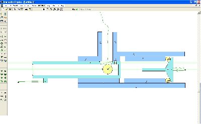

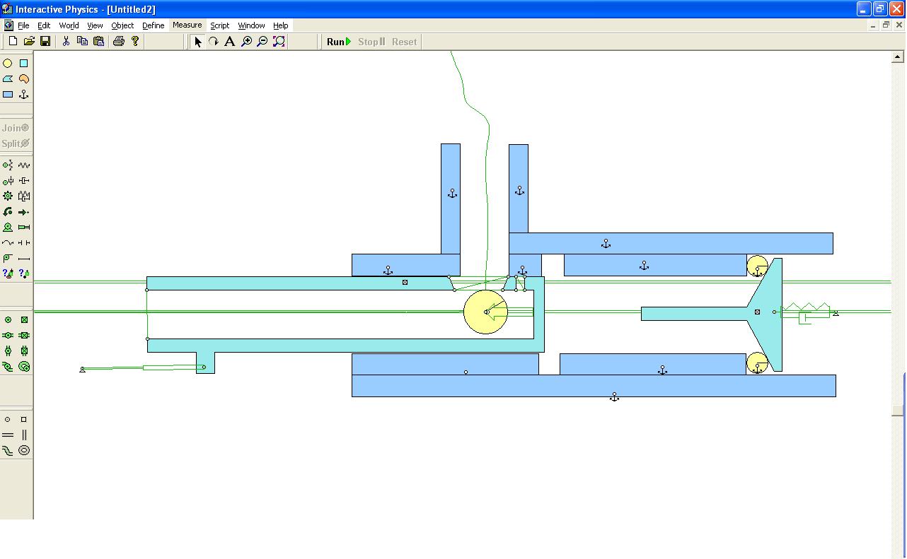

nsane-spuds wrote:I was thinking how it could be possible to acomplish full auto with your desing while keeping it as simple as possible and I came up with this... What do you think?
Hey thnx for drawing it out and bringing it here! Its a very good idea, I have been drawing it on paper but I dont seem to get a good breech/loading system. This way it could be automatic yeah, but I experienced that it cycles way too fast. So yeah getting the balls in the barrel is next. If I have time I will try to make something like on your picture but then without a loading hole''. The problem is that for everything to be balanced out the pressure has to stay constant (within 0.5 atm) to reload and as the barrel has a smaller area then the valve it makes a even smaller margin. I work at 8atm coke bottles so I cant achieve constant pressure''. So yeah we will work on this.
Here is a screenshot of this program called interactive physics. I use it to visualize my ideas, as though it doesnt always work very easily.
FordGtMan wrote:I'm with nsane, even with the diagrams i cant figure out what is pushing the barrel back after each shot. Someone help me... :oops:
My gun doesnt really cycle itself back, u have to do it by hand. Nsane drew out this idea of an automatic reload working. I guess I cant call mine semiauto then.
nsane-spuds
Posts: 41
Joined: Mon Jun 19, 2006 4:45 pm
Wow, this program looks very interesting... can it simulate air pressure?
Well, to get the bbs in the barrel fast enough, we could use a spring loaded magazine but, it eould run out of ammo rather fast... so maybe we could use a airsoft hi-cap mag... some of them hold up to 600 bbs.
The only thing that I am really worried about with my desing or with anny full-auto is that it will empty a coke bottle really fast ( I think) so... Im thinking of buying my self a co2 paint ball tank and a regulator, my freind is willing to sell me his set up for 40$
Antonio
Posts: 508
nsane-spuds wrote:Wow, this program looks very interesting... can it simulate air pressure?
I would buy it! Its a nice price. Just becarefull bc most paintball regulators have an output pressure of about 23bars. So my advice is to put a stronger spring in the regulator to work at a pressure of about 8 bars. The higher the pressure the more energy your hammer needs, and thus more wear (as I use alunium pipping). I dont think we should make this design auto rather semi, I have been looking at simple tippmann triggers: Image
As you can see the sear has a slot in the middle. This makes it shoot semi. If this would be a simple hole it would fire auto. When the sear behind the hammer the hammer pushes the sear forwards. When the trigger is still pulled from the previous shot it doesnt hold the sear. Rather when the trigger is released the sear resets''.
Oh btw this program cant simulate pressures, so thats not very usefull. But for mechanisms it gives a better visuallization. You can simulate pressure when the particles represent small balls with a Kinetic energy. This process is very time consuming though.

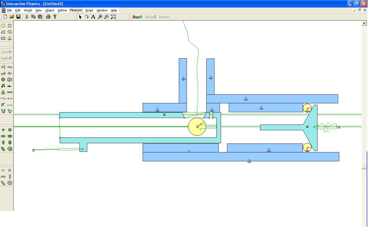

Antonio
Posts: 508
This is the animation of your drawing. I have already made it, but it seems that the fittings and pipe length, holes have to be very precisely made.
hotknife ralphie
Posts: 28
Joined: Thu May 04, 2006 5:53 am
Hey, I've been looking at the design for a while now and still can't work out how the trigger works. ie-When you pull the trigger what causes the barrel to slide backwards and hit the bolt letting the air out?
