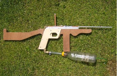

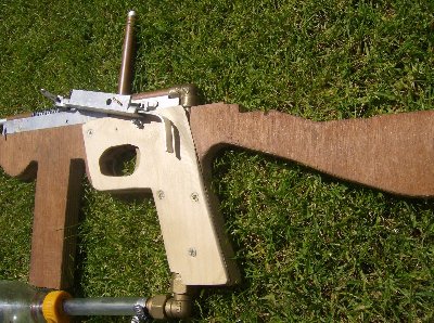

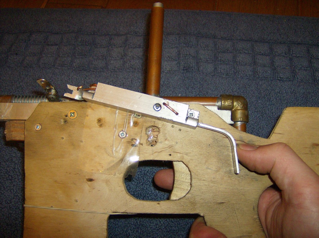

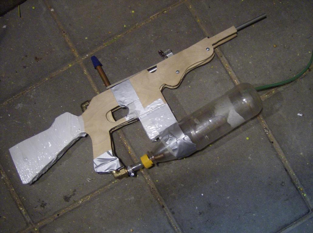

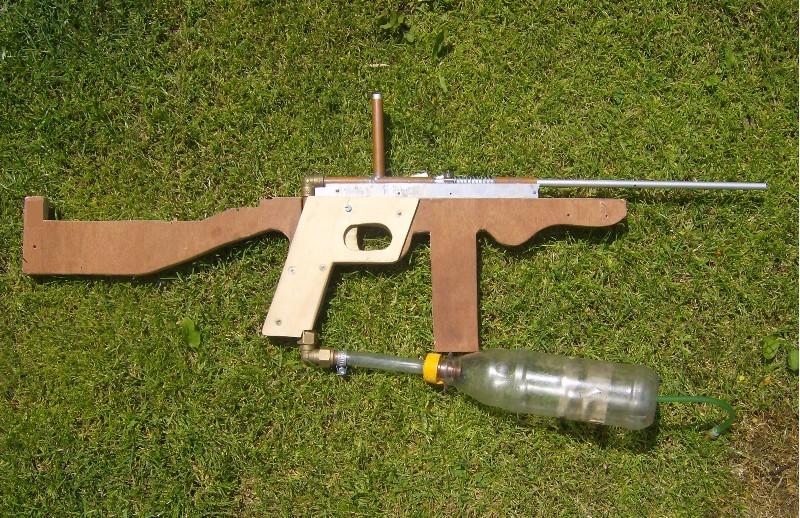

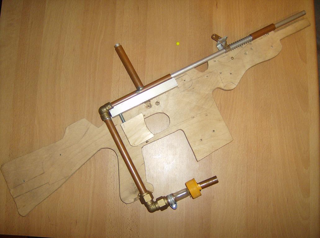

I made this new integrated body. Check for more at the pictures.
8 April 2008
New! now with thumb reload button. Check vid and pics

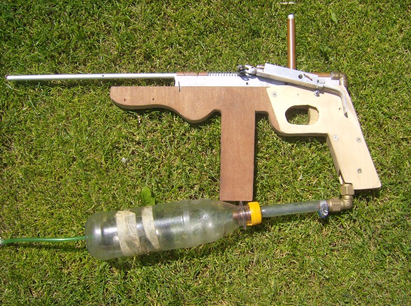

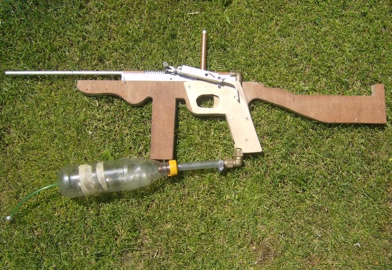

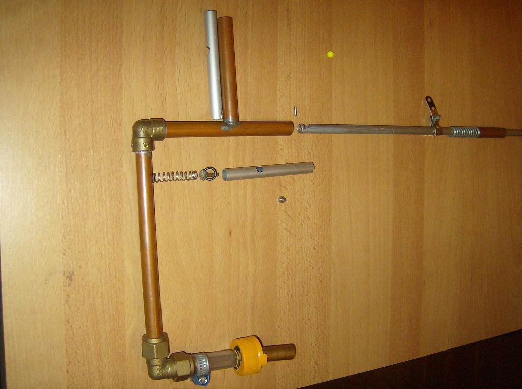

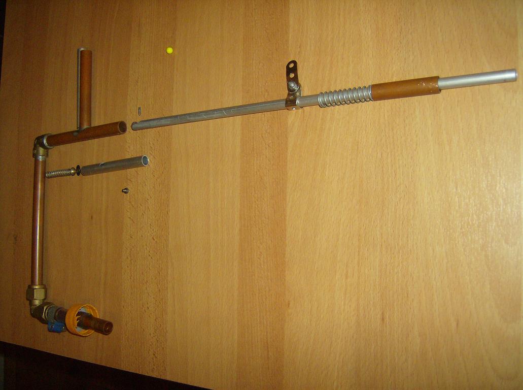

This homemade gun shoots 0.12gram bb balls at around 280miles/h. (450km/h) It works on a 1.5 liter coke bottle at 5bar operating pressure. It can shoot about 40 times on this bottle. It also has a gravity fed magazine. I also have a system to make sure that the balls dont roll out of the barrel and that there are no double feeds. At the moment I am working on a automatic airsoft gun which recocks on the pressure of the bottle as well; just like an uzi. So inother words this gun still needs to be recocked manually.
Plz respond to this gun as I am eager to hear from ya! If I get enough reactions I will post the plan to this airsoftgun.

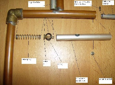

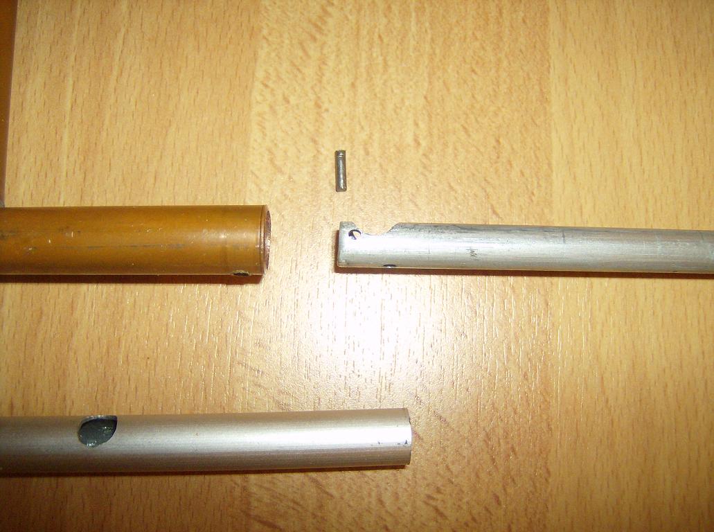

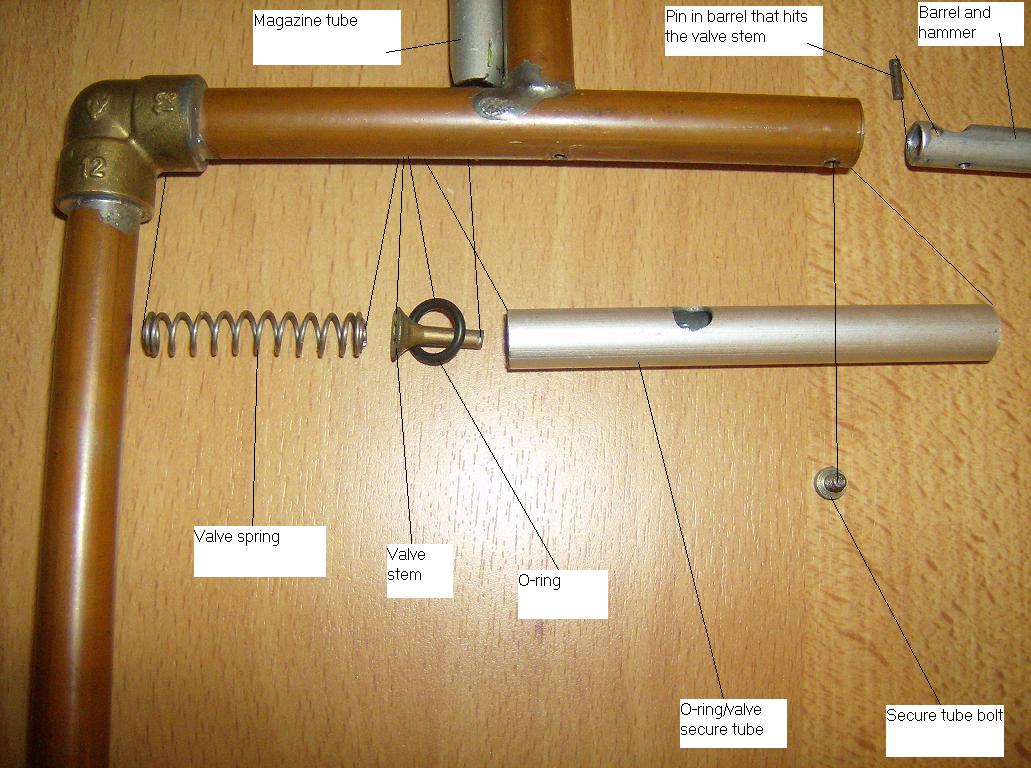

materails used on this gun:
*8mm aluminium pipe (6mm on the inside>barrel)
*10mm aluminium pipe (8mm on the inside)
*12mm copperpipe (10mm on the inside)
*screw with a head about 9 mm in diameter
*spring from a soappump (about 50mm long)>the stronger it is the smaller ur dwell time is
*solder equipment and solder
*10mm and 8mm drill
*90 degrees solder corners (2x)
*1-2mm thickness nail (2x)
*spring or elastic band to pull the barrel back
*for the trigger I would first try to use a simple trigger for testing purpuses
*o-ring (about 10.5-11 mm in diameter>too big for the copperpipe, so u have to really push it in like u c on my video

This is the airgun
This is the airgun

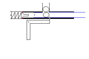

This is what the rar file animation looks like (but then animated). This is how the gun basically works. The valv is the same like the one I used for my old airgun
[img]http://www.spudfiles.com/forums/files/internals_158.jpg[/img]
(4.8 KiB) Downloaded 778 times
different angle
different angle

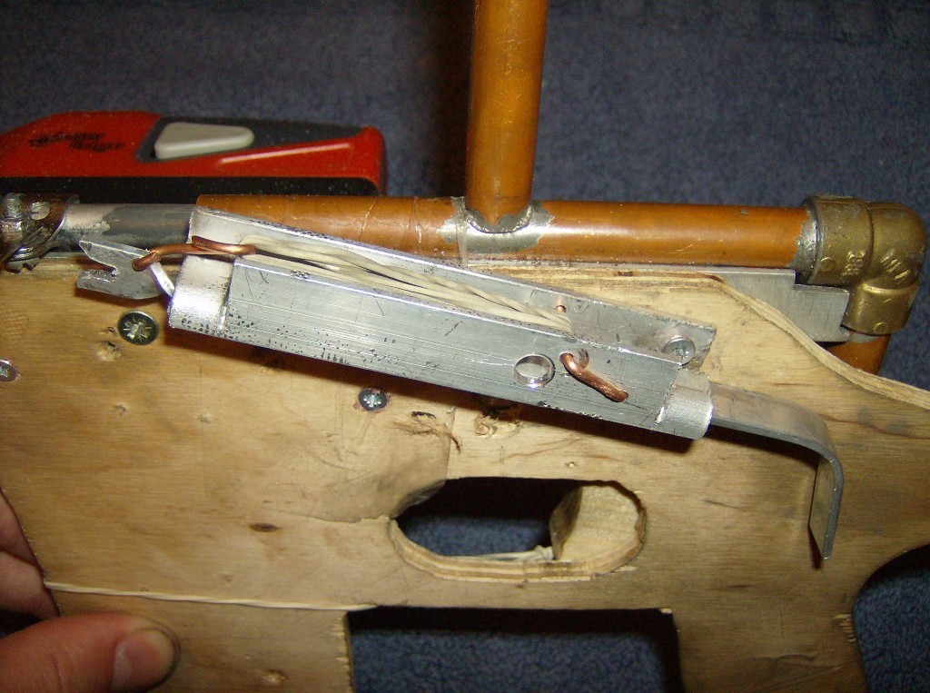

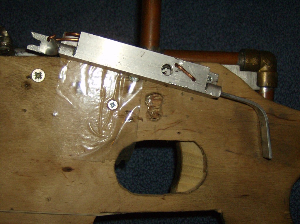

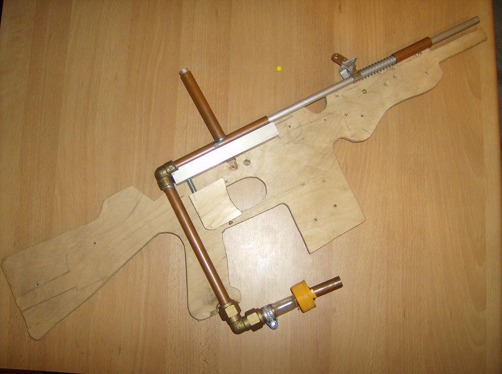

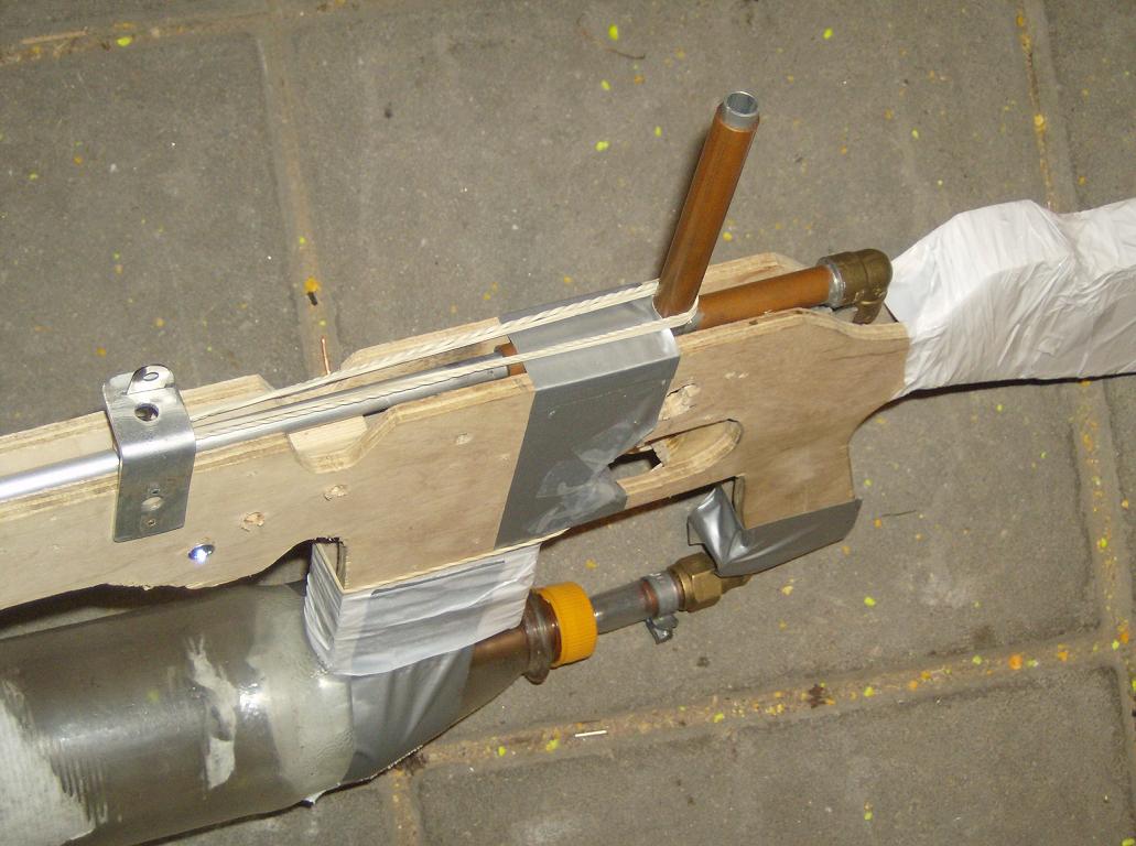

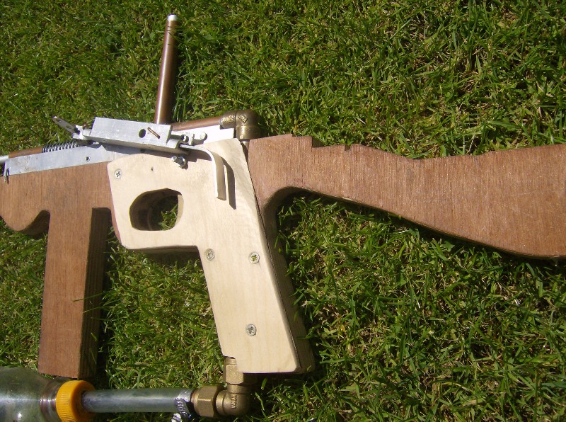

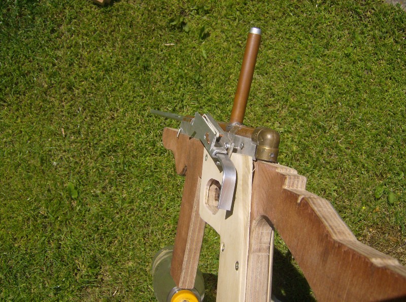

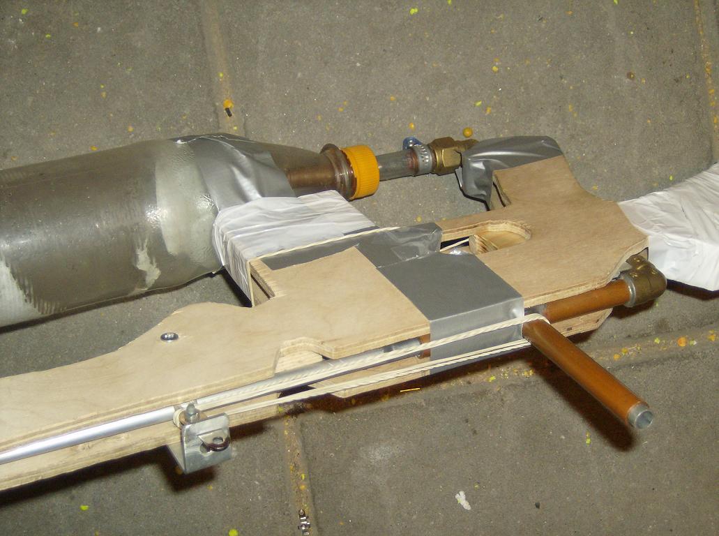

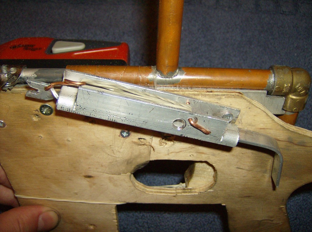

Side view. U can c the recock system here.

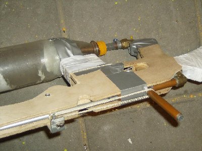

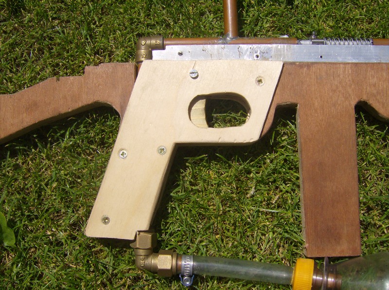

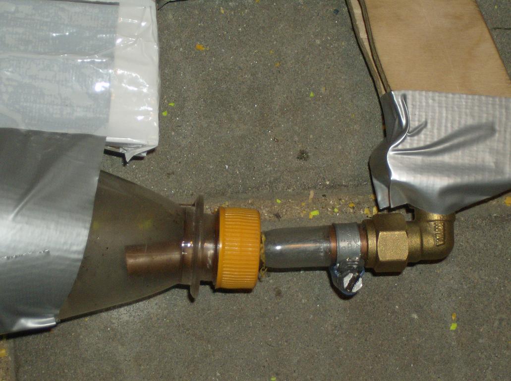

The air fittings to the coke bottle. I made a smaller hole in the cap then that of the tube. U push the tube in and then insert a bit bigger pip at the back of the cap. This fitting is self sealing as the higher the pressure the more force outwards>tighter fit.

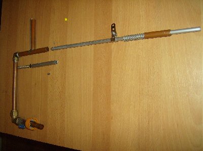

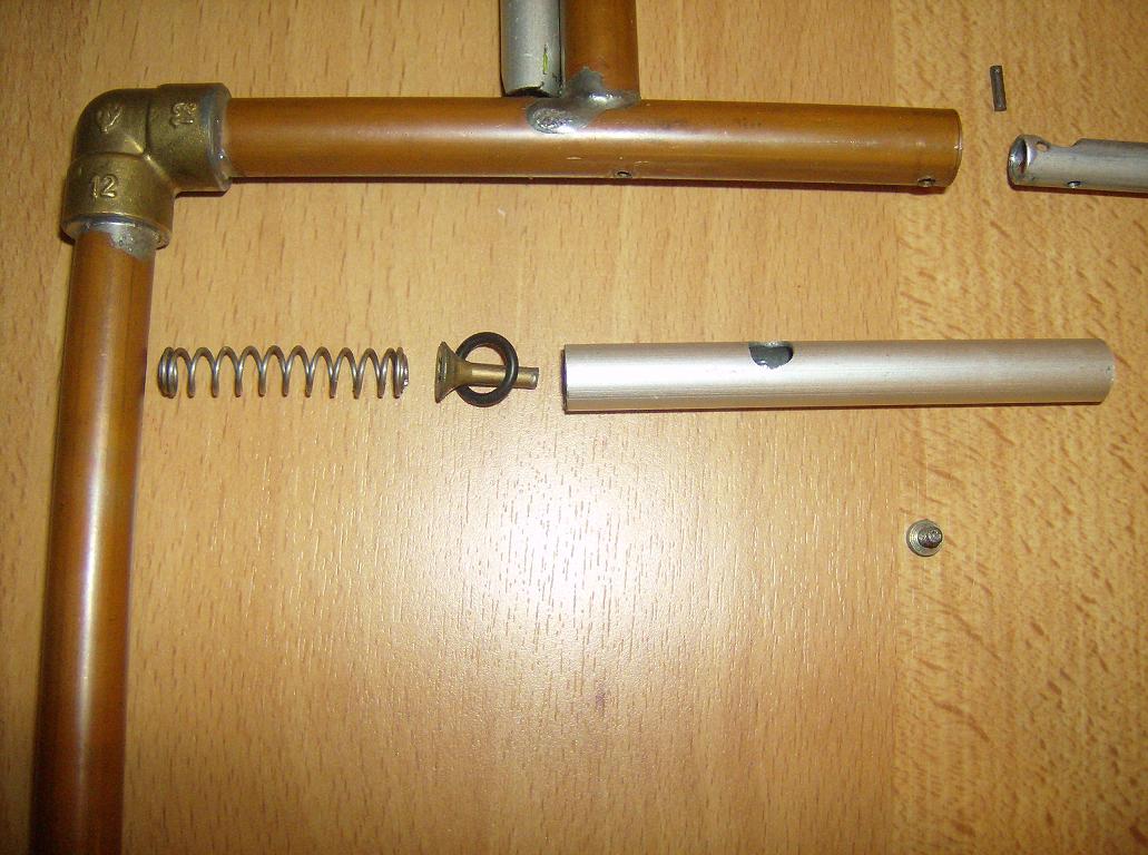

Discription of parts
How the airgun works.

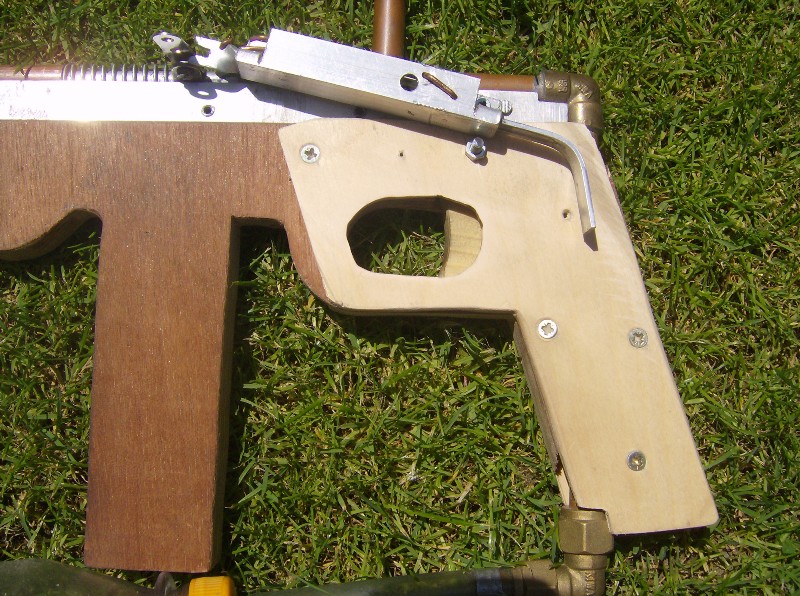

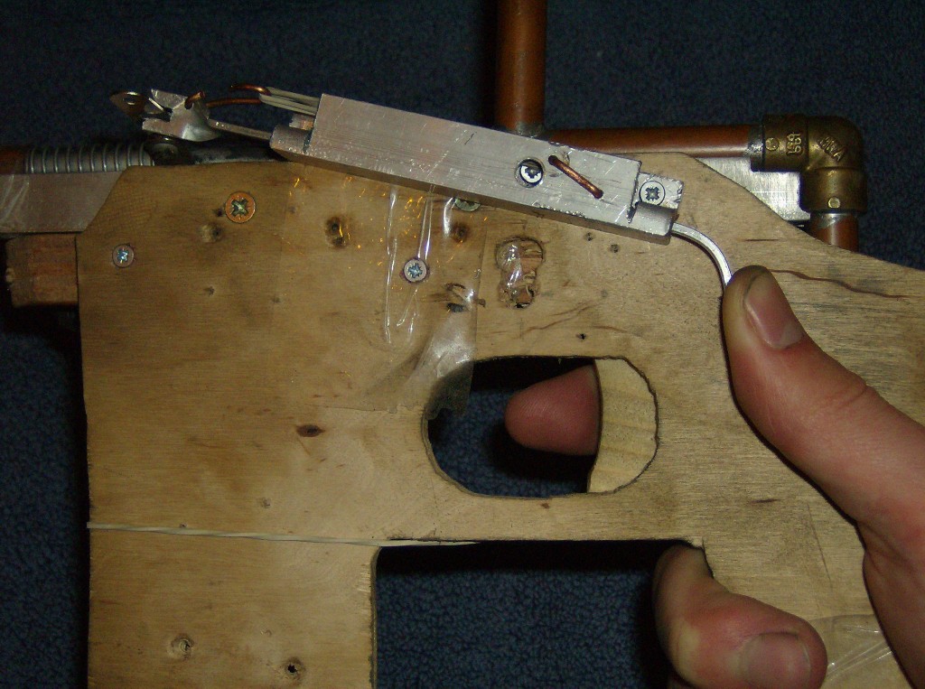

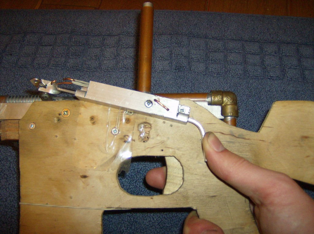

thumb reload>in back position
thumb reload>in forward/reload position
thumb reload>side angle view
thumb reload>side view
thumb reload>another shot
and right
and right
left
left
Aim and FIRE
Aim and FIRE

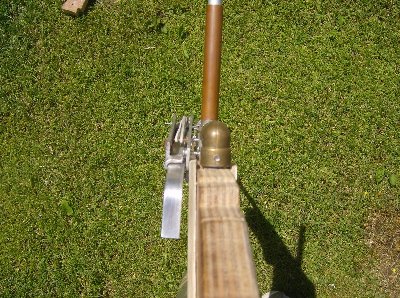

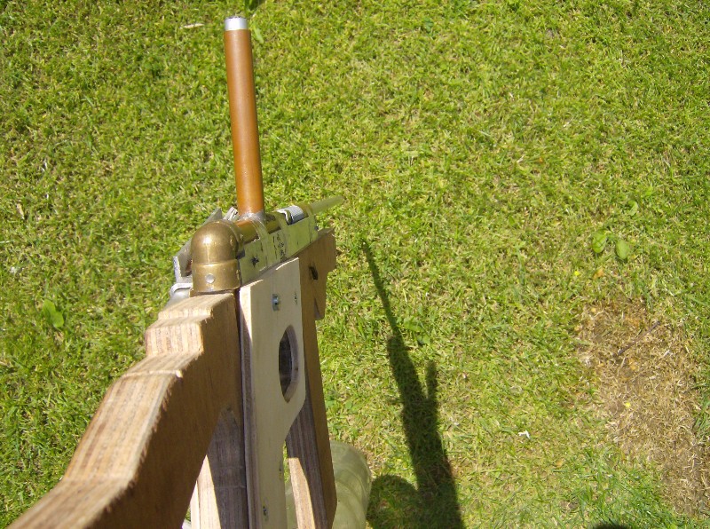

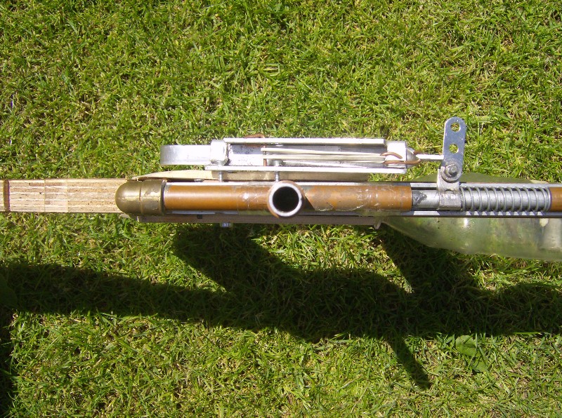

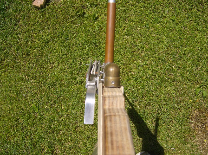

look from top (magazine)

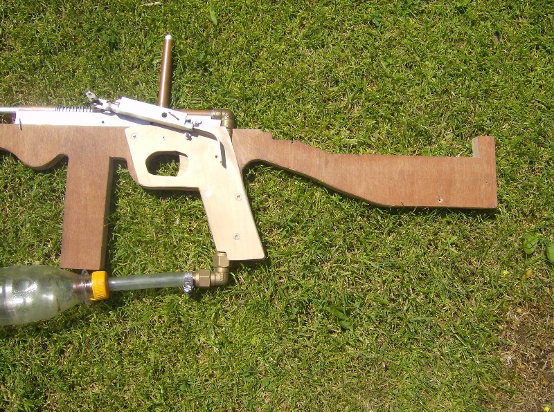

With stock
With stock
Closeup
Closeup
Without stock
Without stock

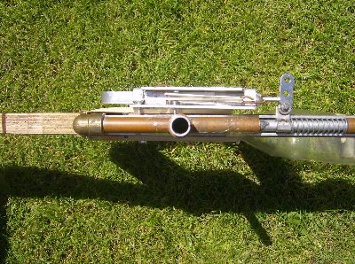

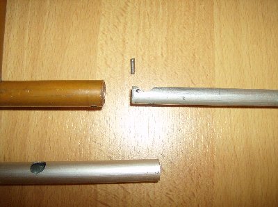

any details of the internals, are you using a blowgun as a main valve?
Tom
Posts: 187
What kind of valve do you use? I like the desgin alot. And is the gravity magzine just a pipe with bbs in the barrel or did you used a bolt?
GR.Tom
Hubb
Posts: 2390
Location: South Georgia
I'm responding.
A few cosmetic changes could do it justice (such as a paintjob), but it is a nice piece. Have you considered replacing the coke bottle and putting a lot more pressure into it?
Plans would be wonderful. It may have something in it that is completely innovative (which we tend to like).
Mr. Beaver
Posts: 66
Joined: Fri Nov 30, 2007 5:22 pm
Location: Israel
thats awsome also i want to know what do are you using as the main valve it looks cool and also powerfall also i wanted to know did u made yourself the body??? good job good luck with the full auto project :)
Antonio
Posts: 508
This type of gun is a barrel bolt type of gun. So the loading hole is open when it is cocked. When the trigger is pulled the loading hole closes bc the barrel moves backwards. When the barrel is totally backwards it hits the valve and gives some highpressure air. Like this the airgun is really efficient and shoots at high velocity. I will post a pic of the mechism later.
Hubb
Posts: 2390
So it's like a sleeve valve?

Looks are a bit too ghetto for my tastes, but it's clearly more sophisticated than that inside - I'd like to know more.

yeah I made the wooden body by myself. The design was taken from the internet from a rubberband shooting gun. Its like a sandwich from wood with the internals inside.

Plz check my other post for the internals of my stacked tube design bb gun. Internals of this one will come I promise.

im guessing that you were going for a AK-47 design? it sounds like you have a pretty sophisticated semi-auto shooting system and a nice paint job would be nice.
p.s. duct tape=ghetto
glue=nice!
