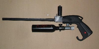

edit: here's progress so far, barrel is cast inside a section of (composite, of course :D) fishing rod. What's left is to construct the magazine and detent setup and encase it in epoxy, hooked up to the socket, and attach the nipple to the pressure washer valve to enable the barrel/magazine setup to be removable in case I want to build other calibres :)
Sorry to have hijacked your thread with a build log but once the discussion started it seemed appropriate to continue posting here.

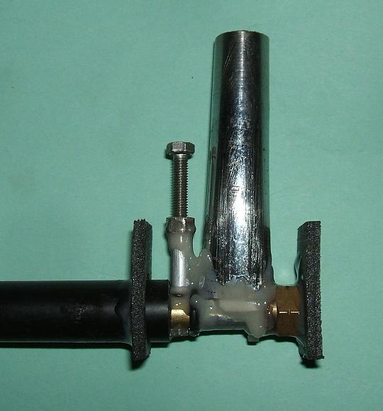

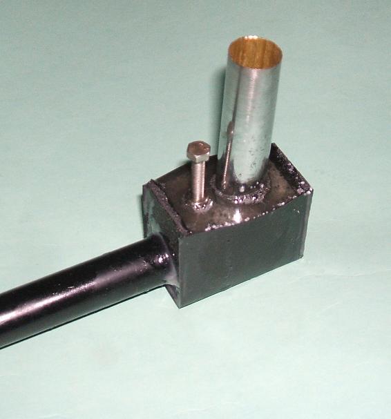

Here's the breech, before and after being unceremoniously entombed in an epoxy sarcophagus. I've gone for a simple vertical gravity fed magazine holding around 15 rounds, should be more than enough. Note the detent above the brass barrel mandrel, opposite which I've added a nut to make it more resistant to wear. I also squashed the magazine tube in a vice to give it a tapered shape towards the bottom which should make for reliable feeding. All it needs is another pouring of epoxy to reinforce and cap the magazine tube (which I deliberately factored in to give the breech more time to cure before I'm tempted to test it) and we'll see what it's capable of.
In many ways, it's a scaled up version of this project, which should obviously have much more power per shot (hence the relatively small magazine) and thanks to the blowgun being replaced by a pressure washer valve, I can use it to much higher pressures - unregged at 200 bar if I fancy :D

I always wondered what do you use to join and seal all the parts before pouring epoxy.. is it hot glue or cyanide glue ?
I already have the barrel so right now I am trying to build/mod the T... epoxy would help a lot but I hope I can get away with fittings and metal only...

I always wondered what do you use to join and seal all the parts before pouring epoxy.. is it hot glue or cyanide glue?
It's araldite, dries relative quickly and is strong so there won't be any weak pockets once the epoxy around it dries. Also, when epoxy cures it's a fairly exothermic reaction especially in greater quantities, I suspect that hot glue would begin to fall apart.

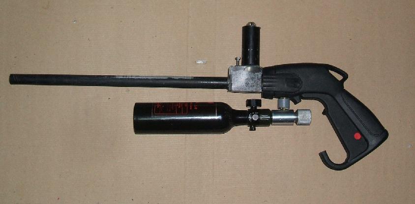

Here's some tentative testing versus the usual 0.5mm aluminium plate, hooked up to a blowgun at 100 psi. Clearly the magazine feed isn't as reliable as I would have hoped (There would have been blasphemy accompanying the vigorous shaking had the camera not been rolling :P) but the power's there, with the paintball tank I can take it to 450-850 psi so it should be even better. Who knows, perhaps it will also agitate the mag a bit and improve feeding.
I'll give it till tomorrow to make sure it's fully cured before taking it any higher though.

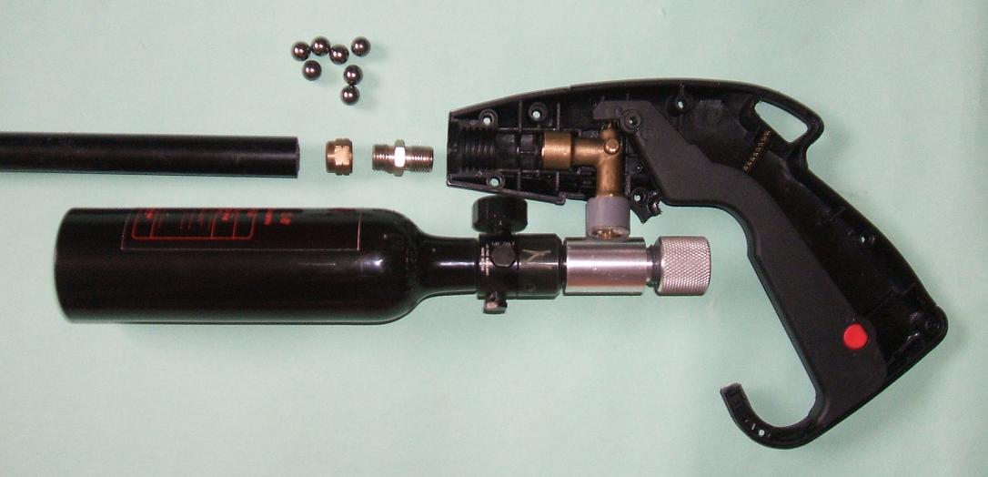

Here's the high pressure configuration:

Now onto serious prototype-related discussion:
Is the mag airtight? With my QEV+popoff I found that making a leak in the top of the mag allowed a small puff of air to ramble the BB's, improving feeding by a lot.
Not really possible because the idea is basicallythis one so it cannot leak otherwise the pressure won't build up enough to fire.
