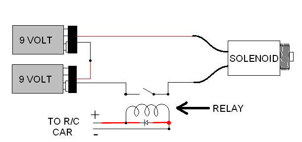

I was wondering about that as well. The usual solution is to put a diode in parralel across the coil to kill the back EMF you get when the coil is switched off. I don't think putting a cap there will do anything except make the relay work slower.dongfang wrote:Hi,
I like the idea, but:
- The back EMF from the relay (100s of volts) when cutting off power to it could destroy the diode, maybe making it conductive in both directions. A 100 nF or so capacitor in parallel with the relay coil will prevent that.
Regards
Soren
If it was me aI would just move the diode shown like this;
- rcdetonatorcircuit_mod.gif (18.33 KiB) Viewed 7991 times

I was wondering about that as well. The usual solution is to put a diode in parallel across the coil to kill the back EMF you get when the coil is switched off. I don't think putting a cap there will do anything except make the relay work slower.dongfang wrote:Hi,
Regards
Soren
If it was me, I would just move the diode as shown in the picture below.
Whether of not you need the diode depends on what the "R/C car" circuit is like. A simle battery plus switch wouldn't need the diode protection. Pretty much anything more complex than a battery+switch probably does need the diode protection. (Just 6V on the wrong pins of a generic transitor will fry it.)
