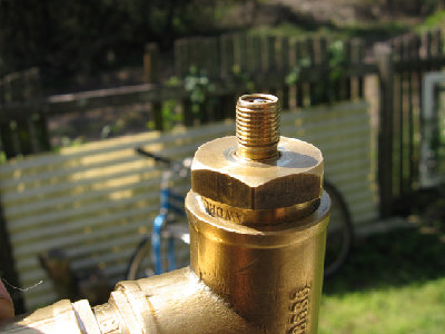

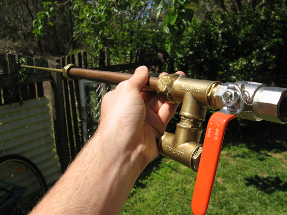

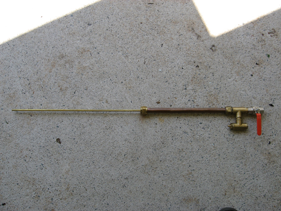

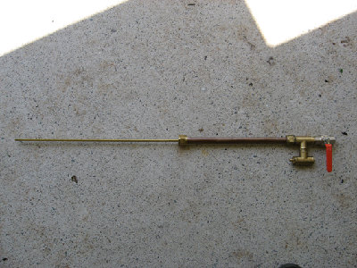

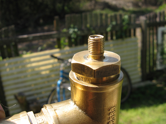

Gday guys,
After many months of dicking around, totally broke and just plain lazy, I've finally made my bb gun. This is only the first version of it.
I plan to:
take off that other end cap on the back of the bottom t, so I can place a stock.
Make the ball valve lever into a proper trigger aswell as putting on the piston grip at the end of the valve.
Mount a 300-400psi shock pump.
....and ofcourse, give it a good polish.
It's not the nicest looking gun on here but it's totally air tight, works absolutely perfectly (the first time I pumped it up, it worked like a dream) and it was pretty cheap to make.
I've only tested it at 140psi because the shock pump I bought sh!t itself but holy moly.........even at 140, it's like a bullwhip.
I really take my hat off to Jack on this one, Couldn't have got it working without his advice, not to mention of the other spudders on this site,
Cheers guys.

Jackssmirkingrevenge gave me the idea of sealing the barrel to the chamber. Wrap a real tight roll of masking tape around where the barrel goes into the chamber so it forms a nice tight fitting plug. He suggest glue around the plug to seal against the chamber but I thought I wouldn't have to because I'm using a compression fitting....and whatcha know, it worked perfectly. For the cost it cost to make and the how well it seals, ya just can't go wrong mate.
