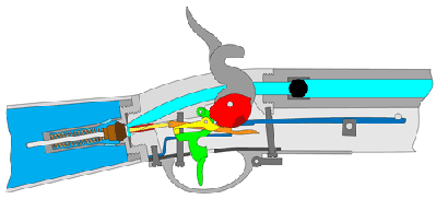

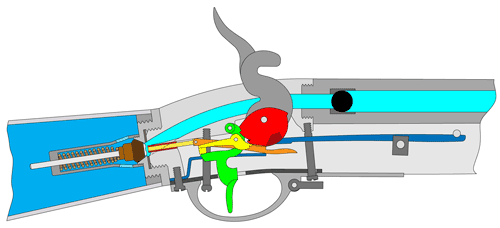

Ok, so this is the Girandoni mechanism:
What's imprtant to look at is the striker pin and the valve. There is a spring loaded hammer that moves the striker pin, which hits the valve, opening it briefly to let some air out to fire the projectile. The valve spring then closes the valve again and the cycle can be repeated. Here, I've made it into an animation so you can understand better (click on it to open in a new window for better quality):

Thanks I understand and I appreciate your time. Now what type of valve would I use on my rifle. I don't know where to get one like they have in the picture. Thanks Chuck
