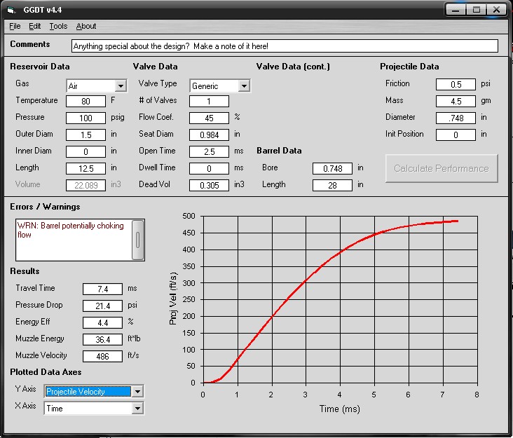

Im a noob to this thing and after alot of research Ive started building my own pneumatic.
My question is
How do I work out my FPS (thats frames per second right ?) for my pneumatic. I dont have a velocity currenty to calculate using equations im seeing online
Im building a
breech loading single shot pnuematic
caliber of 19mm
1.5x 12.5 inch air chamber
28 inch barrel
Any help would be greatly appriciated

Look in the Wiki for GGDT, it is designed for this kind of stuff among other things. All you gotta do is download it, put in your specs, and it spit out a pretty close estimate of what your velocity will be.

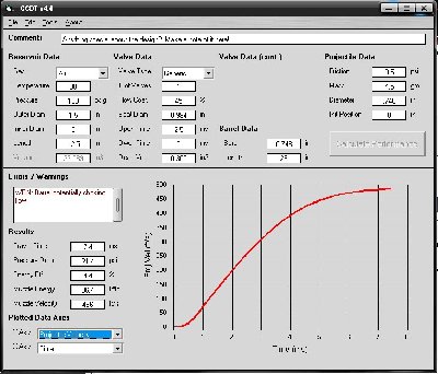

this is what i modeled your proposed gun to be given the data you supplied,
ammo: marbles (4.5g)
pressure: 100psi
Velocity: 486ft/s (Feet Per Second)

@chaos: You left the dwell time at 0. That normally needs to be kept high, 1000 or so.

chaos
Posts: 1205
Ragnarok wrote:@chaos: You left the dwell time at 0. That normally needs to be kept high, 1000 or so.
yer sorry i've never really modeled a gun with a sprinkler valve, not that it matters now.
