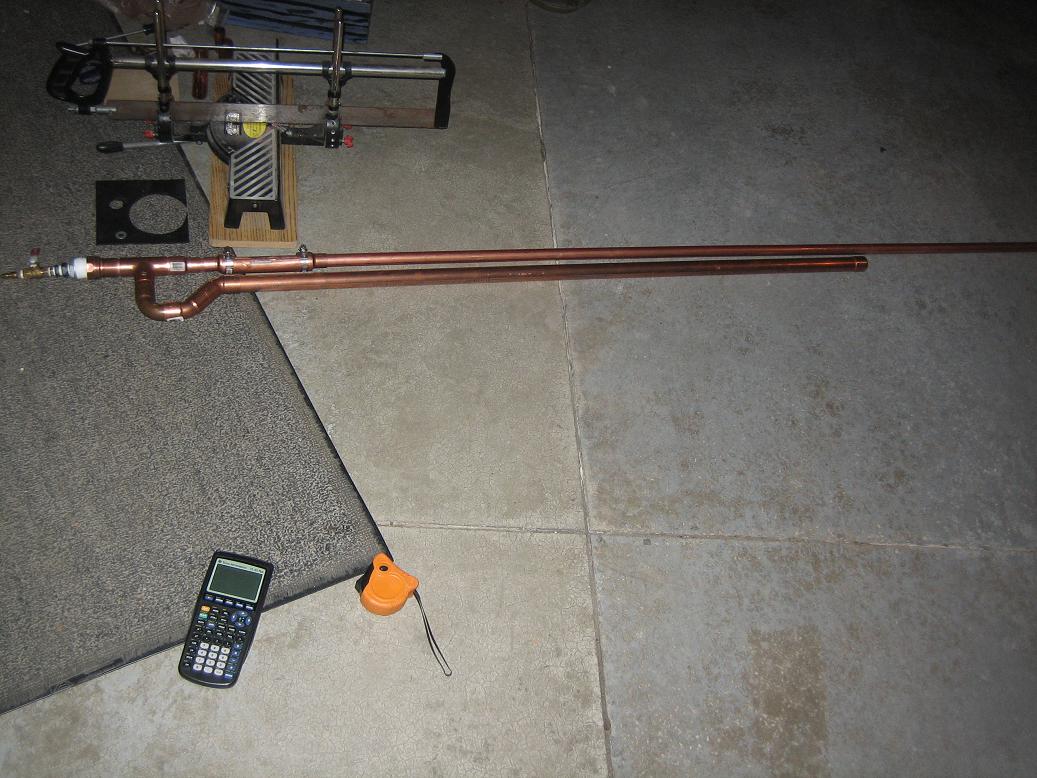

Well this is what i have been doing lately.
I think its pretty good for my first time with copper.
This gun isn't currently soldered so that needs to be taken care of (which i dont think it will be too hard for me)
Features/Specs:
4',1" copper chamber
6',.75" copper barrel
Bolt Action Breech Loading (just need the "Bolt" part)
Hot-Glue piston
When more funds come i am going to make it blowgun triggered with a 1/4 inch QEV.
Pump still needs to be made.
More pics to come tomorrow and I'll change the title.
In her semi-glory.
In her semi-glory.

Do you have any good games on that calculator? :lol:
Anyway, nice gun! Once it's soldered, you should definitely post some damage pics! :twisted:
Yeah, we wouldn't want to anger the bees, now would we??

Nice clean job! Good air quantity and relatively long barrel. It should be a good performer if you've got your piston right. Get us some pics of that setup. Also a close up of the breech loader would be nice... :wink:

Looks good!
Going to have some serious punch with a six foot barrel too!
Pump will be "high" pressure (300psi+) no doubt? :)

Yes of course, i wouldnt have made it copper then :)
I am going to make the pump based off your design, Gippeto, and ill most likely buy a check valve.
Does Home Depot sell check valves?
How much are they?
How much pressure can you use the with?

I still need to put that foam on the chamber so that it doesnt make my hands dirty, and i need to put a spacer in between as well as hose clamps to hold it down.

looking good man. Have you used hot glue for the piston before? Does it work well?
SpudUke5
Posts: 1099
trollhameran wrote:looking good man. Have you used hot glue for the piston before? Does it work well?
Yes it works ok, just make sure it has enough lubrication because the piston tends to have more friction with its seat.

That gun will dish out a serious punch to whatever is in front of it!
Good job! :D
