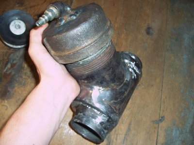

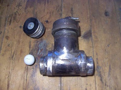

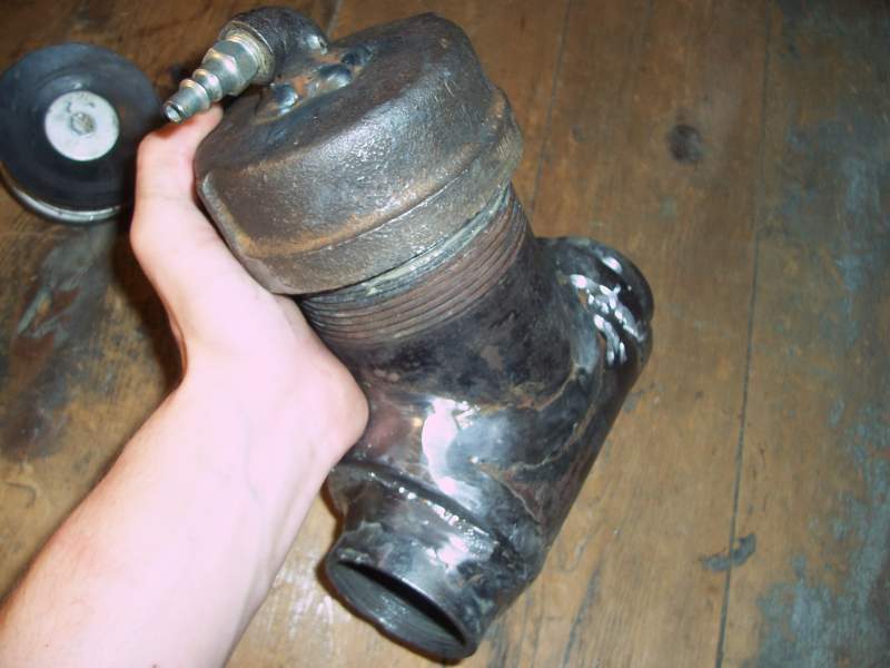

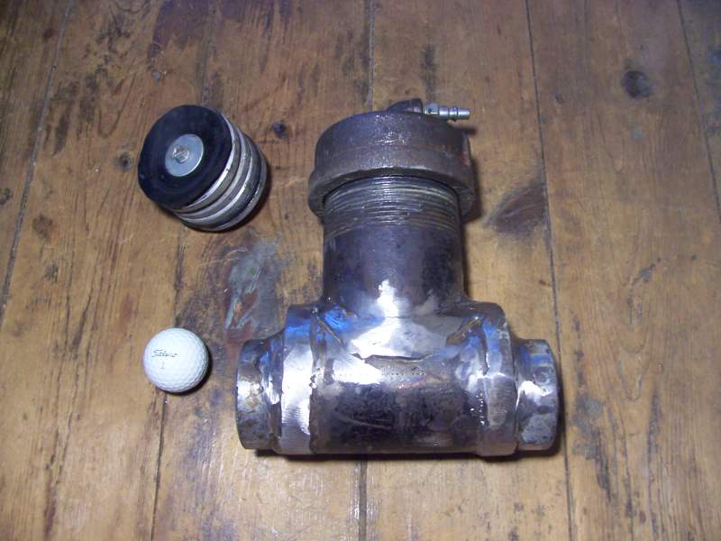

Seeing as I haven't posted anything interesting in a while, I guess I'll slip a little.
This is a 2" porting, steel inline piston valve I made in my spare time at my new job. It still needs some grinding and a finished piston, but it seems to be functioning very well even though the piston isn't even sealed/epoxied yet.
I may coat the outside in bondo and sand it down to make a nice smooth surface. I don't like the uneven look of freshly ground welds.
Feel free to spam/speculate away!

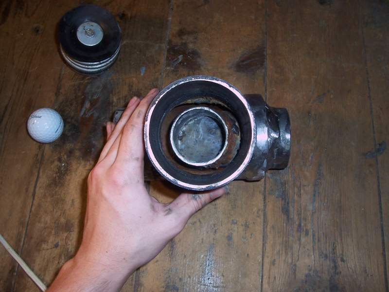

The piston uses a floating oring, meaning it will seal perfectly when the pressure in the back is lower than the front, but not the other way around.
Seat hasn't been smoothed yet, but it seals fine the way it is.

Damn, thats amazing. What mix do you plan on using? Can't wait to see this thing in action. I look forward to see the bondo finish.

i like it, what are you planning on using it for?

So it's similar to a sprinkler valve in operation (with the ports switched around to be "barrel sealing")?
My next big project obviously, which being in the hybrid section would make it my next big hybrid project :)
To my knowledge, yes. I thought most sprinklers were barrel sealers though (?). I've never seen one in person, actually.
