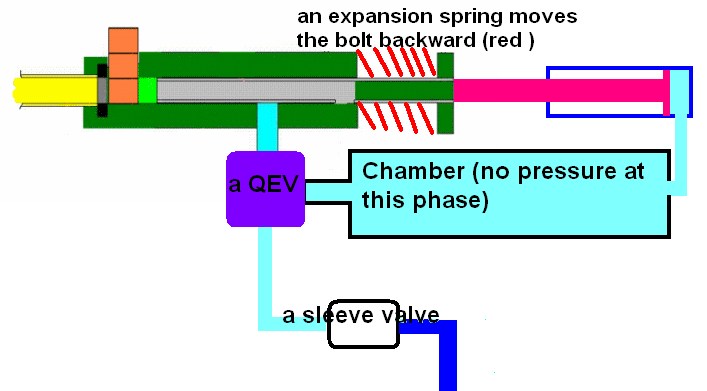

this might be simpler (it's just a suggestion, i've never tested it but it would surely work.... --->

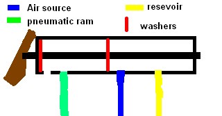

(BTB you could use a 5/2 way valve insted of a 3/2 valve... it would vent that small piston when the valve is in is in 'rest'/off position)

ohh sorry I meant a 4/2 valve......
:D
)DEMON(
Sergeant 4
Sergeant 4
Posts: 1391
That would work fine, I am sure that could be easily done. Remember, you don't want a valve like that to be bias so you need a washer on the end to seal it (achieving equilibrium), or else it would be difficult to push.
Forever dreaming...
yes it's a fair point... one washer more and it's ideal.... you never stop learning :D

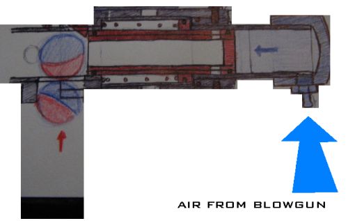

I don't see how it could be more complex and less compact than this:
