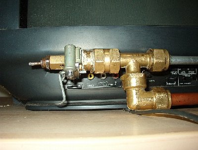

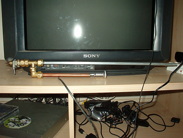

G'day all, this is my new pump up bb gun. I don't have a gauge but I don't really need one. The pump has a schrader valve as the check valve. It's totally air tight and it would take a serious amount of pressure to blow it out. I usually only pump the gun 15-20 times for a seriously powerful shot.

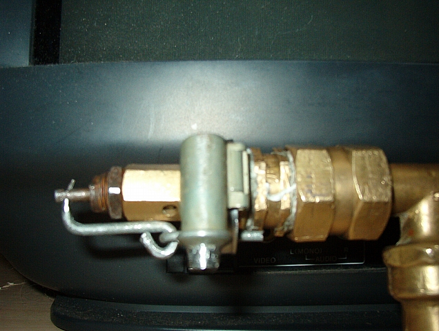

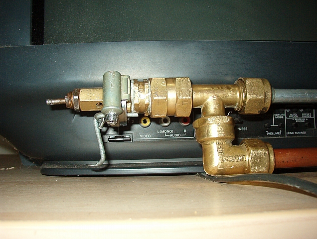

I came up with this trigger mechanism. I was sick of the slow flow that the ball valve trigger had, so I'm using a modded pop-off pressure relief valve as the pilot. I removed the spring and attatched a sear. The gun is only half done but the idea worked perfectly. I still plan to add a grip and a trigger. This is the fastest pilot release I've ever came up with, it's insane. It's improved the performance 10 fold. I've pumped up this gun as high as I possibly could and It was totally leak proof so I reckon it's good for up to 450-500psi.

Thats cool.. I don't know if you seen my trigger system on my gun but I think you should rig up a finger pull and a handle of some kind..Just so it has the feel of a real rifle. Also a stock..I think that would make your gun look kick a$$!. Could you leave the spring in or is the pop off to low of pressure..if so I think you can buy high pressure pop off or adjustable ones.

can you explain in more detail how the trigger works? It sounds like it works really well.
Cheers alot guys. I had to mod the pop off valve because after 10 pumps, the valve would start to open and wouldn't let me go any higher. I took the spring out of the pop off valve, and the sear holds the pop off valve closed at any pressure. as soon as you drop that pin out, it instantly releases the pop off valve and dumps the pilot faster then you can say BB

Barrel size is 8mm?

Yes mate, it sure is. Ever since I saw the vid of your metal co-ax, I never really thought how much difference you get with releasing your pilot quickly. I mean....yours sounds like a bomb going off at 120psi!
